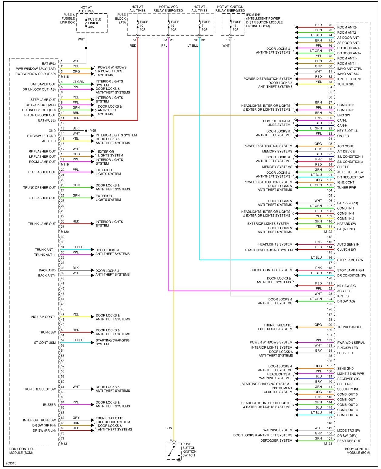

After looking at those codes, it looks like the BCM is trying to tell the IPDM to turn on the ECM. Since you've unplugged the ECM and connected the battery, the BCM probably went in to security lock out mode (nissan special security) and will need to be reprogrammed to get it back on the same can network. The Start button is basically a ground switch for the BCM to turn the ignition on so i would confirm power to the BCM first, then grounds and if those are good, then get another BCM.
2007 G35 BCM
2007 G35 BCM

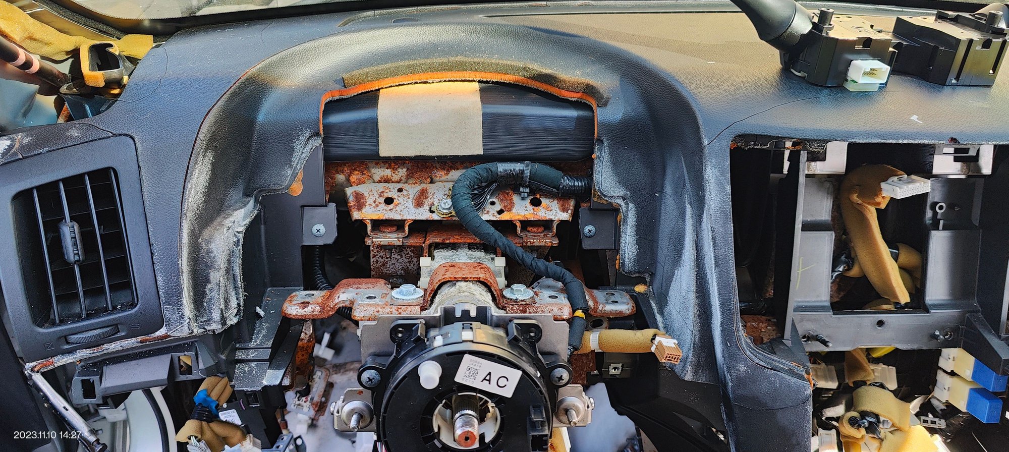

Cluster has no effect on security or ignition. I tried that with mine and i also had a dead LCD but was able to find one on eBay and just plug and play.
Key fob battery must be good and the key slot must be good as well since the BCM starts there. Put a new battery in one of them, stick it inside the slot (making sure it's all the way inside and locks) and press the Start button. Ignition should turn on with red key on the dash. That's how mine was after i unplugged the ECM with battery plugged it. If it don't, then check for power to the BCM and check the Start button if it grounds the Brown wire. Check the fuse links, check around the IPDM if rats or chipmunks didn't chew on wires..
As for the 'beeping' of the cluster, just ignore it as mine beeps whenever it feels like it so it's actually nice when it's not beeping. Check the plugs to the cluster but most likely, you'll need a used one.
Everything rusty behind the dash from the 10
Everything rusty behind the dash from the 10" of standing water inside the car from plugged up sunroof drains. The white stuff on the dash, that's yummy mold!
