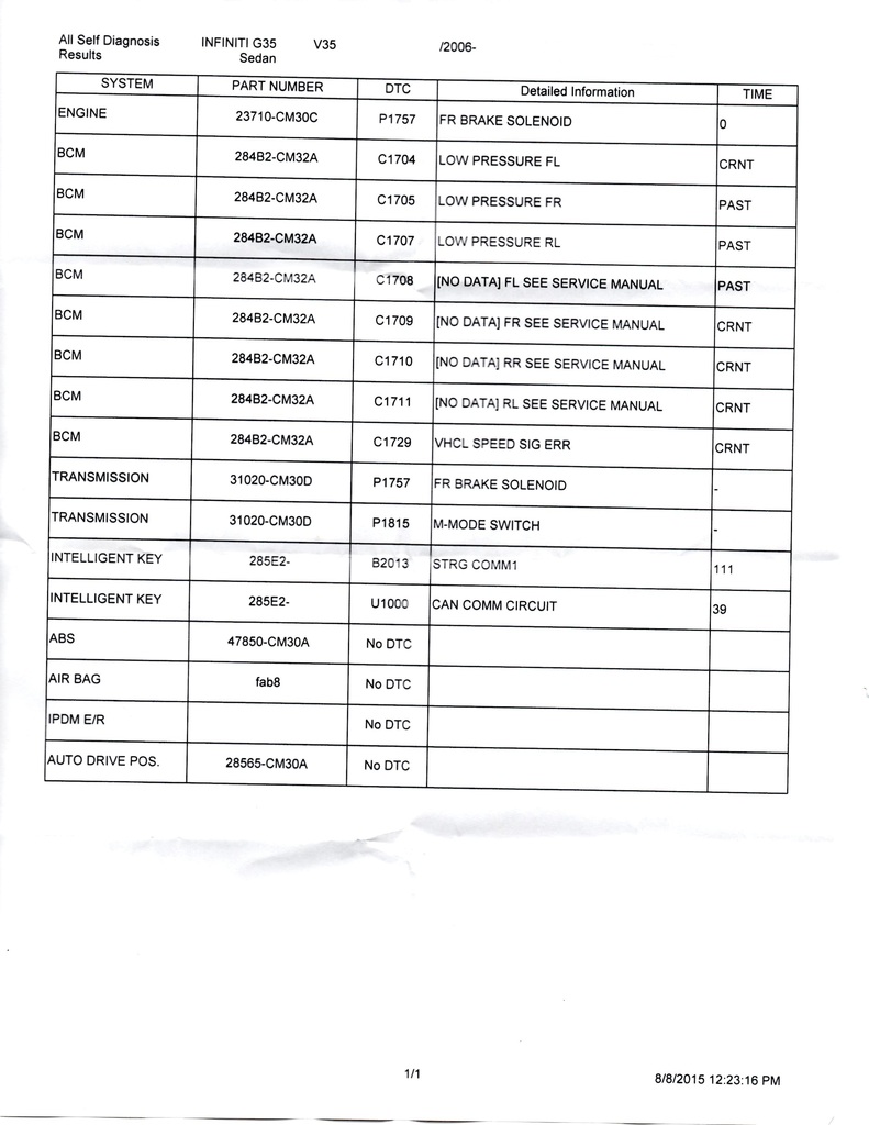

engine light came on
Took my car in for an oil change and not even a mile after leaving the delaer (Infiniti) my light came on and my car started driving funny. Felt like it was stuck in a gear like 3rd or 4th. I have an 06 infiniti g35 sedan and the manual mode wasn't working either. So I took it back and they're not even sure about some of the codes its throwing off. plz help Have no idea what to do next. This is the sheet they gave me with the code errors.
