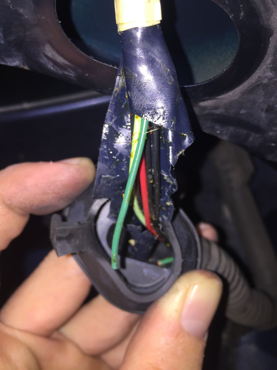

yes, you have some broken wires in your trunk lid. you need to manually pop the trunk. pull back the grommet and re solder the wires. takes about 30 min.
this is a very common issue and there is tons of info on the subject.

Thanks for link, was able to finally get this fixed as well! One wire was sheared straight through! Made a small jumper cable, soldered it on and heat shrinked it, has been working the past week just fine
