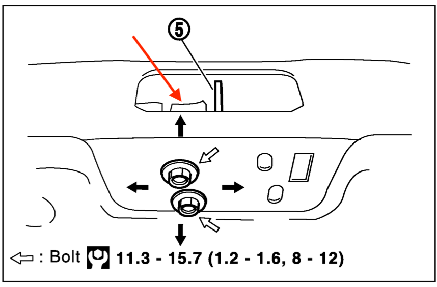

Just looked at my sedan trunk and realized there is a spring loaded rubber bumper right next to the trunk lid "striker" on the body side of the latch. This spring is what is supposed to "pop" your trunk when the latch operates. If that is not working on your car the lid won't move unless you are physically pulling up on it while you operate the latch. Please try that - pull up on the lid while operating the latch.
Drawing below is from your FSM, red arrow points to the part I'm talking about.

I was able to pop the trunk from inside by moving the latch with a pick and drove to my mechanic. He said that spring is just to show you the trunk is open. It's working fine. Came to the conclusion that something probably broke inside the actuator not allowing the latch to open fully. The actuator works fine with the trunk open, but doesn't move enough with the trunk closed. Probably going to look a little closer before ordering a new actuator. Said it's actually pretty common with the cheap plastics inside.
