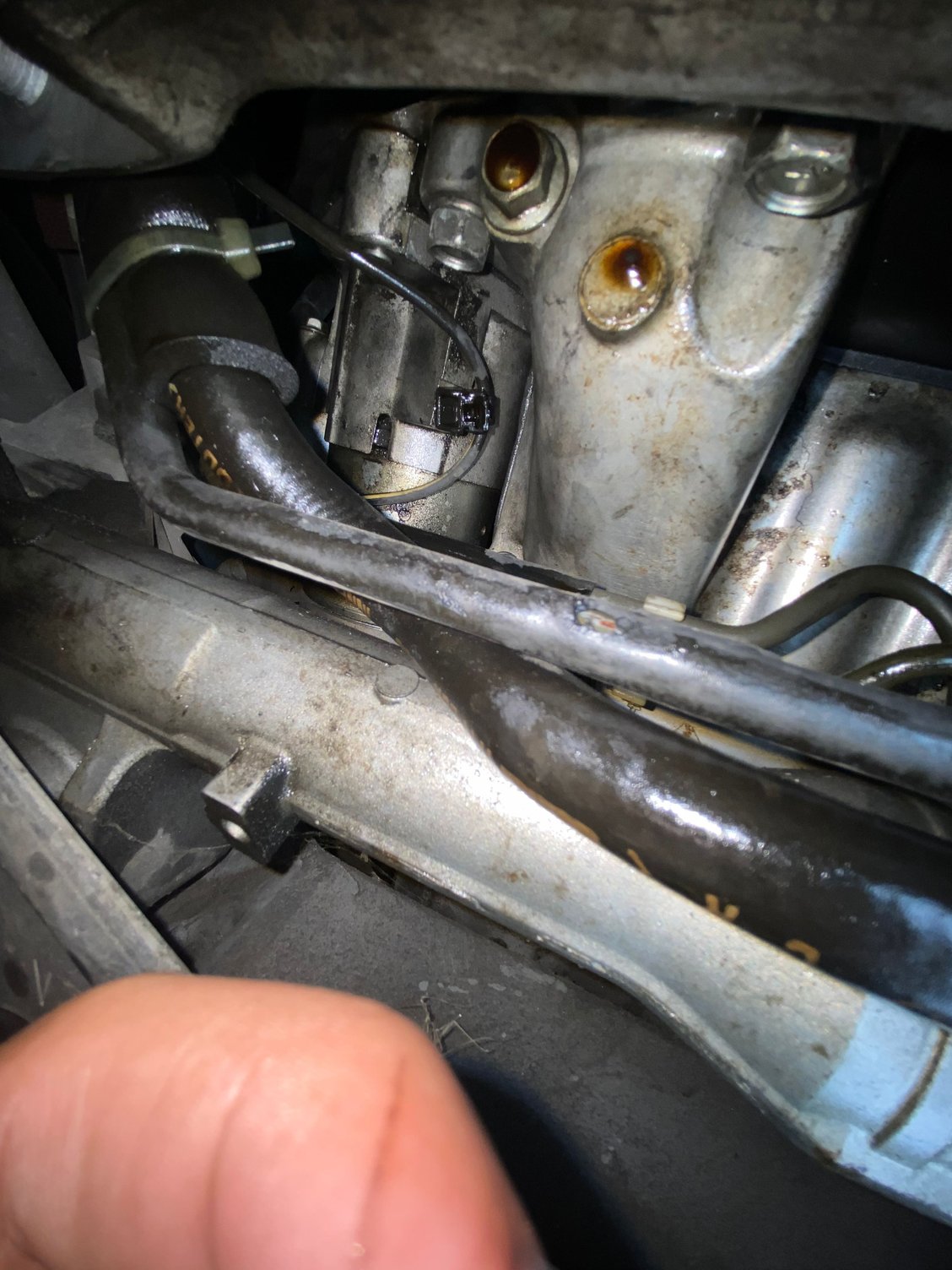

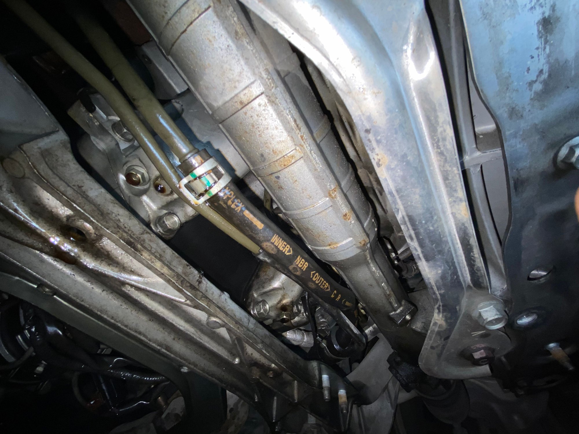

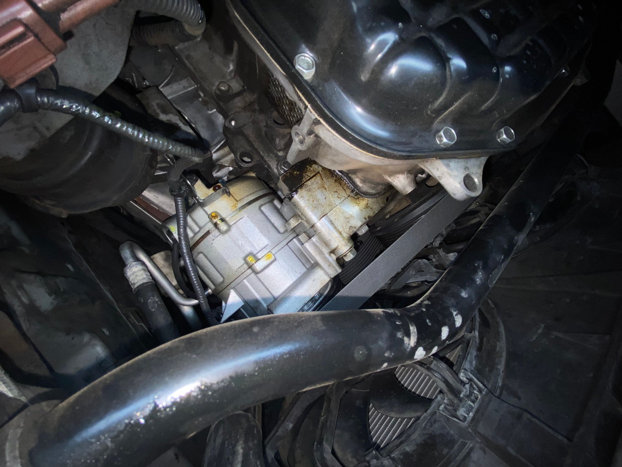

So I bought a 07 g35 sedan 6mt and ever since I’ve bought this damn car I’ve had nothing but problems first the ac compresser went out then the car had this weird uncomfortable shake to it my father said probably needs a clutch so he said you can drive it for a few hundred more miles the next day I was just cruising and the whole car was smoking there was a whole puddle of oil underneath the car I shut off the car and got it towed back home just to find out there oil everywhere underneath the car on the tranny the catalytic converter everything and I can’t locate this leak I will upload a few pics.

Just start the car and look for the oil leak with an inspection mirror and a flashlight. With that much oil it should be obvious, don't let the crankcase run dry.

I'm not trying to be an ******* about it but you need to TROUBLESHOOT THE PROBLEM. There's a lot of reasons a car can be dumping a lot of oil.
You could have a hole in the oil filter
You could have a hole in the oil pan
You could have blown a big chunk out of a valve cover gasket
You could have thrown a rod and have literally a hole in the side of the engine
You could have a loose drain plug
You might have a bad RMS?
Get an inspection mirror and a flashlight and look to see EXACTLY where the oil is leaking from. Don't just automatically assume that it could be something, especially not something as labor intensive as a RMS, troubleshoot that ****!
