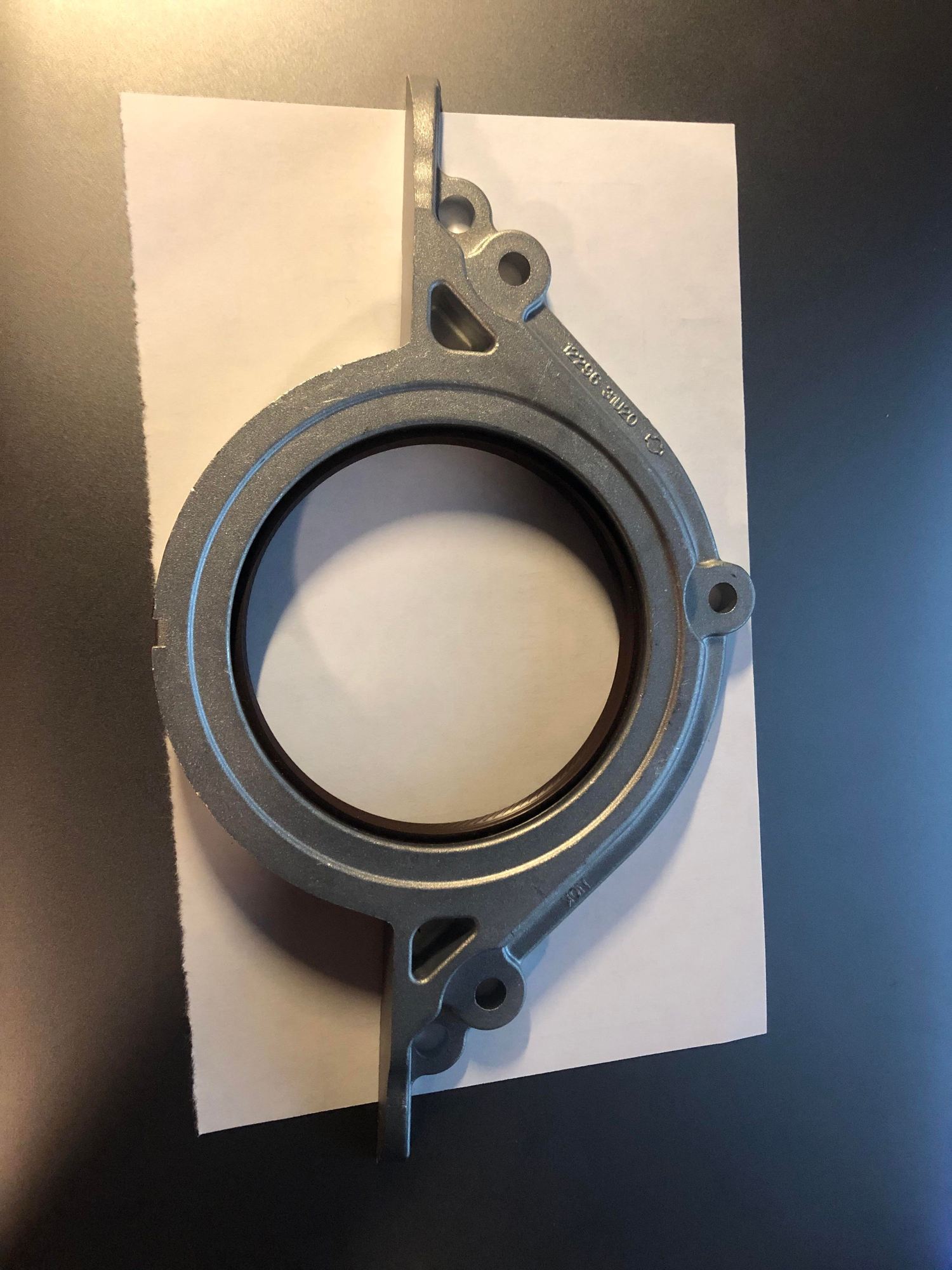

Here's where I get confused. My Chilton manual says to just pop out the rear crank seal with a screwdriver and put the new one in. However, the replacement I ordered from Z1 is the entire RMS with the crank seal built into the housing. So what I'm wondering is do you know a way to replace just the crank seal like my service manual says? If not, how do you replace the entire housing without rolling the upper oil pan seal as you slide the housing over the crank? Picture of my replacement for reference. ↓↓↓

The pan seal slides over that little groove on the bottom edge of the RMS, it slides on without too much hassle but yes you have to watch the rubber to make sure it is actually seating properly. I set the bottom part in first, then get it all started around the crank, then push the bottom in a little more then drive it all on flat.
The reason you can't do like the Haynes/Chilton explains is obvious when you look at that picture of your RMS, the seal is installed from the BACKSIDE of the housing, you cannot just pull it off and leave the housing in place like you can on a Toyota or most other vehicles. Either way the RMS housing has to be removed.
Yes you can pull the actual ring seal out of the housing once it's removed from the vehicle. It's fairly difficult though it's a very tight fit.
