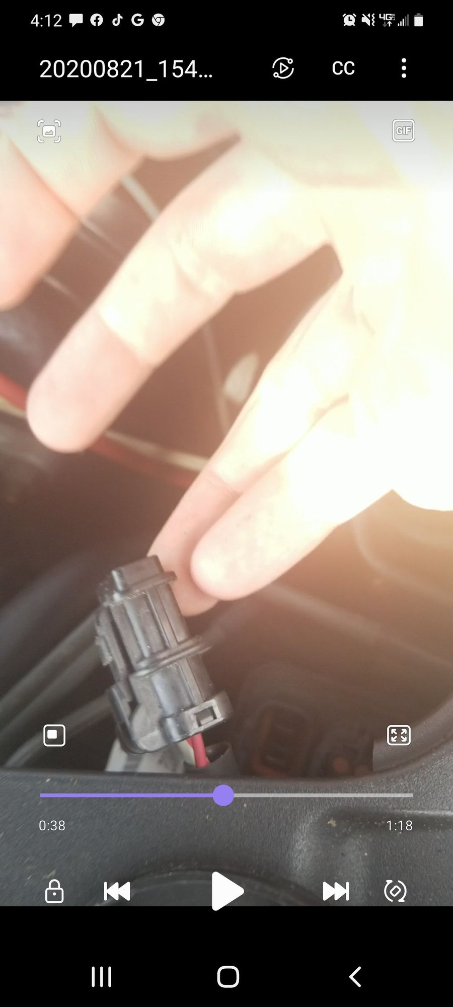

I just feel like their feeding me with bs. Cause I also found a plug they had unplugged maybe ecu by the brake master cyl under the left engine bay cover..I plugged it in and my indicators briefly worked correctly but then went back to staying on. I feel like they shorted something.

However left engine bay by the brake master cylinder is the ABS components, I have no clue why they would be screwing around with that stuff. Take a picture and post it, sounds like they unplugged the ABS relay, they may have f'd with things and were causing it to trigger the ABS so they just unplugged the relay.

I'll attach a photo of a video I took while I was at their shop. They still have my car.

Video didn't upload properly, post it to youtube then put the link here and it will automatically embed the video.
However I can tell by that picture that YES they did unplug the power-side harness off the VDC relay, I can see it in the background of your photo. The harness you're holding is the side of the relay where power basically comes in.
For whatever reason they disconnected it, troubleshoot the system separately from the engine controls stuff it's a 100% standalone system BUT it does send some CANBUS info back to the ECM so the ECM can limit throttle when your tires are spinning or the vehicle VDC system kicks in if you're sliding the car.
With that relay disconnected your ABS brakes will not operate, neither will the VDC (traction control and vehicle stability).
There is no reason to disconnect that stuff with a piggyback computer, this further reinforces my theory that this latest shop was trying to use that ECU as a standalone for some reason. If they were concerned about VDC limiting throttle then they should have just put in a VDC kill switch so you could kill power to the VDC/TSC/ABS control unit (requires the vehicle to be restarted after turning the system back on) rather than permanently disabling everything.

Well I didn't post the video. I just screen shotted it but I can upload them later. I Mean I wouldn't doubt it I have been thru a lot with this shop. See I told them they messed up my guages and I told them I wasn't picking up the car until a lot of issues were fixed including that so I'm assuming that's why they unplugged it hoping to bypass any work they would have to do to make everything right. The guy straight up told me on recording that he pushed my car off to the side for over 3 months because it wasn't making him anymore money (I paid him in full $5500) so he moved on to other things. So I contacted BBB and a TN Department. Also had to do a surprise drop in cause he was ignoring me.
