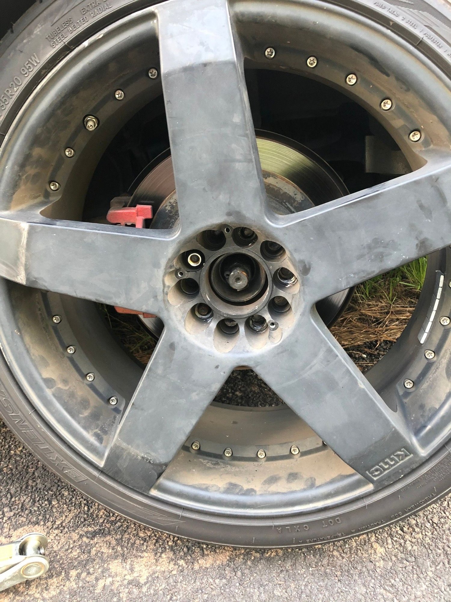

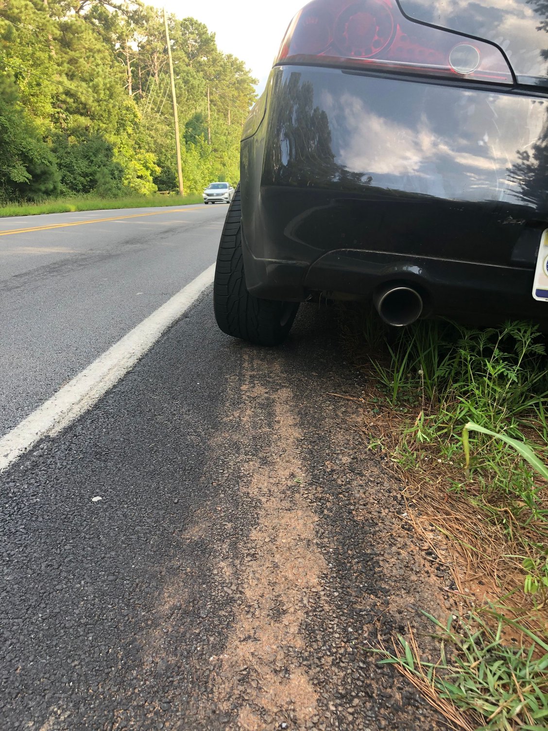

To start, about three years ago I took my car in to firestone to have a routine oil change and to balance the tires. After this I immediately took about a 200 mile trip and left my car for a week while on vacation. Upon return I was driving back to my parents house when my rear driver side wheel snapped off the lugs (picture 1 and 2). Because of this I had to replace that rim, one more rim that had some scratches on it, and three of the four tires due to wear. The initial cause of the snap I associated with firestone not properly installing the rims on the car because I think they rotated the tires even though I did not ask them to do this. Because my G35 is a coupe the tire sizes are different front and rear which many of you know and I am sure this put additional stress on the rim until it snapped the lug and left me stranded (I could not get proof that firestone did this). After having the rims replaced I immediately noticed a shake in the car that becomes downright obnoxious above 75mph. After a few years of driving on it you can notice the shake at almost any speed but it feels more like a wobble at the lower speeds and becomes aggressive at 70mph. I have had the car in a few shops around Huntsville since then and asked mechanics to look into the problem and see if they had a fix. Eventually one mechanic convinced me to replace the following parts with the impression that it would fix the shake (if any of these are confusing I can try to explain better:
