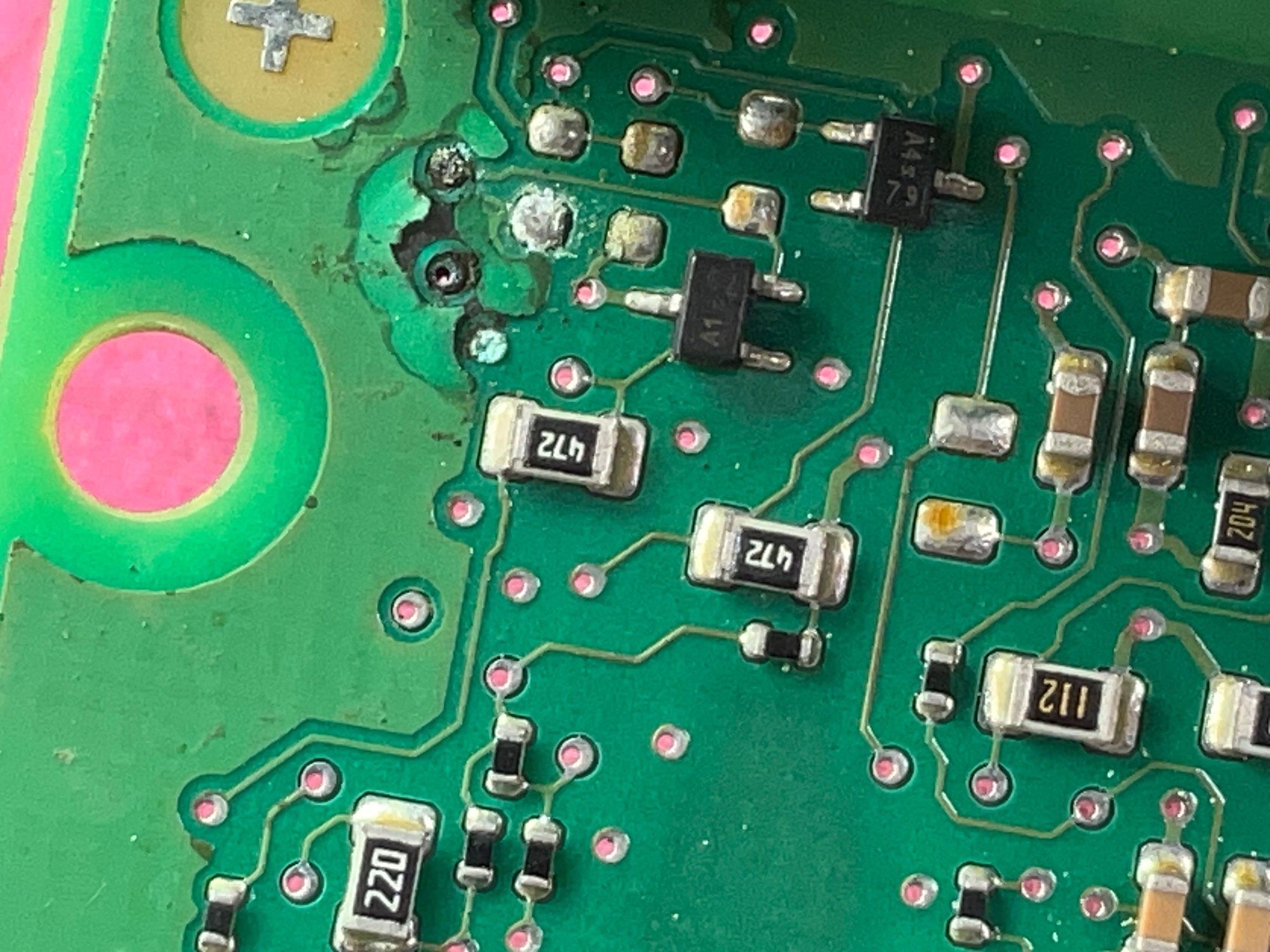

Hey hope to find everyone doing well, I’m having an issue with my 08 g35 sedan where none of the gauges work car runs and drives good ac doesn’t work neither does manual mode no sunroof I’ve done everything I could think of checked wires and everything checks out to be good but I’m getting a u1000 code and the odo not working I asked the previous owner if he had this issue he said yes that he replaced the old cluster for this one bc the leds on the old one were blown so he put this one in and since than the car has had these problems when I try to turn it off I need to hold the button down for 5 seconds which is weird I need help please. Thanks

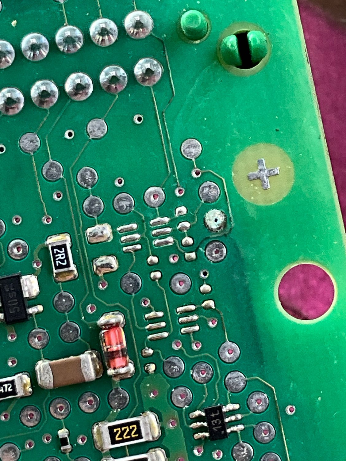

hey thanks a lot for the reply went over fuses already found some blown in the box you told me I did the good ol wire to both ends to see if that would make any difference and nothing I kinda got overwhelmed and called a programmer, I’ve taken this whole car interior apart already I’ve taken out the bcm ecm and I noticed some corrosion on the bcm connectors same for the ground that’s under it I cleaned both up no difference, so I contacted the programmer guy he said the issue was a module I asked which one he said either the bcm or the cluster is toasted I can find a bcm tomorrow but don’t I have to re program it? Thanks have a good night

Hey guys hope this helps out any of you that might have this same issue so what was wrong with my car was the bcm thing was fried shorted it was making the car gremlin out so hope I helped
