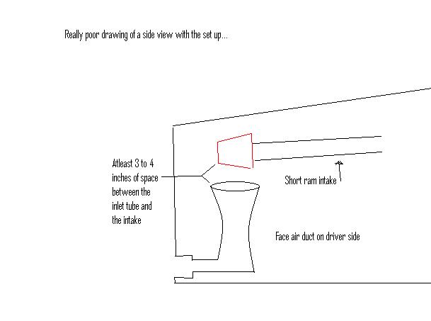

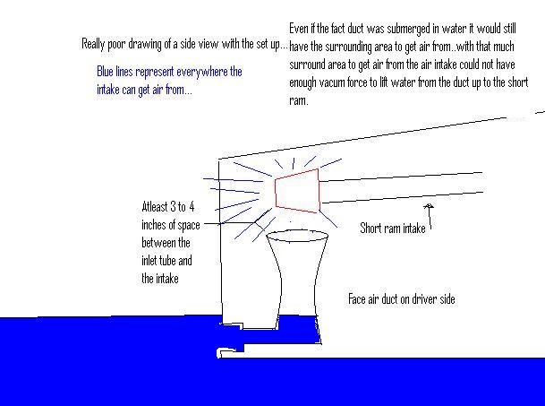

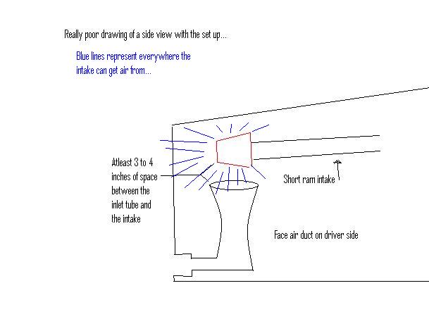

Yes, but you have to be holding the shop vac either in the water or at least 1-2 inches above the water. The shop vac also doesn't have the option to get air from anywhere else except the attachment that you hold.
In this case you would have a standard short ram air intake and then a tube that that mount 3-4 inches below the short ram, that means if just the fact duct was flooded with water that the air intake would have to suck water up 2 feet of pipe from the flood line. Now that being said what about the surround areas that the air intake can get air from? Some how to get water lifted 2 feet from a flood line into the engine the air intakes vacuum force would have to be only applied in the face duct tube...it would not be sucked from anywhere else, which is not the case. The short ram intake can suck from the top, left, right behind, and bottom with equals amount of vacuum force. IMO it is just not possible to hydro lock the engine with this set up… unless you are managing to go at speeds where the inlet would act as a "cannon" and force the water up the tube directly into the filter. For this to happen you would have to be almost speeding in a flooded area, which I think many of us wouldn’t do...
-Sean
