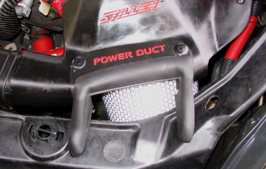

Attached is a photo of the R2C PowerFlow filter used in a Stillen system.

Can you post the dimensions? As you can see, that picture doesn't look like the stillen on my G. ie.. that filter dseems to stick out more than than my application above would allow. Hence the request for the stillen replacement filter dimensions.
Actually if you look really close, it looks like a portion of the stillen box has been cut away to allow your filter to stick out more. Correct?

Here's the Stillen replacement dimensions.
R2C replacement for Stillen systems:
Overall length to flange 8.5"
Filter Body length 7.75"
Small diameter 5.25"
Large diameter 7.50"
As noticed, it seems too long and confirms my observation above. Any reason to offer a filter that needs modification to fit? Not like that's a particularly bad but it should be mentioned.
I don't know why I'm pm'd these dimensions vs posting them here. I hope it's okay to do so.
To answer the pm question. The JWT dimensions were pm'd to me by the same person that pm'd me the stillen dimensions.

I received a PM from R2C and they said they were aware they were offering a filter that was too big to fit in the Stillen enclosure w/o modification (as per my thoughts). They said they would now incorporate that info into their instructions.

^^^ wait... what??? The filter they said was designed specific for Stillen - they are now saying requires modifications to fit??? WTF?
Here I am all happy that someone finally makes a non oiled reusable replacement for Stillen and it turns out it doesn’t fit?
Hell there are already other replacement filter out there that will fit with modifications... doesn’t Ams make one>
I'm kinda pissed now.

I could have used you in the R&D dept. along with your cars. See the reply in the other thread. Apologies for the error. Trimming aside, it remains the finest performance filter you can buy for your G35.
