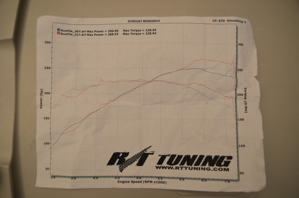

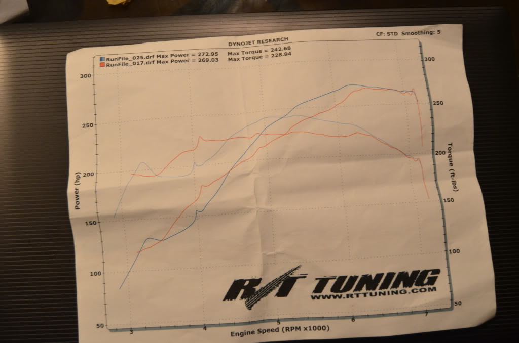

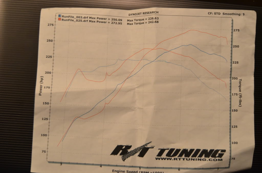

Here is my dyno comparing my momentum header/ART pipe combo to cams and longtubes.
dyno of momentum header/ART pipe cams vs cams and longtubes
dyno momentum headers/ART pipe vs momentum headers/ART pipe with cams.
My car ran 13.1 on the 250hp tune.

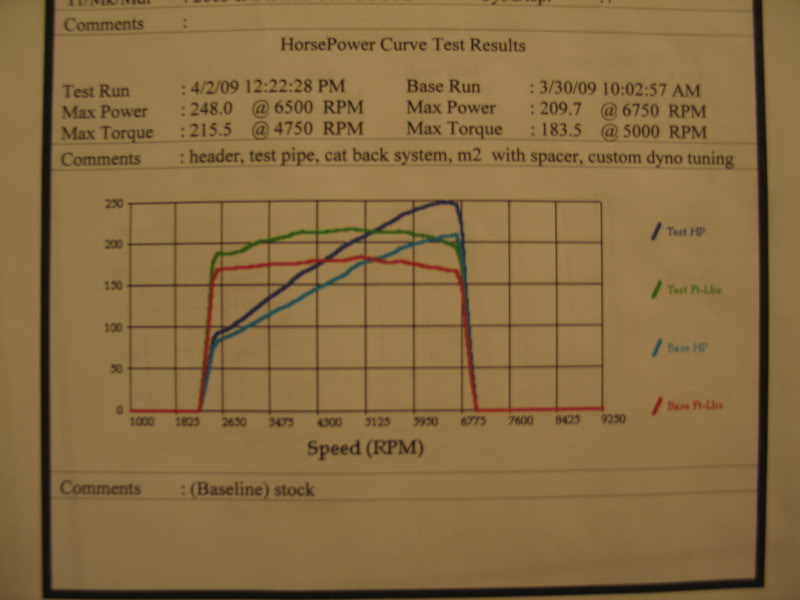

Thanks for this link, dsskyline - hadn't seen it before: http://tune2win.com/index.php/projec...5_power_adders
Notice how there was very little improvement in torque with all the other bolt-ons, but the headers appeared to add a solid 10-12ftlbs across the entire powerband.

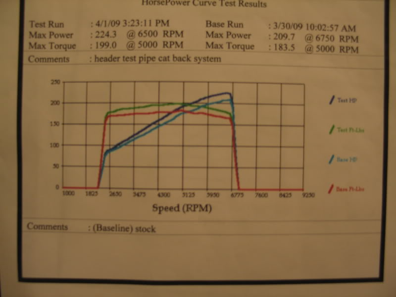

^jarrod, here is almost the exact same test i did on my car (03 g35) from stock to DC headers, TP, motordyne y pipe.
As you can see almost a verbatim gain.
Here is the final outcome of my car after I tuned it, added the JWT popcharger+z+tube, 3/8th spacer (not in stalled on SGM).
