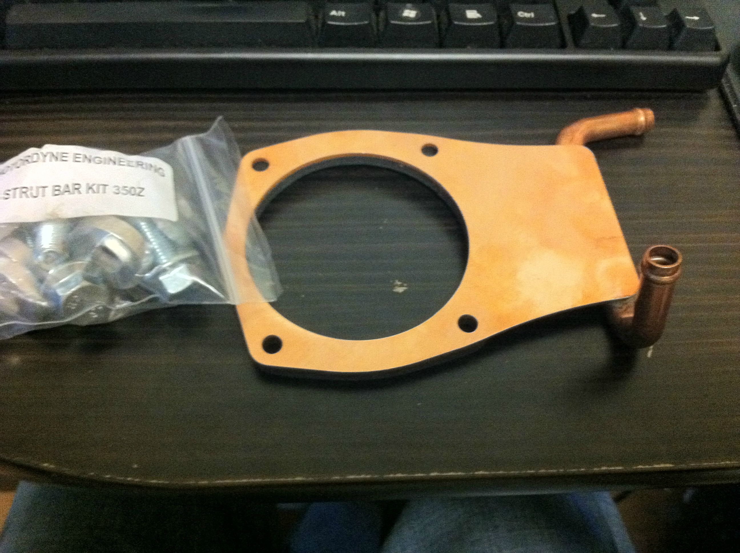

What part of the 5/16 spacer is this?
Well.. after finally picking up my car from the shop today after 2-3 days of it being there for installations of some parts... they told me this part of the motordyne spacers doesnt fit in my 2003 g35?
What does this part do? And is it neccessary to have in my car for the full performance of the 5/16 spacers?
It does fit. It goes between the intake manifold and the throttle body. The idea is that you mount it between them with the copper side facing the throttle body and insulated gasket facing the intake manifold. Then you remove the coolant lines that heat the throttle body and install them onto that piece. This still allows the throttle body to warm up with coolant in cold weather but keeps heat from spreading the intake manifold. This is to work in conjuntion with an iso-thermal gasket between the lower intake manifold and the mid-intake manifold piece.

as for necessary, it depends on your climate. I don't run it because i put a valve in those coolant lines to close them off so coolant doesn't flow at all. Its not necessary to heat the throttle body in FL winters.

I should of never trusted this place.. seemed sketchty but apparently alot of g35 drivers from brooklyn area went to him..
Yea since you have it, I would install it. It's nice to not have coolant flowing around the intake manifold when you dont actually need it there. Its better to just heat the throttle body. You know it's pretty easy to install yourself...
Is there any downsides to not having this installed? Cause im most likely gonna be charged a hour worth of a labor for this -___- and I dont wanna go back to that old mechanic cause they are all douchey there
well without it or a valve to block coolant to that area of the intake manifold, it makes the lower gasket pointless when it comes to increased thermal isolation. Now if they couldn't figure out how to install that piece, what is to say they even installed the lower gasket and didn't just do the spacer in the middle? It's more sad that you had to pay for that piece and aren't using it. There are kits that don't come with the iso-thermal option and are just the spacer and they cost significantly less. As for how to install it, that manual gives step by step instructions.

Instead of generalizing that this "may not be needed," I will throw in some facts that I heard from a personal phone call to Tony from Motordyne Engineering himself this afternoon.
Quote1: "it makes the lower gasket pointless when it comes to increased thermal isolation"
No, before the installation, the coolant and lower aramid gasket are heating the WHOLE plenum. With the ISO THERMAL aramid gasket in place of the old INTAKE MANIFOLD gasket, heat transfer is reduced to the lower collector (MREV2 location FYI). Therefore, the heating of the upper plenum and the TB is reduced during all periods of temperature.
The insulated Copper TB spacer (omg increased hp from TB spacer) "coolant line" has the insulated side and the bare copper side. The insulated side sits up against the upper plenum for reduced heat transfer. The upper plenum is the only "isolated part" from heat sources in this assembly we look at.
Why do you NEED this? Tony went further to say without the TB heater, the TB would stay much cooler at operating temperature in freezing conditions. Because the temperature of the TB is lower then OEM spec, the TB has the opportunity to freeze open (usually on interstate travel)l. This causes the engine to run lean (lack of gasoline, overdose of air) and can cause the car to stall. Stalling is not something you want...

Installation is as simple as taking off the Z-tube, TB screws, etc... there are youtube videos. I will be installing this again on my car soon and will make a video if you would like. You need a 4mm allan tool and a flat blade screwdriver. It should take 30 minutes.
Hope this helps!
