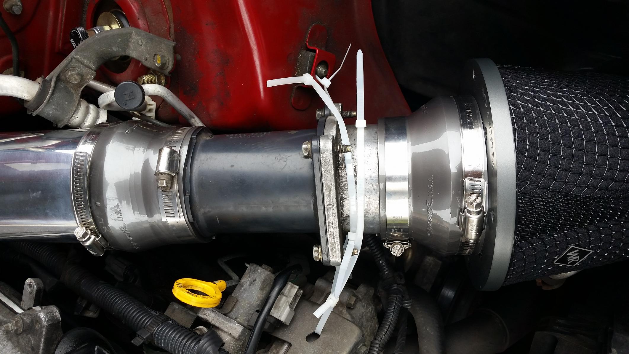

Just installed a weapon R secret intake in place of my AEM Cold Air Intake. Now my AFR is running at like 12.0 - 12.1 At full throttle meaning more rich which makes me think that this intake is taking in less Air then the AEM CAI.
Here are pics of it installed, Do you guys see anything wrong with it. I feel that it is a bit too loose. Thats why I have zipties supporting it.
Please inform me if something looks like its installed incorrectly.

Your first mistake was buying anything WeaponR, it's like way on the bottom of the quality barrel! They don't make products specific for our G35s, take it off and pray the vendor you bought it from will take it back. Zip ties? If it was made to fit there would be a bracket that bolts to the side of your plenum. Mr. Wong (our vendor) sells the Fujita intake, it comes with everything needed to fit/bolt up correctly. Or Stillens CAI is another intake that works great, made with composite plastic that won't be effected by heat...and comes with a giant K&N cone filter. You have sooo many better choices for intakes, do more research next time you buy a mod item for your ride...Gary

I didn't know Weapon R wasn't good. I actually heard good reviews on them. And I liked the fact that they had a FOAM filter. Thats what everyone seemed to like about them. My AEM went down to the bumper, and I think I might just try what WestSideblu recommended. I read all over that CAI is not good on our cars. So I went after Short Ram. And I was recommended to buy Weapon R.
So, I think best way to test is install AEM CAI back on, test AFR. If its good, then the new Intake must be worse, meaning taking in less air causing a richer AFR. IF its still bad, then maybe something needs to be reset or calibrated. I also want to try removing the pipe taking filter down to the bumper, because in the rain it tends to get really wet.

I just reinstalled my AEM CAI and what happens, my AFR is back where it needs to be (right around 13.0). I then tried installing the filter right after the MAF reader, so pretty much short ram AEM, and that was better then weapon R, but still rich (12.3). So i tried one last thing after, and I used the foam filter from the weapon R onto the AEM cold air pipe back down to the bumper region, and i got the best air flow (13.3 AFR). So, ya I will have to re-tune it to get a bit more fuel into this mixture, but this proves GARY C's point, Weapon R is garbage.
Should I post a review on WEAPON R for other peoples reference??
I also now wonder why people say short ram is better then CAI in our cars. I tried AEM short ram and it was much worse then the Cold Air piping (12.3 vs 13.0). And when a foam filter is used its even better air flow (13.3).
I haven't tried Z tube yet but, I dont think itll be better then the AEM CAI. Especially with those big nismo bumper ducts helping.
