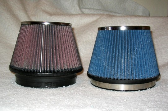

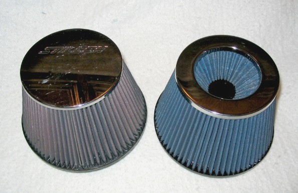

Approximate JWT filter measurements.
Total Height = 5.750"
Filter Area Height = 5.125"
Small End Diameter = 5.250"
Large End Diameter = 7.625"
Filtered End Opening = ????
Opening Diameter ID = 6.00"
Opening Diameter OD = 6.375"
Attached Thumbnails Measurments of a PopCharger Air Filter-stillen-jwt-filter-elements-1.jpg   Measurments of a PopCharger Air Filter-stillen-jwt-filter-elements.jpg
