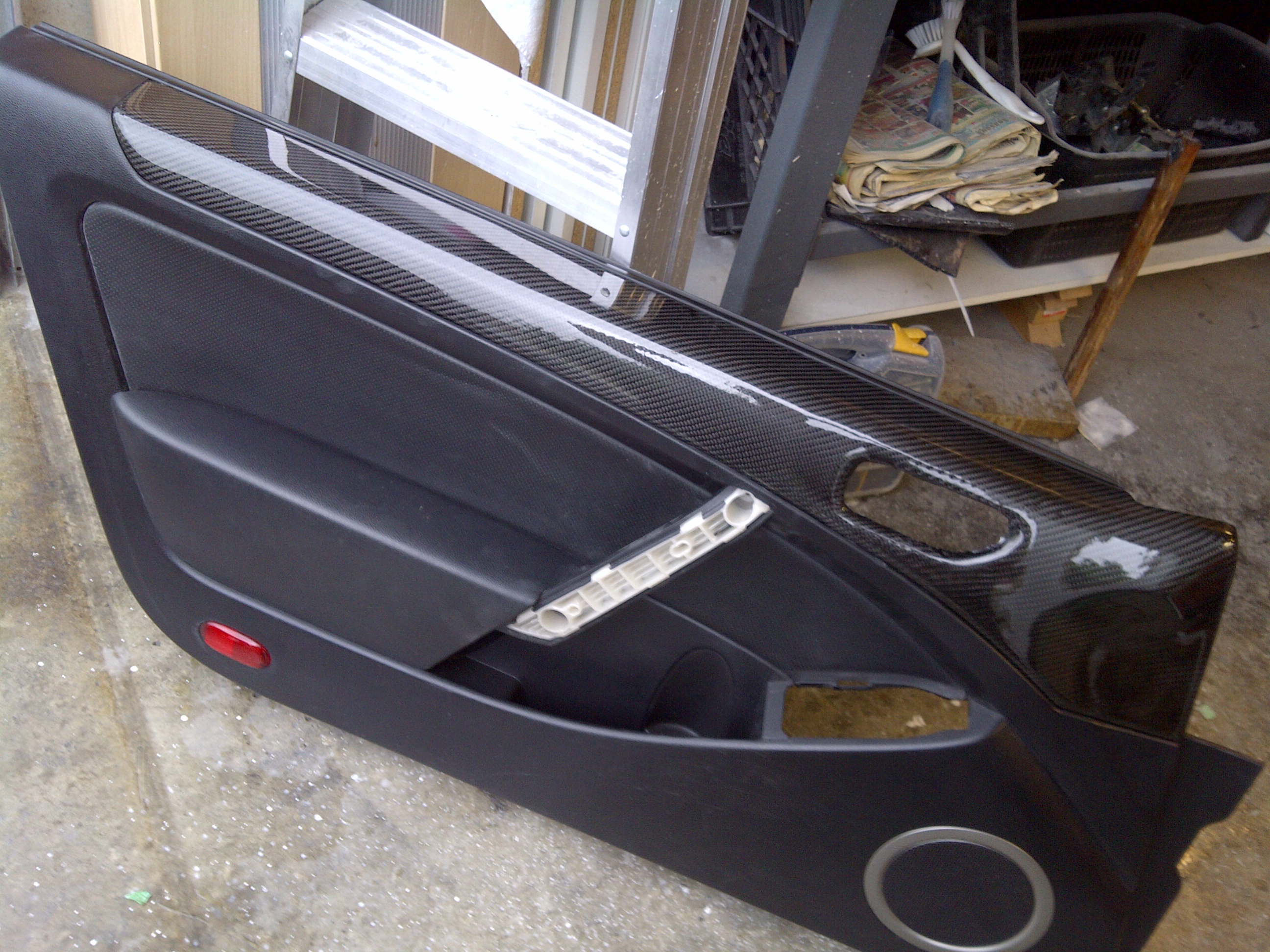

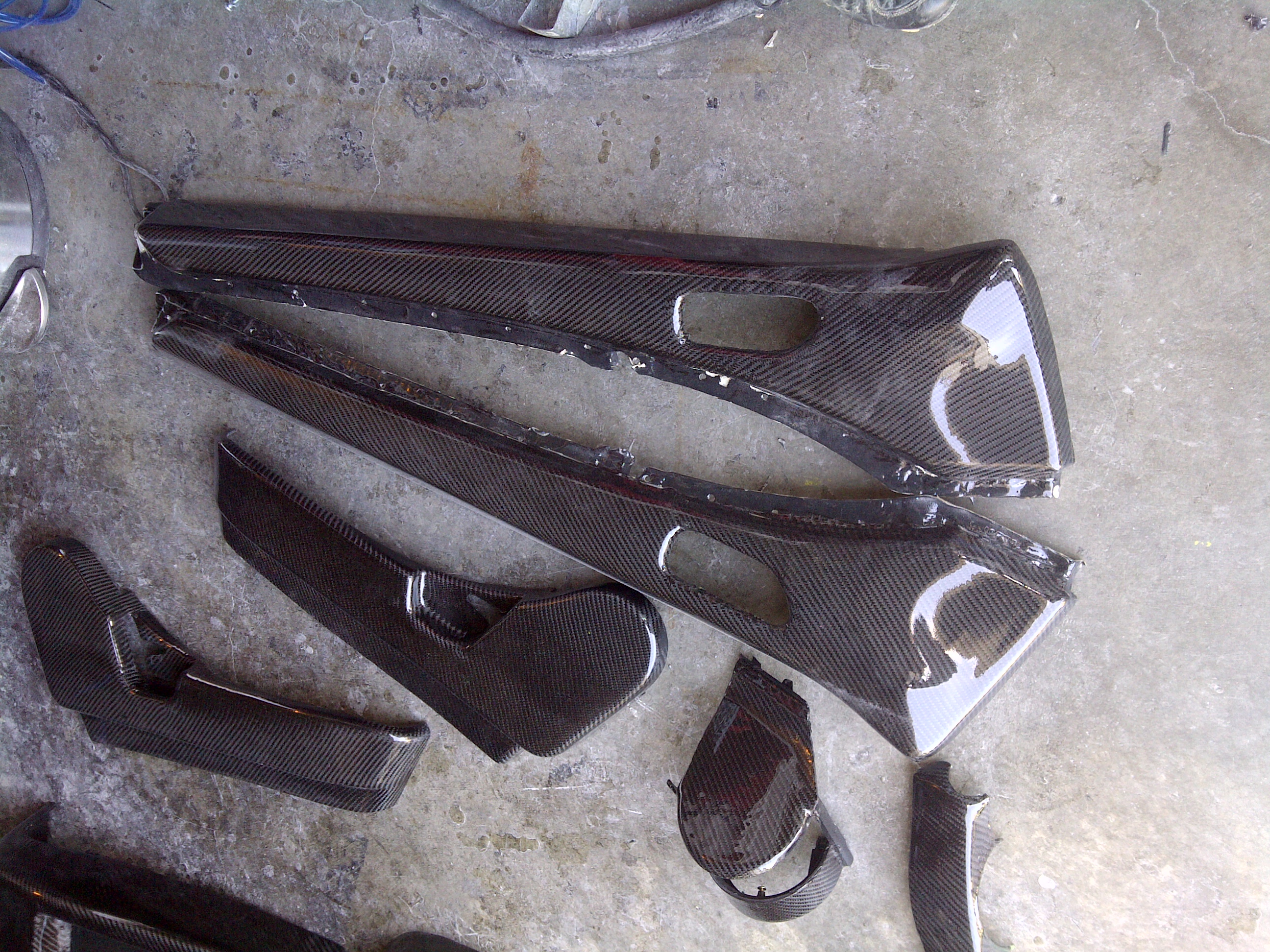

Originally Posted by Mr. Brett
Just curious, the tops of the door panels...do those come apart? Or are they one piece? I've had the panels off probably 100 times and never bothered to look...
The top panels are removable as seen in the picture below. Parts were at resin stage in the picture.
Thumbscrews attach it.
And after re-assembly. Handles were completed, but not installed yet in the picture below.
