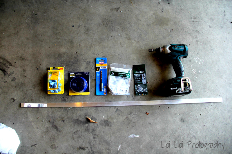

tools need for the job metal bar at the bottom was not used, its basically its screws small "L" brackets and a drill with drill bit

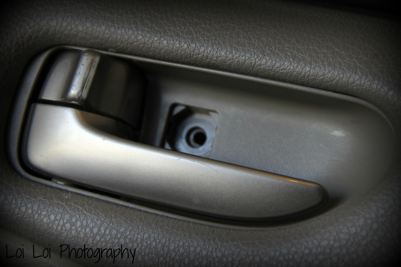

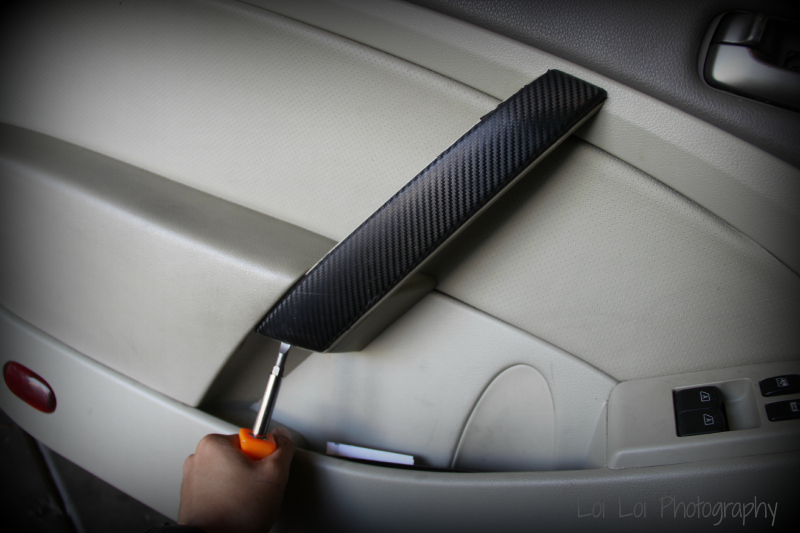

first remove a small cover at the door handle with a screw behind it
now remove a the cover at the door handle
now once that is removed there should be two screw behind it

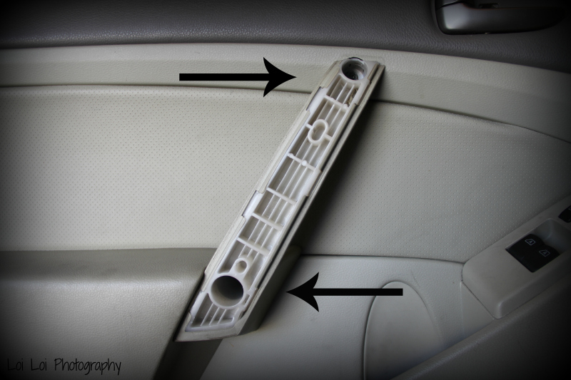

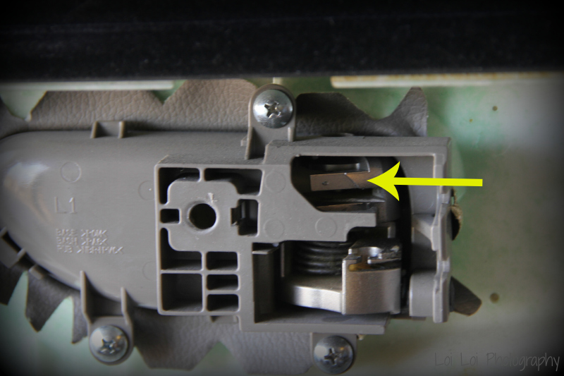

use a dremel to drill out the top part inside the door handle the yellow arrow shows what need to be shaved down

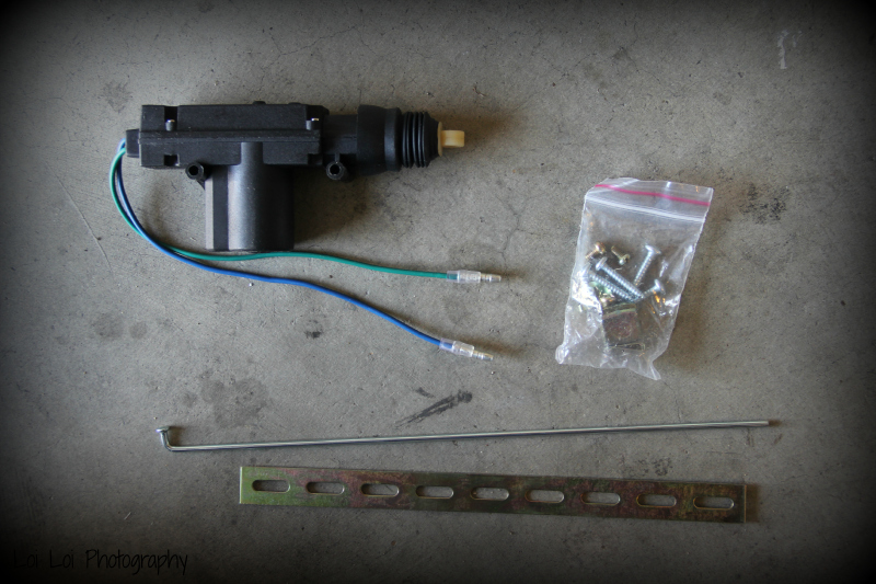

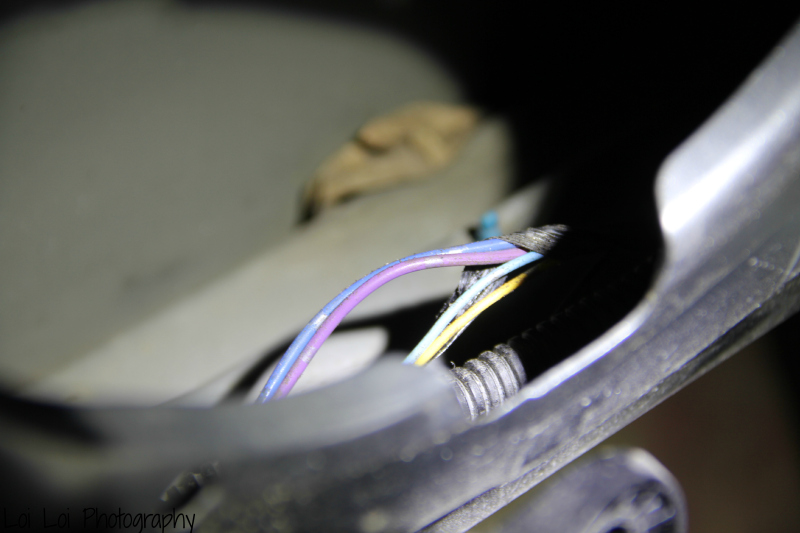

how remove the door speakers and behind it should be a few wires but the main ones are "blue" not baby blue and the other one is purple those are the two wire that will need to be tapped in

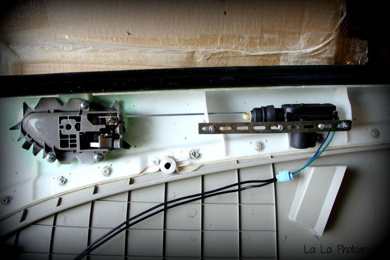

how make sure you line the up the rod then drill threw the white plastic and grey door handle, make sure you drill and make a big hole for any adjustment or room to play with now the rod that came with the kit will need to be cut down to fit
how this is how it suppose to look like
