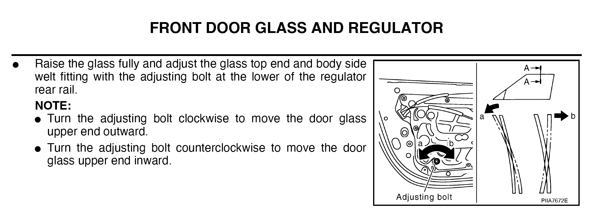

Here is the diagram from the FSM for the window angle adjusting bolt.
Attached Thumbnails Help with window and sunroof-front-door-glass-adjust-bolt.png

Thank you for that. It confirms what I found last night.
I tried doing that but I think the regulator is just worn out. Neither of those cam bolts do anything at all.
I am going to have to remove everything anyway as I found that the door skin I replaced the original with is bowed anyway. There is a good quarter inch gap in the middle of the window between the glass and the rubber sweeper. I’ll just bondo the old door and get a new regulator when I swap it back out. I’m going to be painting the car eventually anyway. It has a few other bondo spots. I just got this other door skin for free haha.
Thanks again. I did manage to get my sunroof leveled out at least even though it still won’t open so that will suit me for awhile. And I think my regulator is just so worn it won’t work anymore. Oh well. I appreciate the info guys
