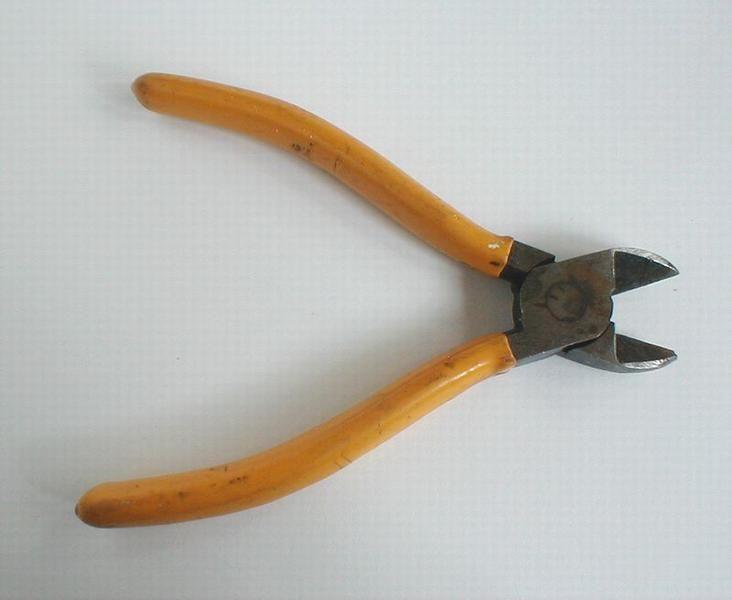

My one tip: for me, anyway, my crappy needle nose pliers were not able to get any purchase on the tabs that have to be bent to open up the stopper housing. I used some side-cutting wire cutters to snag that tiny mashed-down tab end, and it was the cat's meow.
The tool to use
The tool to use
