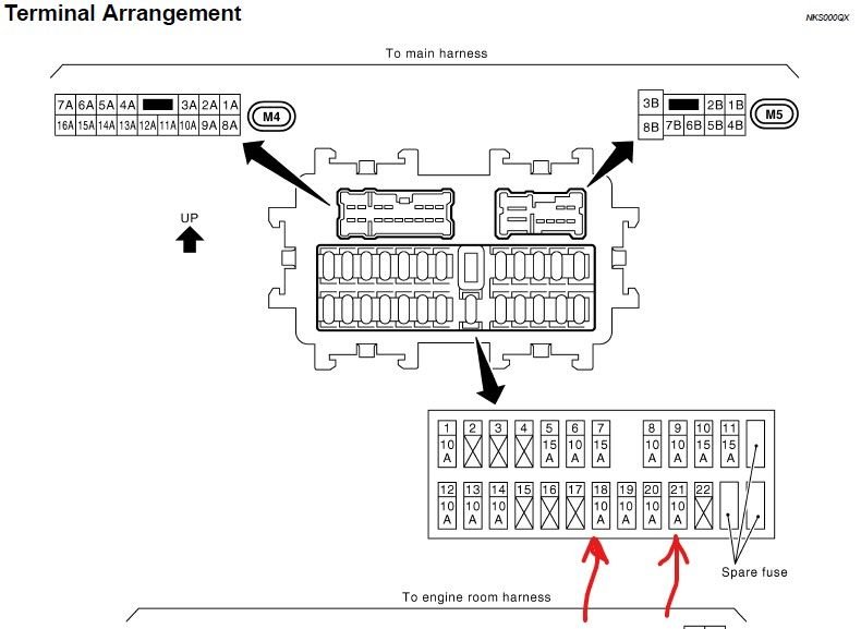

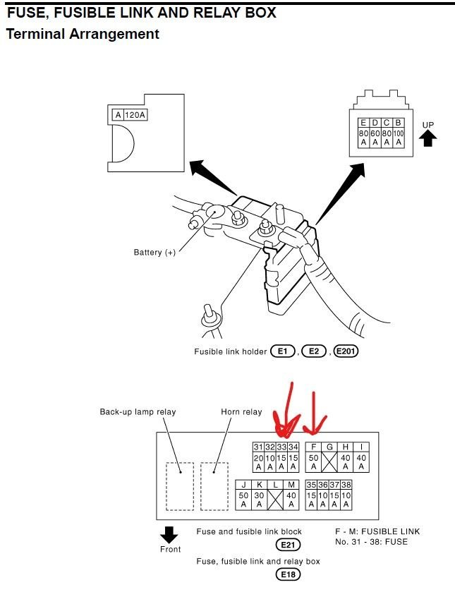

First verify they have power, fusible link holder section F, 50 amp. Then to the Fuse Block - J/B, the cabin fuse block. If you have the regular key system 18 will have a 10 amp, if you have the intelligent key (keyless start) then 21 will have a 10 amp. Also fusible link 33 will have a 15 amp.
Typically what happens is the wires break in the trunk flexible conduit and ground out, blow the fuse, and it stops working.

Since they don't work with either the fob or the switch that's what makes me think you blew a fuse.
