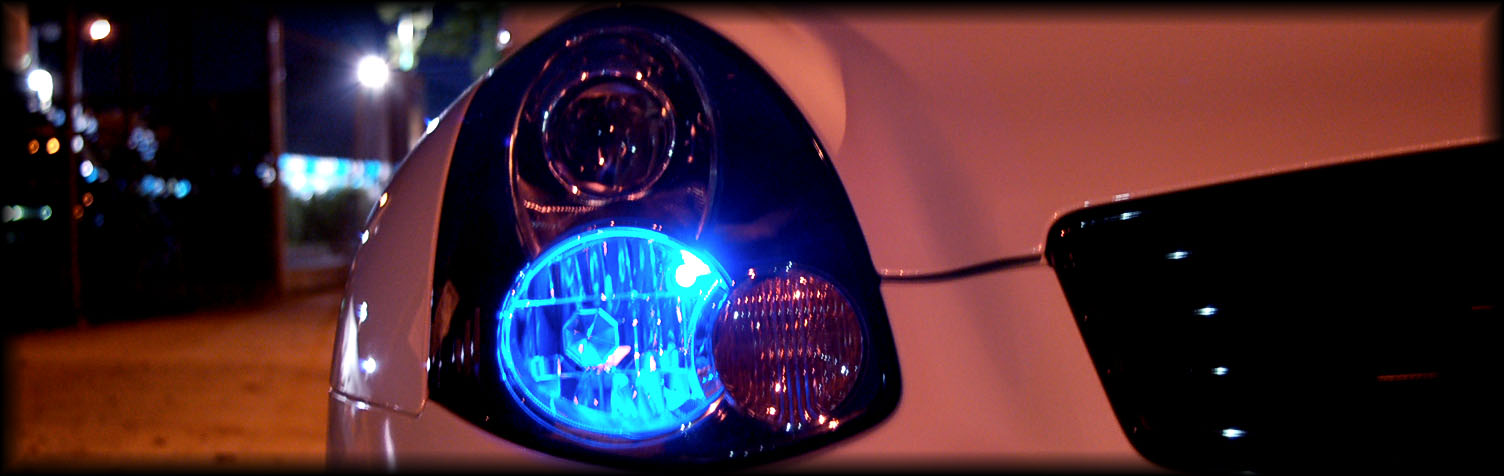

I replaced my city lights with Blue LED's... I have had no problems with the police because my 8000k PIAA H1's blend them nicely and you can't see em very well when the fogs are on and I roll w/ my fogs on 100% when I have my headlighrs on.
WOW
it's HOT!!!
which LED did you use to replace the city light?
I was thinking of putting RED ones but don't know where and which
one to get it..
and did you put blue LEDs under your front body kit?
I'm loving it man~

Thanks!
I got them from here http://autolumination.com/194.htm I got the 194 oval led bulbs...
I would be very careful with the red though... These lights remember come on when you have your headlights on and I think red might be very noticeable to the police and they might not like it too much...
I like the blue because when I have my headlights & Foglights on they are not as noticeable...
I bought 15" and 10" strip LED lights (from Pep-Boys, dont laugh ) and attached them to the underside of the front bumper support to get the effect in the front bumper and carefully ran the wiring to the battery then thru the firewall so I can control them from inside my glove compartment. I also have lights in my engine bay so when showing at car shows at night I can light it up in there. (getting ready for HIN)
I am doing all the lighting myself so I know where the connetions are if I have a short in the future.
