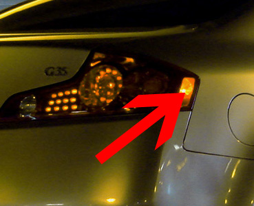

Does anyone know how to replace a rear side marker light (technically, an LED, according to my manual)? One of mine has gone dead somehow, and I simply want to replace it with another factory LED. I just called Infiniti and they said the only way to replace the rear side marker lights is to purchase an entire new light assembly (>$200). This doesn't seem right. If anyone is willing to offer SAFE directions on how to replace this LED, I'd be willing to pay them for that information. Thank you!
So there is no confusion on what light I'm talking about, please see the attached photo.

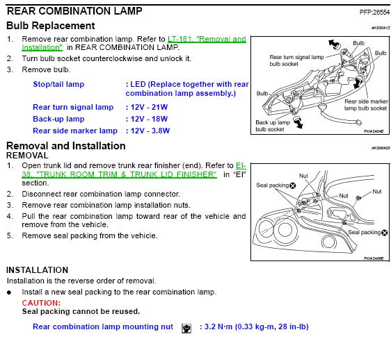

and this diagram for the 2005 tailamp assy...note the bulb in the drawing
Old Jun 4, 2008 | 12:04 PM
vjquan's Avatar
Joined: Jun 2005
Posts: 359
^^^^^ Yup, beat me to it, but it is a bulb.

im checking it out, i dont think the markers are led's.. and i dont think that nissan will downgrade from led to bulb...but who knows... anyway the diagram if for the 2005 model as specified .. should be the same as the 2003 ver
here's the link to the 2003 taillamp assy..by psedog
http://psedog.com/cars/fsm/g35/coupe/2003/lt.pdf
pg 161 (rear combination lamp)
just remove 3 nuts, out comes the assy, change the bulb and life goes on....ehhehe..
no im not in it for the money...

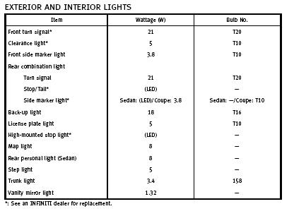

The service manual pic is from an '05 (lamps changed in '06). The dealer doesn't know what they're talking about. Go pull the lamp and find out for yourself!
EDIT: This should clear up the confusion -- the sedan has LED's which is probably why the dealer told you that.
