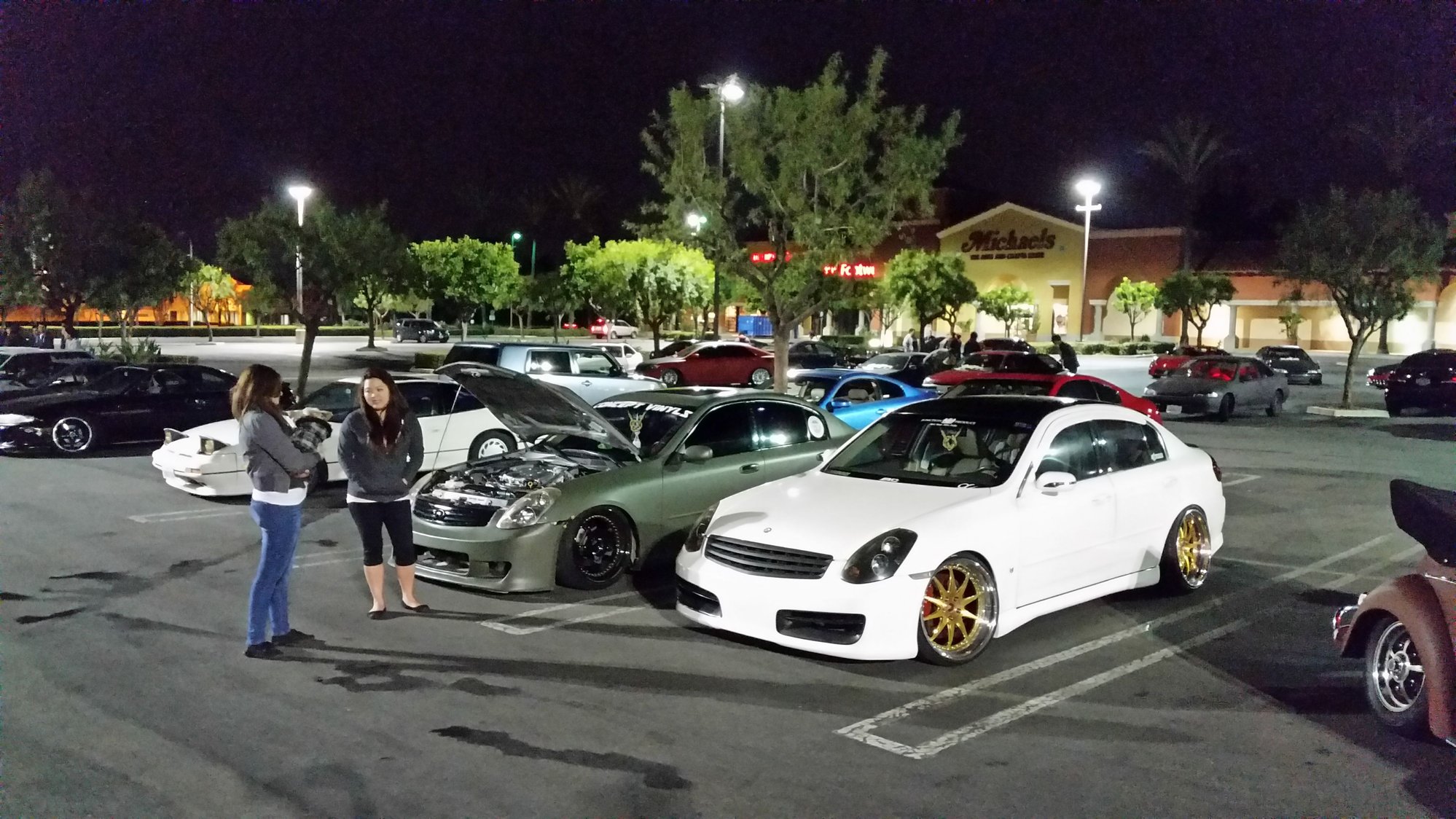

As many of you on Facebook know me as Mike Stig, I have been through a lot with my build from the beginning. I'm sure everyone can relate to how hard it is to stop the mod bug from taking over, throwing money into the G, keeping your lady happy, keep maintaining your OEM parts, and shutting them V8's down in your rear view mirror.
Anyways, I don't go on Facebook as much anymore and would like to share my build here...where my first mod bug got started (H&R springs and Custom built Koni Shocks).
Big thanks to those who have helped me along the way!: #ocinfiniti #outcastgarage #GrantPlummer #Technosquare #BaidPolish #Corner3Garage #Mishimoto #greddy
So here is my progression and endless parts thread:

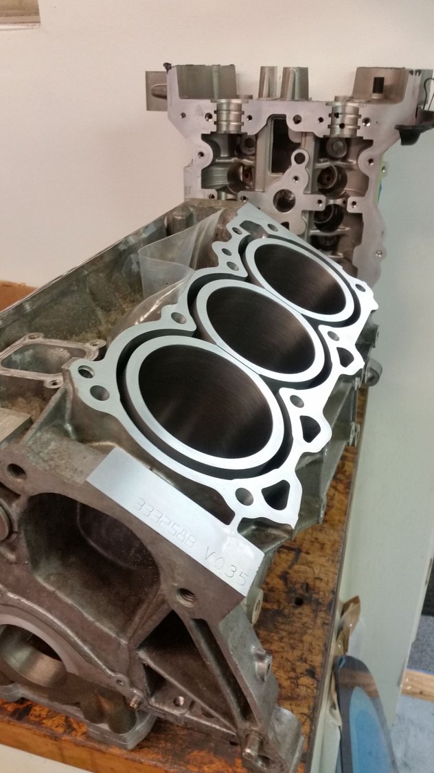

2005 Infiniti G35X AWD VQ35DE - Built by Technosquare

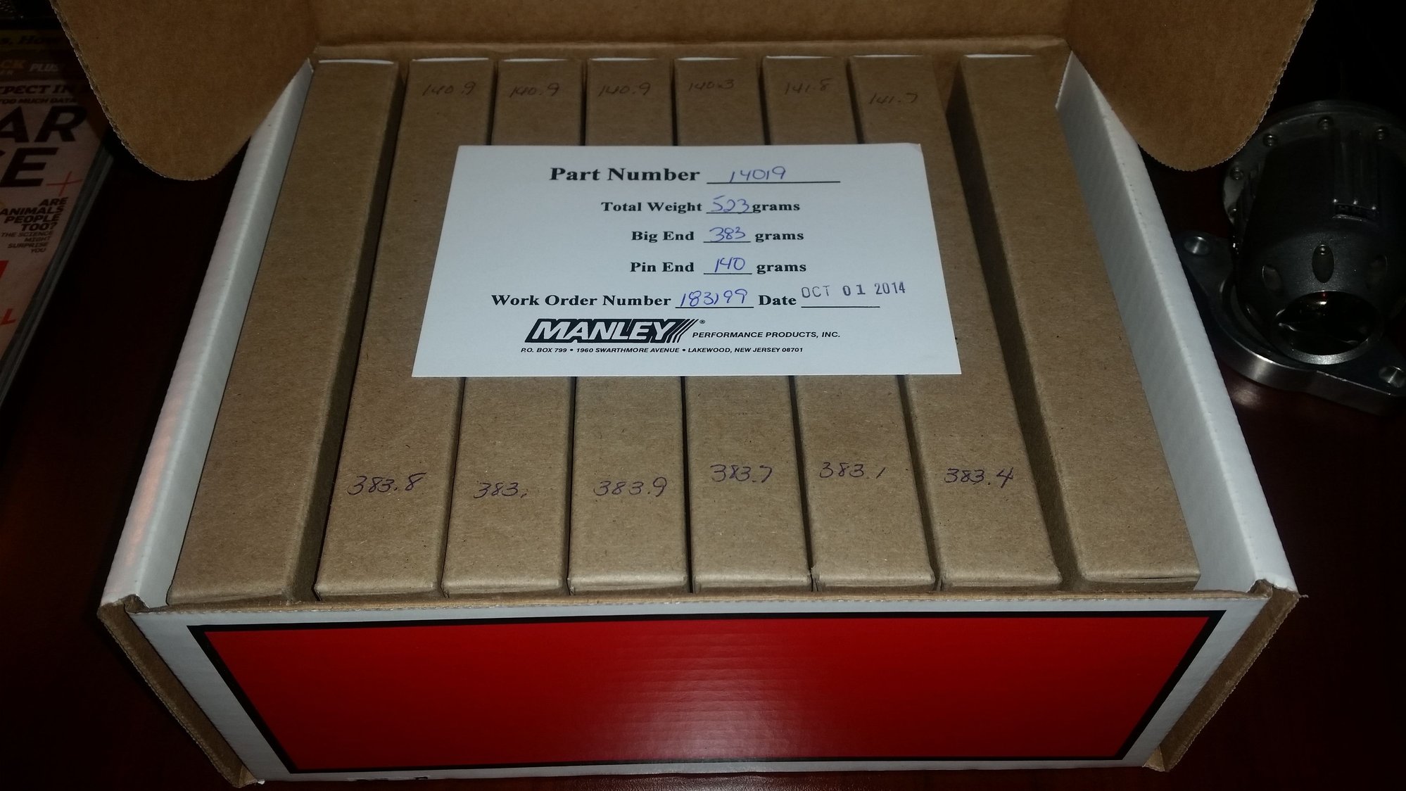

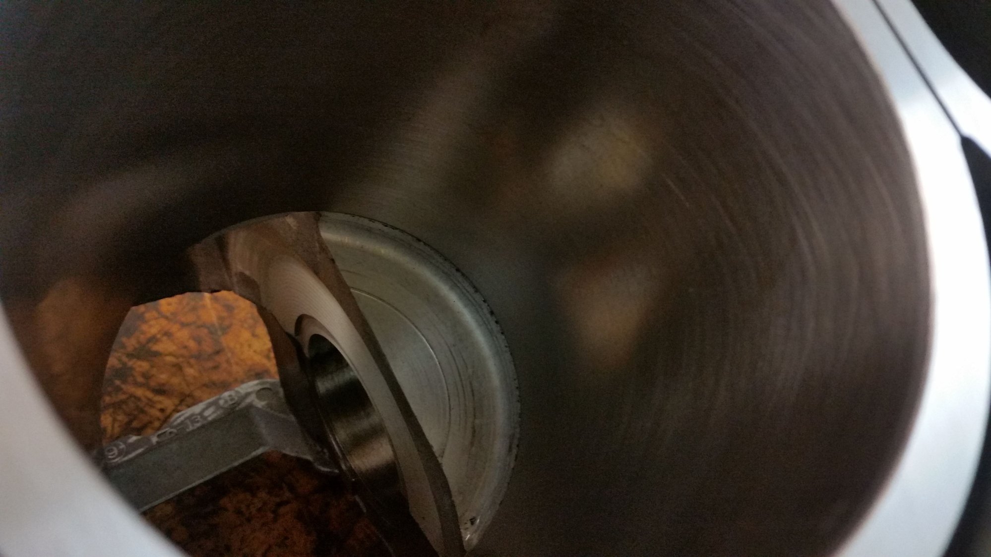

Cosworth pistons– 8.8:1 // 95.75mm w/custom CP piston rings
Manley H-Beam Rods ARP bolts
ACL Main and Rod Bearings
VQ35HR OEM Head Gaskets
Brian Crower valves, springs, titanium retainers
Ferrea Valve Stem Seal Kit
ARP Main (ARP 202-5801) and Head Bolts/Studs
NGK 1 step colder Spark Plugs

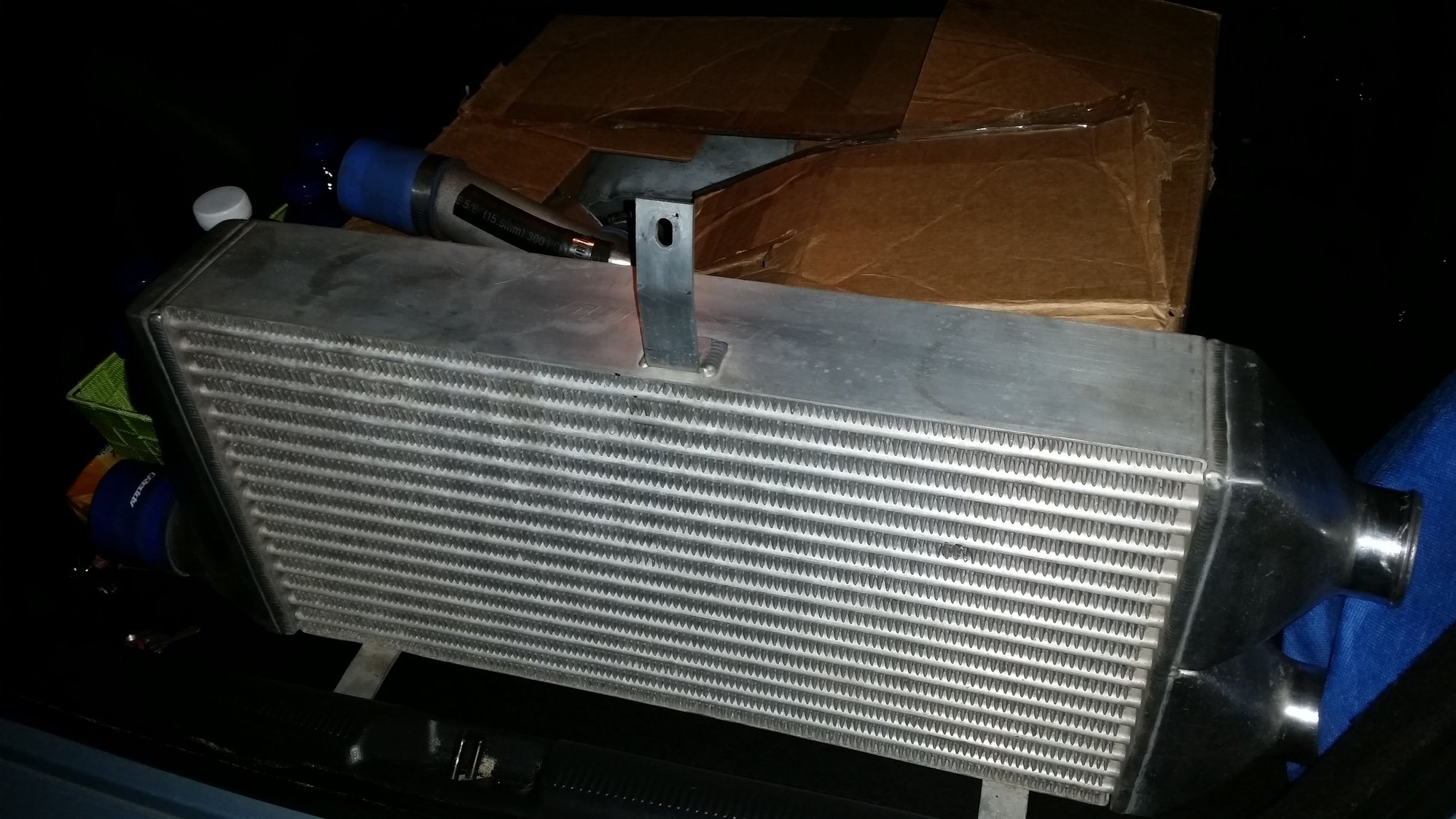

Greddy 18G (TD05) Twin Turbo Kit w/new gaskets and K&N filters (RC-9350)
ARP studs for manifolds

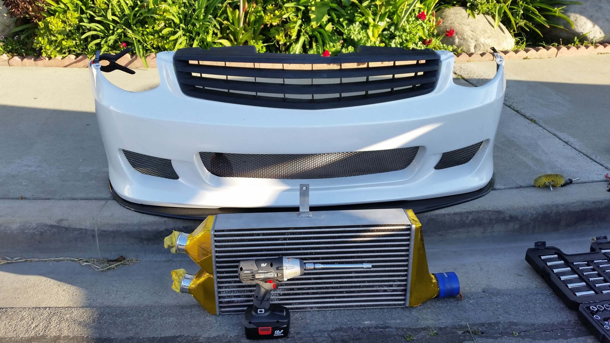

Greddy Upgraded Intercooler

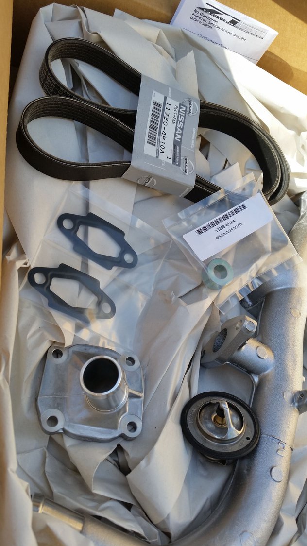

Greddy Thermostatic Oil Block Adapter
Mishimoto Silicone Hose Kit
DEI Titanium and Gold Wrap Intake & Hot Pipes
Mishimoto 52mm aluminum racing radiator
Mishimoto dual 14” slim fans
Z1 Pathfinder Cooling Mod
Nismo Thermostat

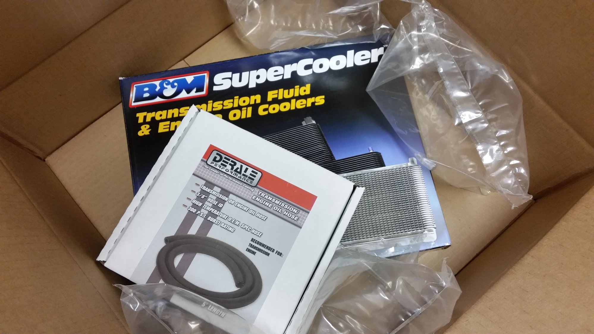

B&M transmission cooler

Hikkatadori Front Bumper with lip & carbon fiber ducts

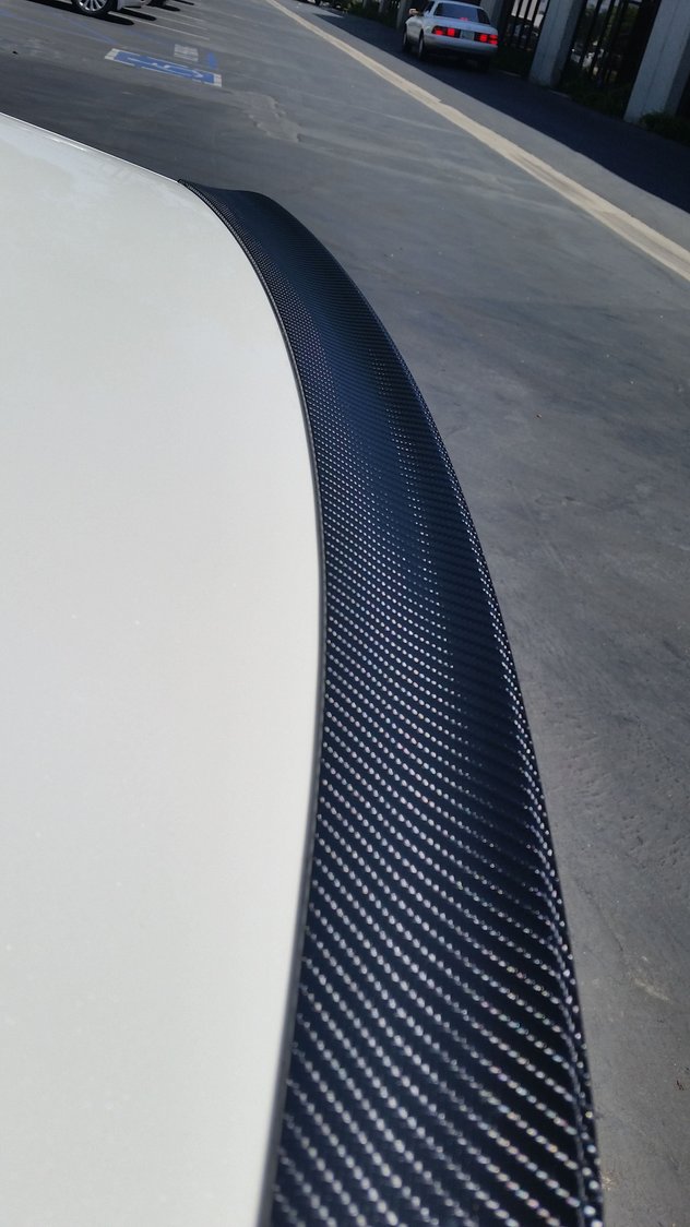

Custom CF lip spoiler
Kakumei roof spoiler

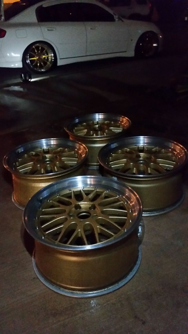

20” Avant Garde F120
Hankook Ventus V12

Sold my old wheels

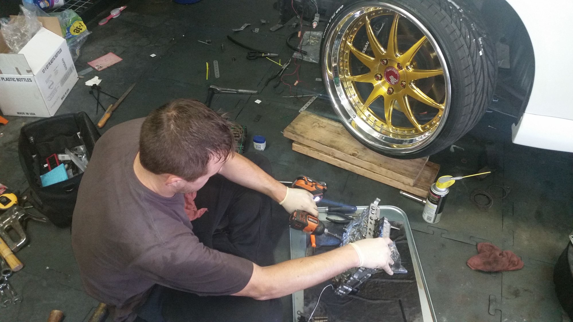

Grant Plummer installing valve body kit
