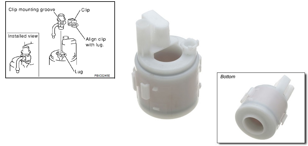

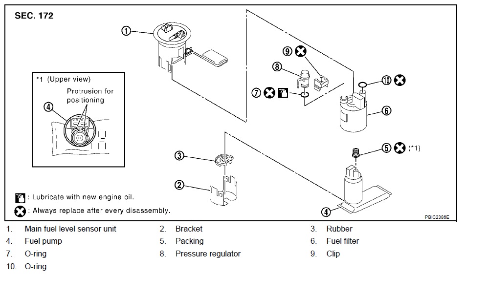

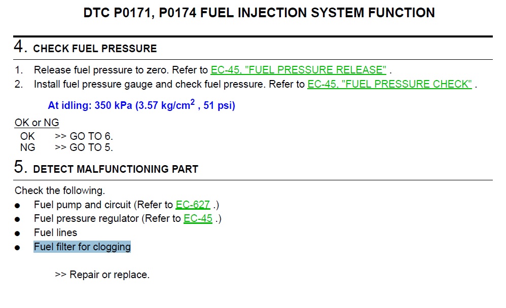

It's def not the battery and starter it cranks nice and fast every time.. My first thought was fuel filter, then if that didn't fix i was going to do the pump... But I also heard these cars don't have an actual external filter and it's just the little mesh sock at the bottom of the pump.. I'm just hoping I was going to come across someone that had the same problem... OH YES, I forgot to mention! It has the engine code P0171 system too lean (bank 1) Mabe it's just the bank one injector
P0171 is a DTC for the fuel injection system. I'm new to these cars but it seems the fuel filter (6) is part of the fuel pump assembly. I know there's multiple threads about how there's no fuel filter. It is supposed to be a maintenance free item according to the FSM. At 160K and if it hasn't been replaced I'd start there since they're pretty cheap, might even do the pump if your going to be pulling the fuel pump assembly.
http://www.partsgeek.com/gbproducts/...VvgaAhzn8P8HAQ
That part appears to match the part in the manual.
Good luck!
Symptoms of clogged fuel filter.
http://www.autohub360.com/index.php/...-filter-13607/
