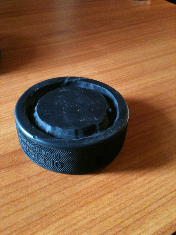

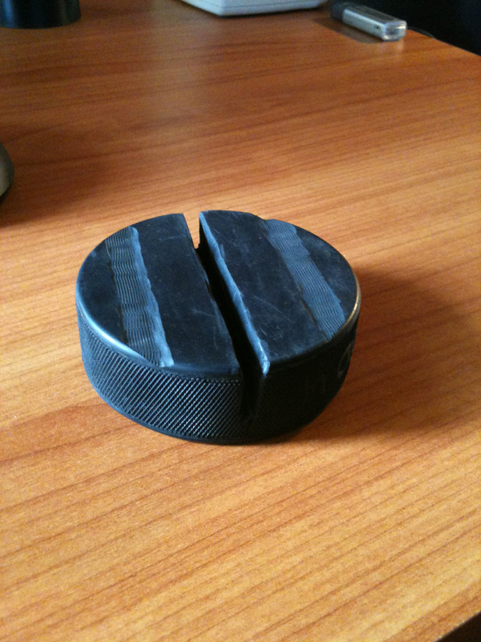

For those of you who occasionally do your own wrench work, you may agree that jacking up a G35 using the pinch welds can be a pain if you don't have the right type of head on your jack. I personally have the 4 pronged cup type that is terrible for the pinch welds. I can never get it to sit quite right on the weld and I have slightly bent two welds when they slipped.
So I said, f-ck that and looked around at adapters for Nissan. I stumbled onto a page with a hockey puck adapter. Basically a $1.25 for a practice puck...then took my dremel and cut a groove in the middle for the pinch weld. And because I wanted the cup to fit in nicely each time and not guess if it's centered or what not, I lazily grooved a circle into the opposite side so it fits in there all nice like. When it's on the jack the puck looks like it should be OEM.
Anyways picks of puck -
Top w/ weld groove:
Bottom w/ cup groove:
I'll snap a pic of it on the floor jack later. I tested it out a few times and it works perfectly.
