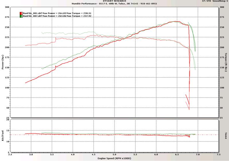

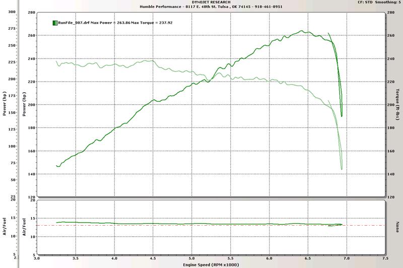

Here ya go man.
As you can see it made some good gains down low. Then after about 5K rpm the computer started pulling timing because of the temps getting high. He tried to adjust the timing as much as he could, but with the new VVEL engines they seem to do whatever they want with the timing no matter what you tell it.

So theres only graphs for the tq? Which is very impressive!
Hmm so the shop is failsafe but you guys drove to humble to get it tuned? The guys from failsafe WAS the one that tuned your car right? Just it was at humble. haha
No graphs of the hp btw? So the they're probably more used to tuning G35's than G37's huh?

No those are both HP and TQ. The first one is the baseline and tune together, the second is just the tuned run.
Yes Chris from Failsafe is the one who tuned the car. His shop is only a small one bay garage so he uses the dyno over at Humble Performance. They are like 1 block down the street from him.
Yeah he's done mostly 350z's and 35's I think. He's had quite a bit more work on the VQ35 engines. I was the first G37 he's worked on.
