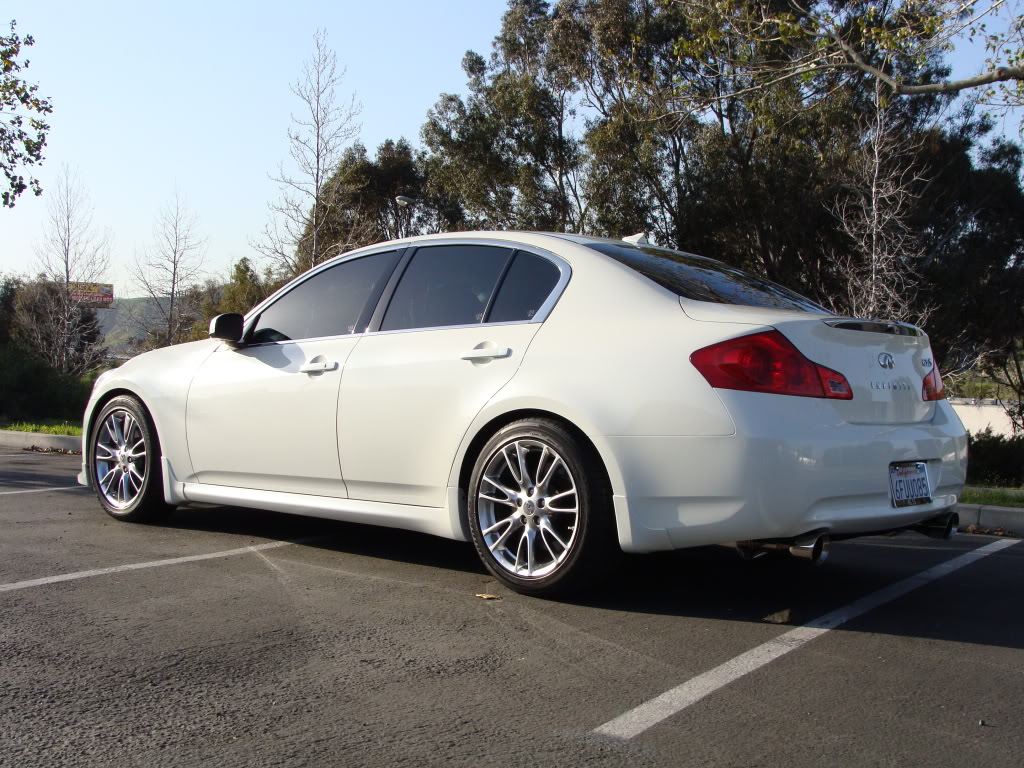

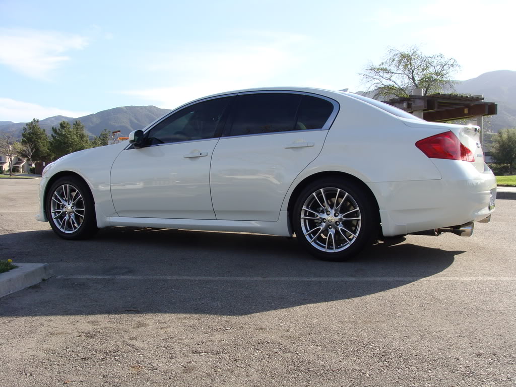

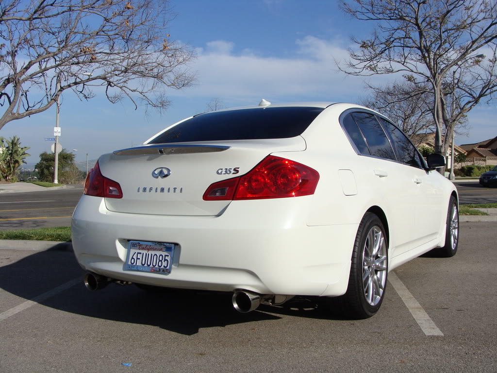

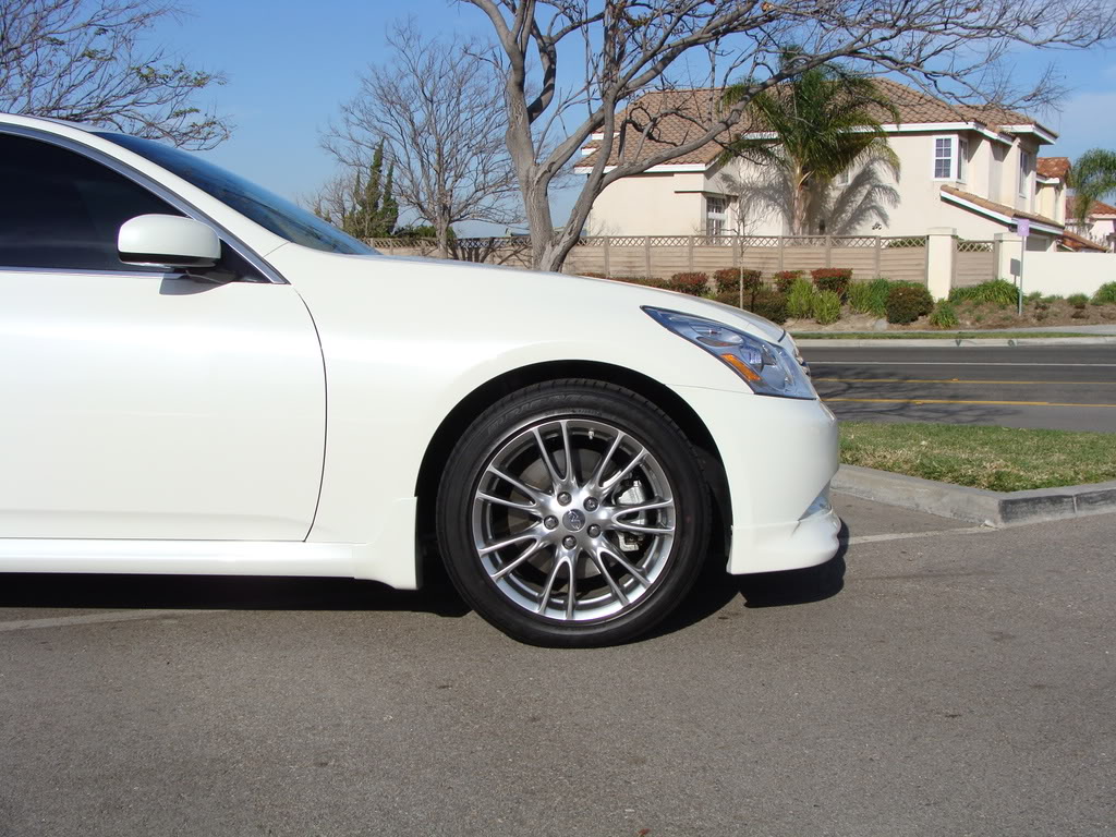

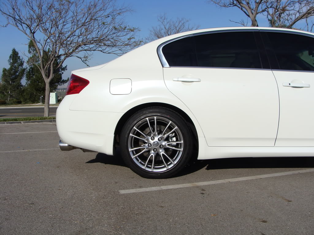

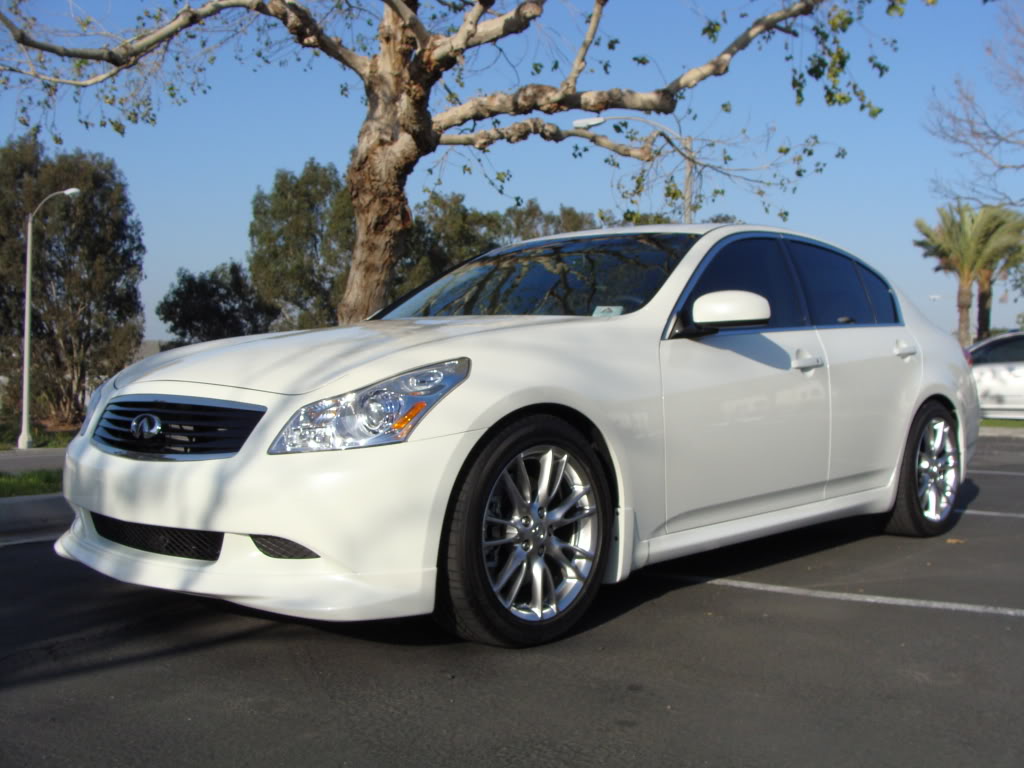

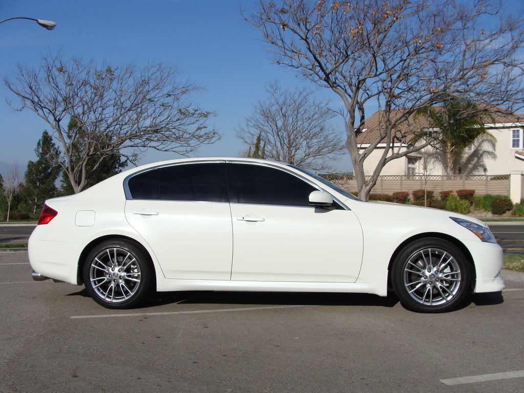

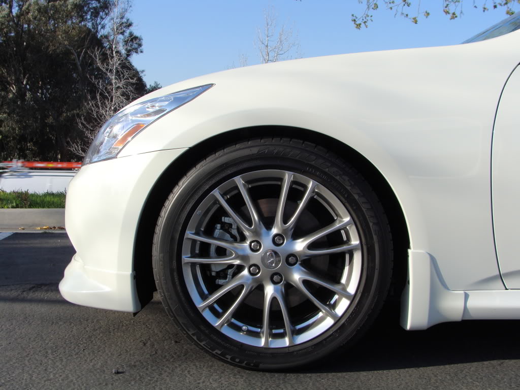

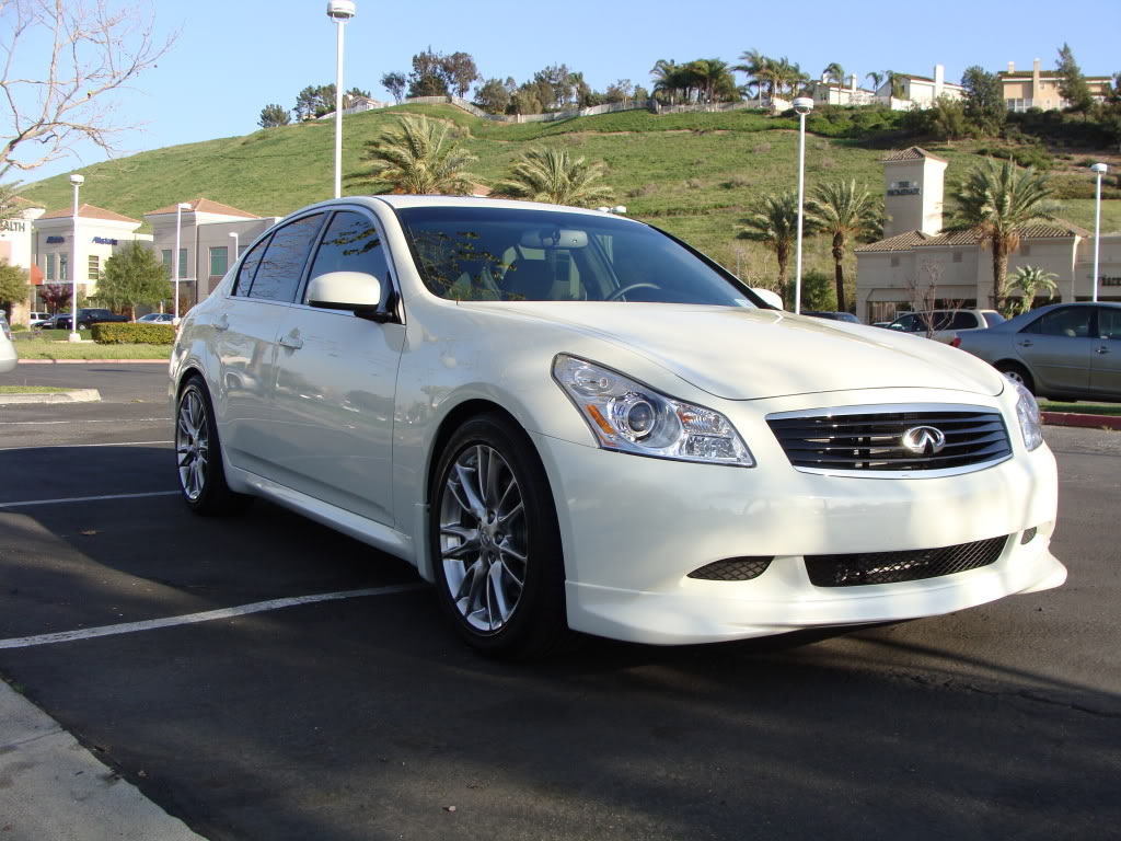

OK... Finally posting some before and after pics with the Tanabe NF210 springs.
I've now driven the car over 400 miles (most with multiple passengers) over the past week and here are the final drop number:
LF: .85"
RF: .80"
LR: .75"
RR: .80"
So, basically, I saw about a .80 - .90" drop in the front and about a .70 - .80" drop in the rear. While this didn't eliminate all of the wheel-well gap, it got rid of about half of it... I'll take sme new measurements in a few days and see if they've settles any more and then post my results.
Before:
After:
Before:
After:
Before:
After:

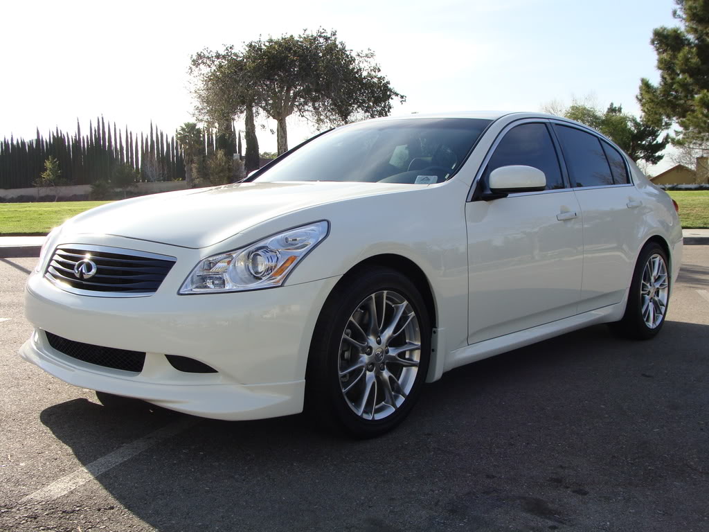

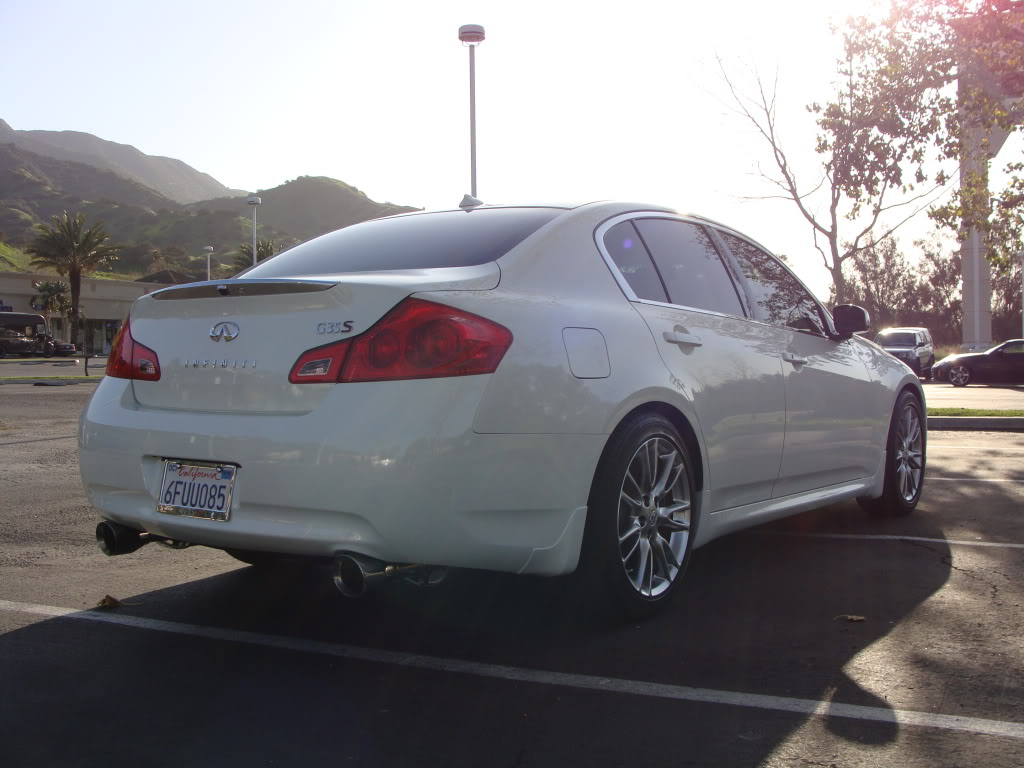

Some more pics of the car before I installed the lowering springs:

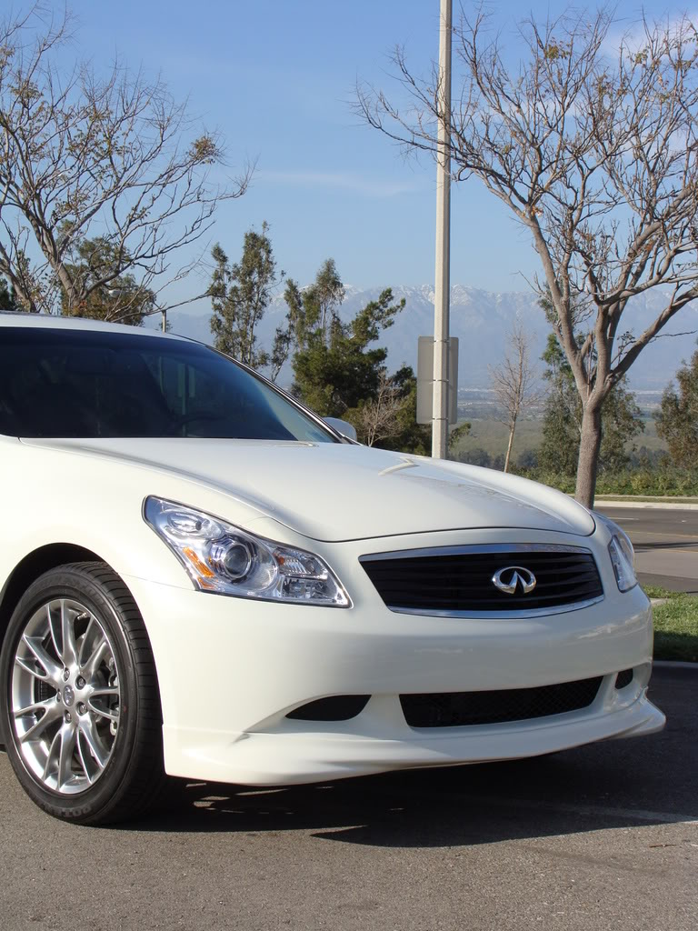

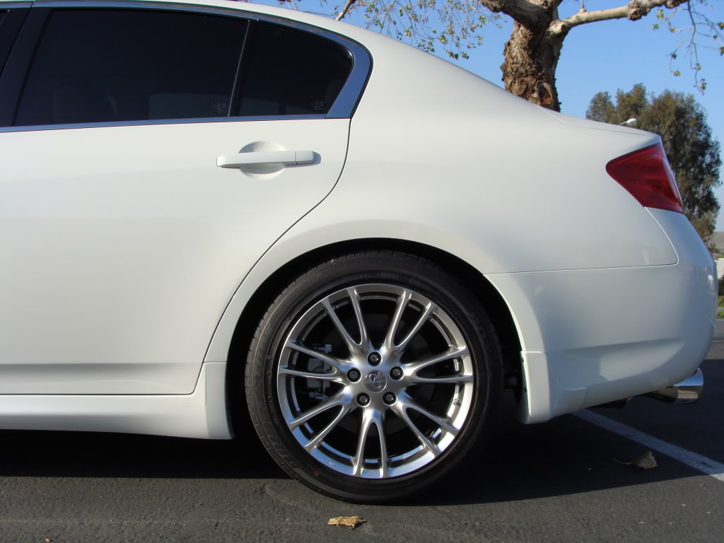

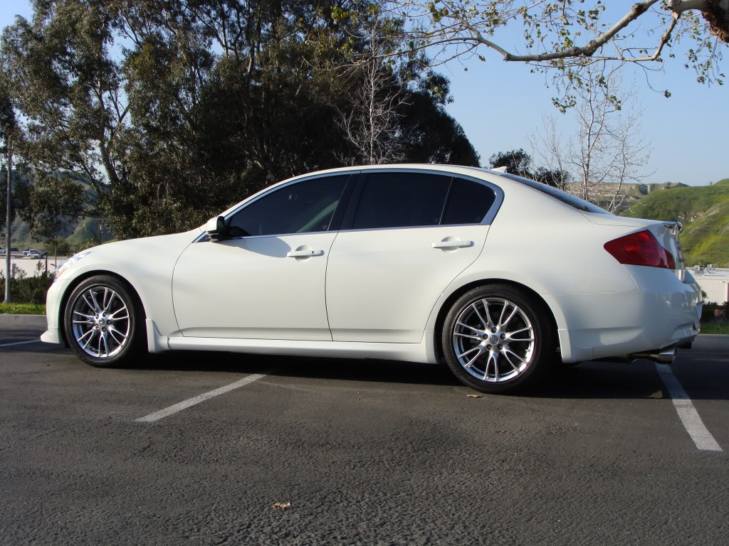

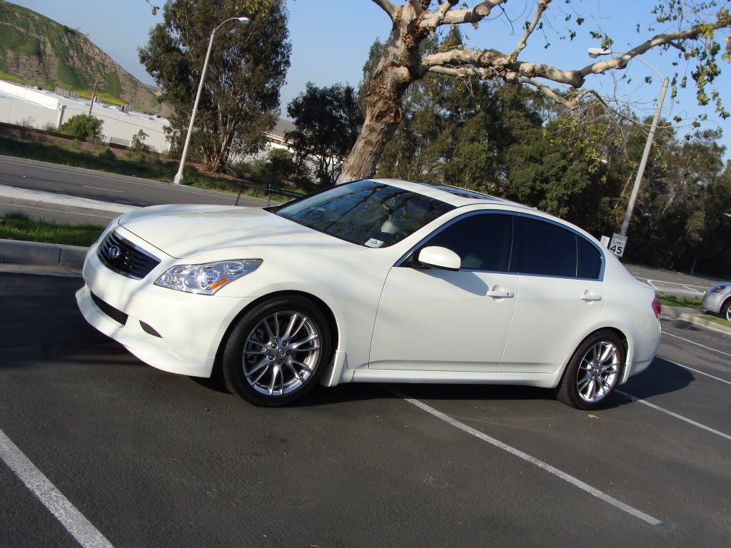

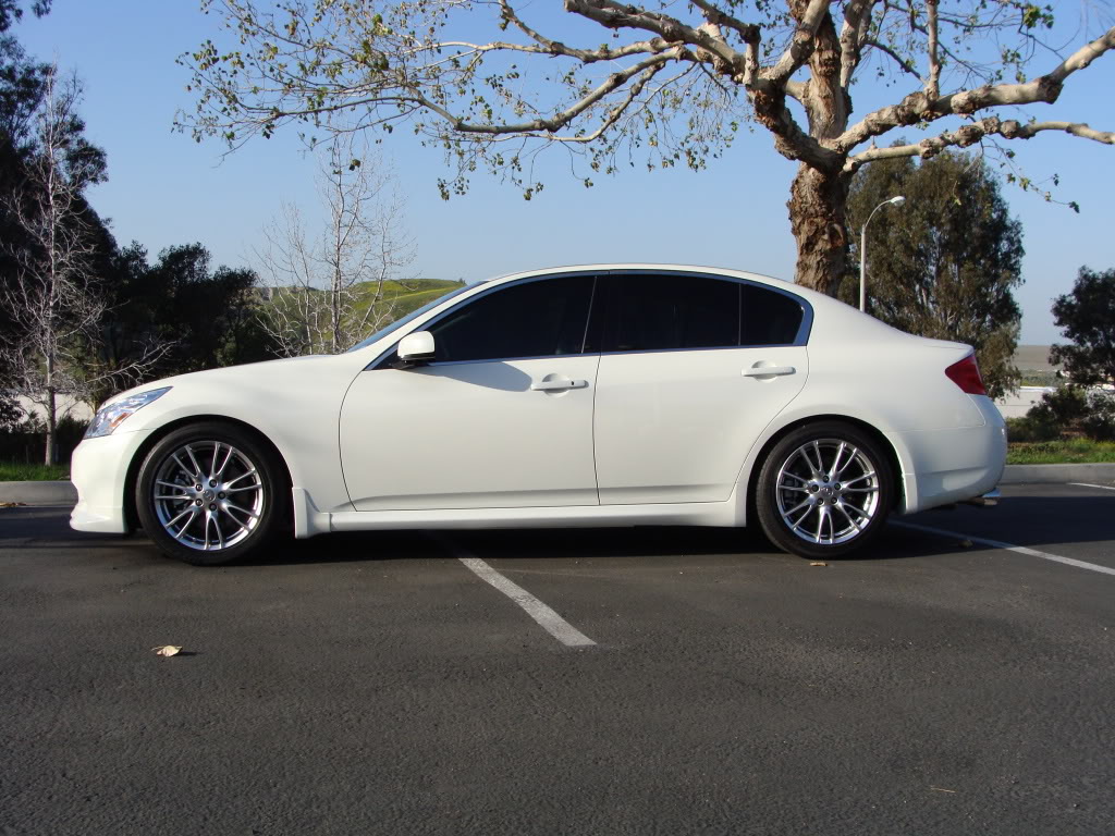

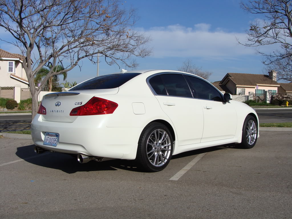

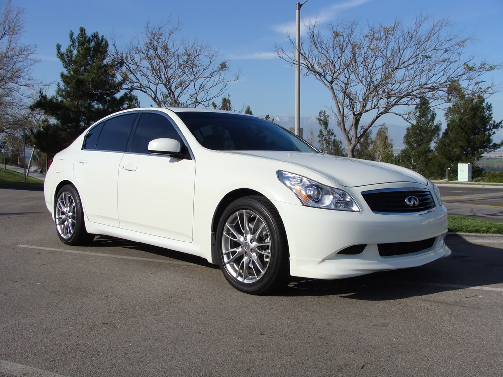

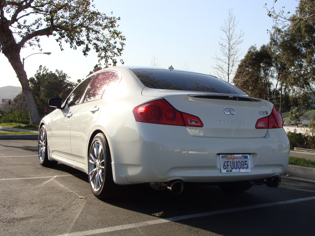

And a bunch more pics of the car with the Tanabe springs installed:

Originally Posted by boss81
Look really good Adrian. I wish I could get my springs that close in measurment
Thanks, Will. I'm happy with the drop so far, but not necessarily happy with the ride. The springs actually seem "softer" than the stock set-up, which actually makes the car a little bouncy. I think it's partly because of the progressive spring rates, which start out soft, but get stiffer as you compress them.. because the car feels great around the turns and over small bumps, but on concrete highways and over expansion joints it just seems a little too bouncy to me... maybe it's under damped now.. I just love the way Travis' cr rides with his TEIN coil-overs, so I will probably end up going that route in a few months once they become available.
FYI... My RF is still a little higher than the LF. Here are my final fender-well height numbers after the drop:
LF: 27.2"
RF: 27.4"
LR: 26.8"
RR: 26.9"
All are well within a 1/4" of eachother and the differences are petty close to what they were with the stock springs, so the actual drop was almost equal all around.

THIS KIT IS AWESOME FOR THOSE GUYS COMPLAINING HOW EXPENSIVE IMPULS ARE!!!!
otherwise, excellent job man, looks great!
Only thing that doesn't make sense to me is that the Tanabe's (on other member's rides) have a sagged rear end while yours seems to sit level.
Did you use boosters/isolators???

From: Toronto, GTA north
Originally Posted by johnnyzee
sorry for the caps but:
+10000....
Damn Adrian, they worked out great!
I hear you about progressive spring rates; I've never been a fan.
I am totally confused though
Did Tanabe change the design specs or something????
Other guys have installed these & got a real saggy a$$ stance.
I want this stance right here!!!!!
