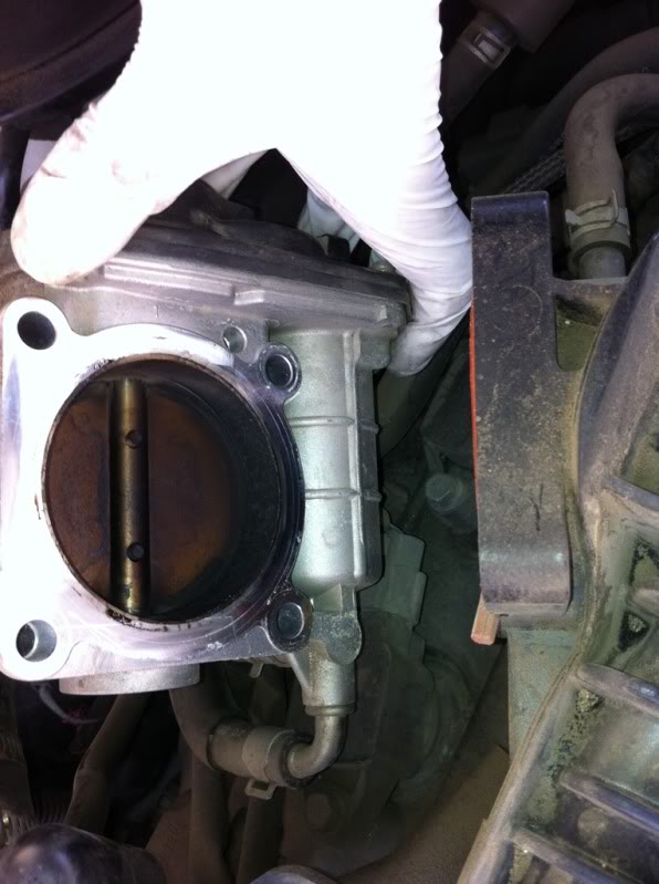

ok i took the leap and cleaned my TB's today... couldnt get the TB off, because the hex bolts were on tightly against the plenum. i ended up removing the intake and cleaning the TB with the plate held open with a finger. it was FILTHY beyond belief, and i cleaned as much as i can. The car was off, battery was not disconnected.
after i did both, knock on wood i had 0 issues. I drove it around, only difference i noticed was that engine braking would occur while slowing down (not in DS mode) but i am sure its the ECU learning my habits. The RPM is staying around 750-800.... rock solid, with no irritating blips.
props to the OP, this DIY saved me money and got rid of the RPM issue i was having. Throttle response seems to be better too.

I cleaned my whole intake system today, Throttle Bodies, MAF sensor and my intake tubes (I cleaned my spare set of filters as well but I'll leave them drying and install them in a week or so.
So far no issues, but the car had one hell of a start up lol
Before
After
