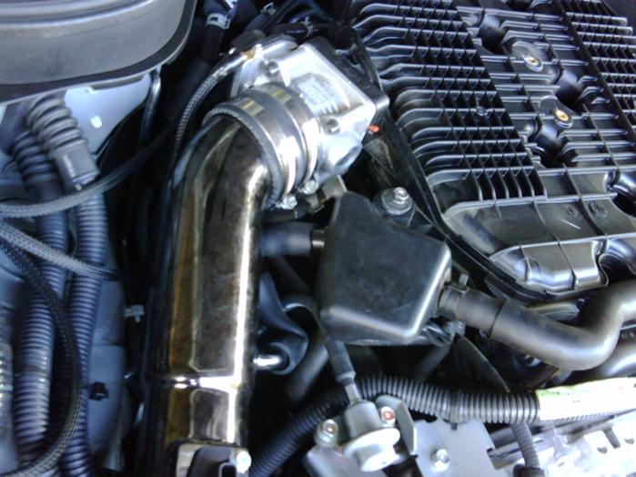

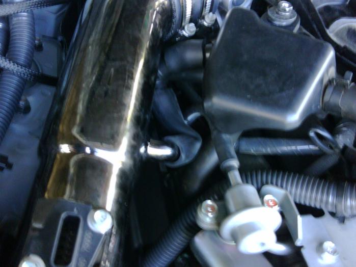

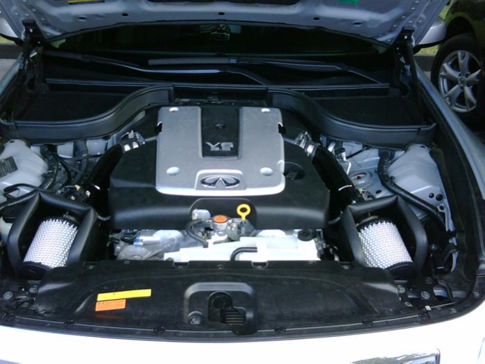

i just installed the R2C. Everything looks great and sounds great. I ran into one small problem though with the passenger side hoses. It still does not fit 100% and even with the 90 elbow fitting included and trimming the hoses. The hose kinks horribly because of the angle it has to bend. I informed R2C and waiting for a response. I had no problems with the driver side.

I had a similar issue with my drivers side hose but realized I made a mistake. Bat if you take a look at the picture of the passenger side intake you will see what step it looks like you missed. I don't know the name of it but that box connected to the hose need to go. Hope you can figure out what I mean with my terrible explanation.

i removed the driver side "box"(resonator) that you are talking about, I didnt think this one had to go, but it does? It would make sense....

oooooooooooooooooh, so that little black plastic box/resonator? in the middle of the first pic I posted above, needs to be removed and bypassed? that would make sense....

Yes Sir! that is exactly what I was poorly describing. Loose that thing and you should be all set, besides that I hope your loving your R2C as much as I am.

thank you! makes perfect sense! ill take care of that little issue in the morning and be on my way!

fixed and no kinks!
