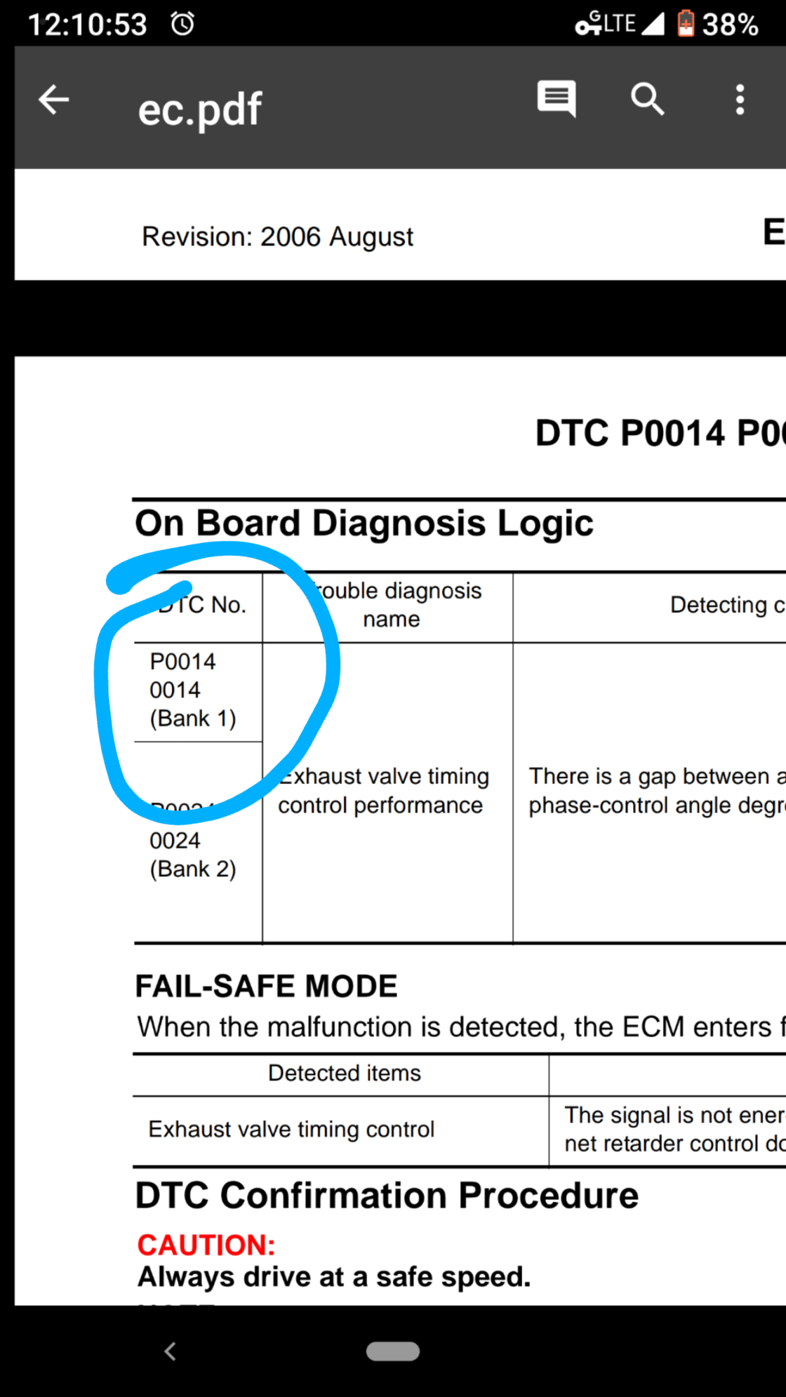

I know this is old but I'm having a P0024 code come on for camshaft position timing. I have an 08 G35 AWD which side is bank 1 and what side is bank 2?
I heard bank two is driver side and when I go in to check I see 2 sensors side by side behind the throttle body
Old Nov 22, 2017 | 07:41 PM
cleric670's Avatar
BANNED!!!
Joined: May 2017
Posts: 14,837
Likes: 2,497
From: Washington State
Coupe 6MT Premium RAS
Bank 1 is always the side that has cylinder number 1 (for ignition purposes). In the case of our vehicles cylinder one is the front driver side cylinder.
Bank1 = driver
Bank2 = passenger
It can vary from one manufacturer to the next, when in doubt look up the firing order for the correct answer.

I know this is an old thread but I am having the same p0014 code in my 2008 g35. My scanner says 'B' cam shaft position- timing over advanced or system performance. Is B side drivers and passenger? i want to order the right part. Any help would be appreciated. I cant locate video on it and am wrenching it myself.

Your scanner is giving you misleading information. Refer to the FSM for correct info.
