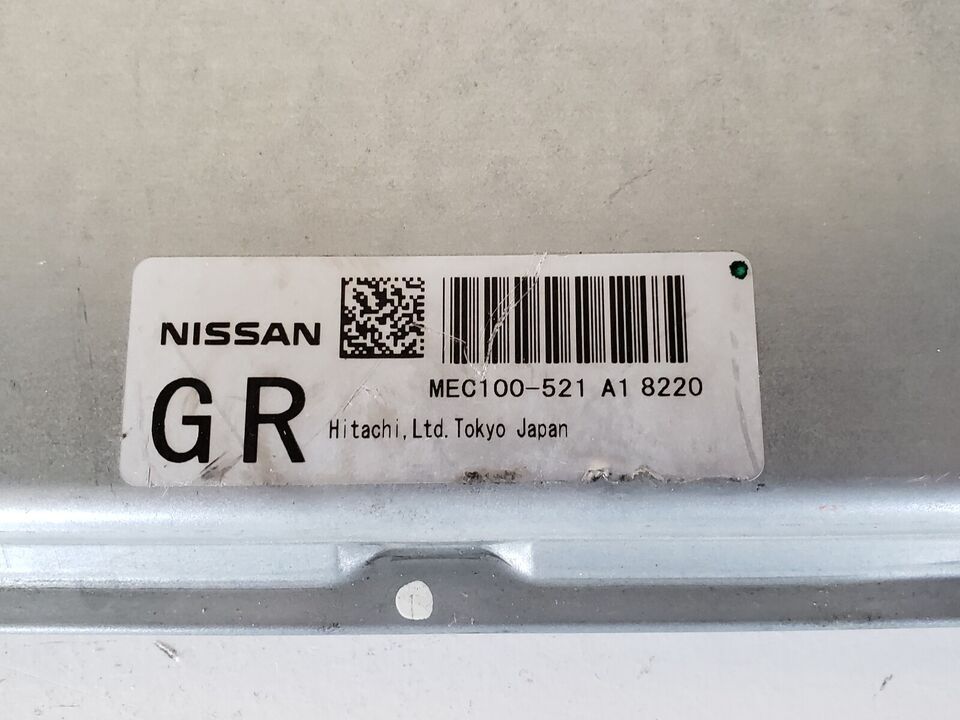

On the current topic, I've replaced the ECU with a 08 one, used Consult 3+ to rewrite the VIN and did the immobilizer relearn and same crap. Same stupid long starts.. The last thing i can think of are the t-bodies, one of them might not be opening during starts-ups? I'll pull off the hoses and check but idle relearn check out fine and rpm is good, TPS shows all good also.. I don't know and i guess i'll just leave the car as it is..
ECU from 2008 G35 Journey.
2008 G35 Sedan V36 ECU file number. 08 is 23710-1NA0D 07 is 23710-JK61E

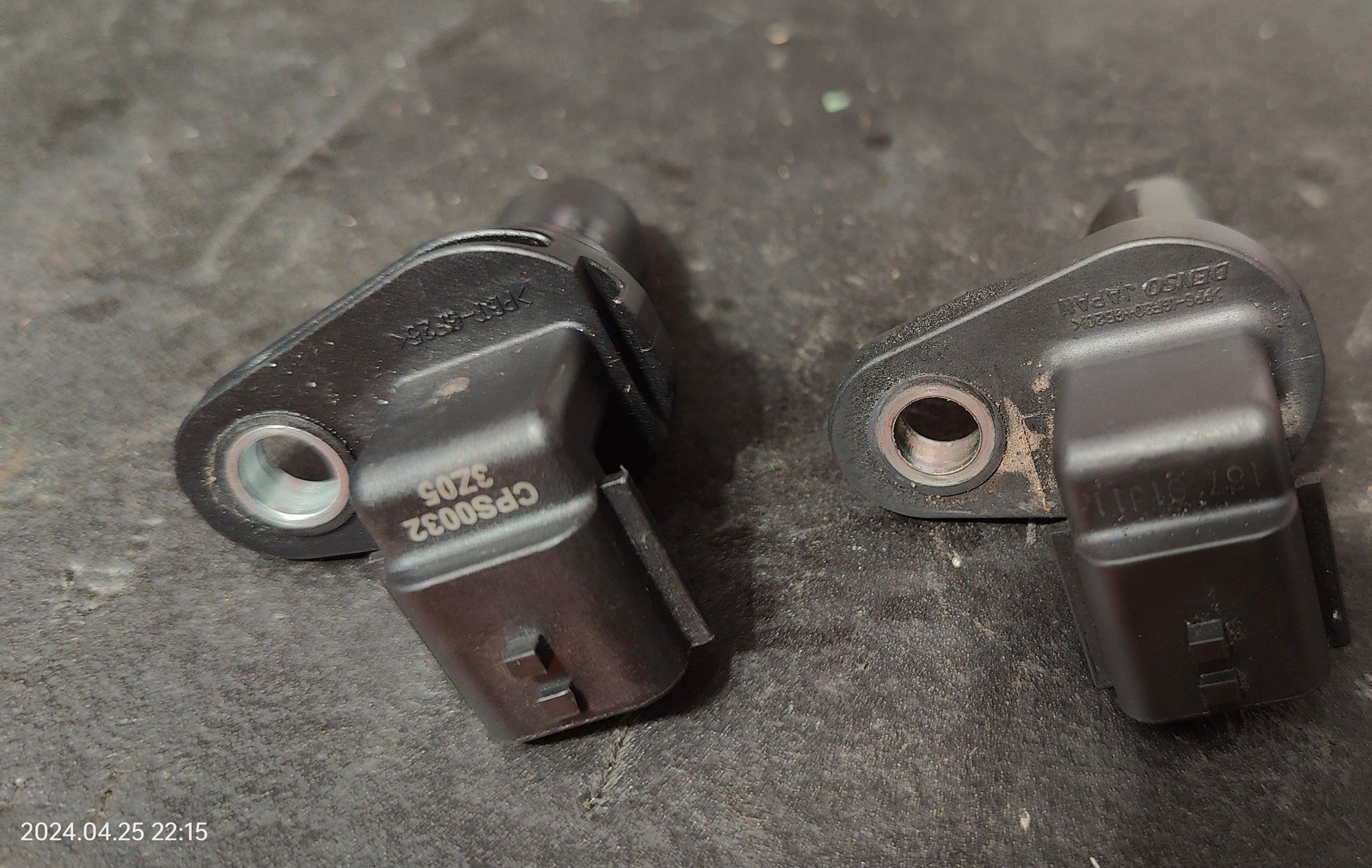

April 25th 2024 is the day I finally solved this bizarre issue.
2 weeks ago I was driving (fast) actually i was racing a hemi challenger on the highway, yes the challenger won because my SLIP light came on at around 140mph and my engine went to limp mode. I was able to stroll off the highway to the side of the road, connected my xTool D7 and saw this:
CAM sensor issue Bank 2 (driver side) Same code today as it was 2 weeks ago.
The infamous P0345 driver side (Bank 2) cam position sensor issue and there are 2. Would of been nice to know which one!
So i've erased the code and car ran fine for the next 2 weeks until tonight when the same code came up and no, i was not racing, i was actually driving home doing about 60mph and the SLIP came on, transmission started to not upshift and HARD downshift. I had to use manual shift mode to shift it up or down. Luckily i was 2 minutes from the house so i've erased the code and car drove fine to the house.
Getting 2 of the same codes in that timeframe is suspicious so i took out all of the 4 Hitachi sensors out of the hot engine and measured the resistance across pins 1 & 3, 2 & 3 and 2 out of 4 were the same but the other 2 had different readings, one was waaay off in MegaOhm scale when it's supposed to be in KiloOhm. I've measured my old Denso sensors and they all had the same readings at room temperature so i waited for the Hitachi sensors to cool down to room temp and measured them again and 2 out of 4 had same readings (close to Denso) and 2 were out of serious range. So I've installed the old Denso sensors and wham bam 1 second engine starts right away! No more long embarrassing cranking times for this Gr33n G!
The reason why i changed the cam sensors in the first place was because i thought they were the cause of the crappy start ups at the beginning of this post and that was the fuel pump issue. I've read many posts on here and other forums that Hitachi is the brand to goto for VQ engine sensors, i mean, the T-bodies are Hitachi! But after looking at the box itself, i've noticed the glorious words, the words of the future: Made in China..
I've read few posts on here that talked about Hitachi sensors being cloned in China and being fake but i wouldn't think that RockAuto would sell that crap???
So, to conclude this dreadful post, DO NOT PUT ANY HITACHI SENSORS ON YOUR VQ35HR ENGINE! Use Denso instead and make sure they're made in Japan.

Here is the measurement of both Shitachi and Denso Camshaft and Crankshaft sensors:
Camshaft Sensors:
Looking at this photo, Pins go from Left to Right 1, 2 & 3. When the sensors are HOT, you'll get readings on pins 1 & 2, 2 & 3. When Sensors are COLD or 75 degrees and below, pins 1 & 2 will not show any readings, but pins 2 & 3 will and you can see the MAJOR difference. All Denso sensors are +/- 2% in difference. Pull them out, let them cool off in the house and check the resistance across pins 2 & 3 as shown above and compare. Also, check the Crank sensor, it's located in a very bad HOT spot where the pigtail can get brittle and lose connection.
Hitachi CPS0032 on LEFT, Denso 167 01J11 on RIGHT.
