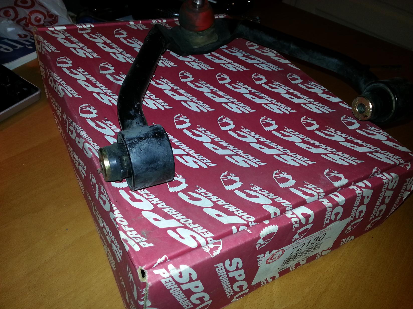

Has anyone replaced the bushings on the SPC front upper control arm/camber kit #72130? Mines wore out after 4 years on my 2nd gen g35. Any info would be much appreciated.

are those solid bushings? if not you can get the poly bushing from Energy Suspension or whiteline. i picked up the whiteline ones and cant complain.

By any chance, were they originally tightened down with the wheel off the ground and the suspension uncompressed?

hurleyguys, Thanks for the reply. Those are the rubber bushings that came with the spc control arm. They look bigger than the ones on the stock control arm. Would u happen to know the model# for the whiteline that i can replace them with?
vqsmile, I followed a DIY from the forum and tightened the control arm with suspension loaded.

on the whiteline website it looks like the W52988 bushings are what you are looking for.

Is the bushings on the SPC the red ball thing?

That's the ball joint
CZP sells them for $75 each
