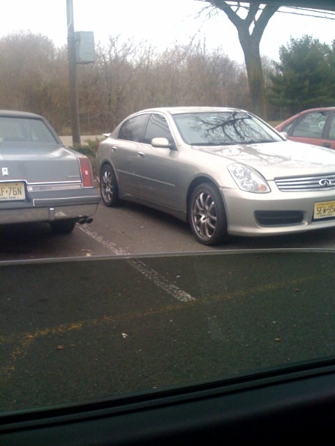

^Any pics showing how your tires sit in comparison to the rear fender?
Not really, but here's what I've got:
Attached Thumbnails Another sedan on Coupe 19" but with stock height-coupe19s.jpg
