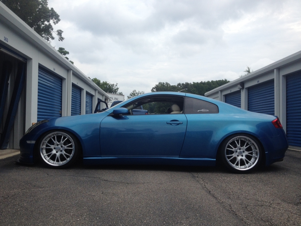

Had to post up the final product from all the help from Drew x2 and Blain, thanks again!!

I lyke. twas a longggg wait. you come back in october?
when you plan on getting new coils? new rear bumper?

Yeah should be early to mid october i come home!! Pretty excited about it
After i see how much lower i can get the megans to go in the rear after taking out one of the rings i'll see if i wanna get Stance's....fronts i can go lower still to get it perfect but the rears are maxed (right now at least) That splitter is somewhat stopping me from lowering the front though hahahah
I don't like any of the rears enough to get one...i love the stock rear with splashguards and will probably get the nismo diffuser to line it up right

I was lower with a Kuruma...which I guarantee was lower by itself than nismo and a splitter. I live in a low car's wet dream in south orange county tho. roads are flatter than flat. I wouldnt risk it if I had to pay full price on splitters. lol.

haha yeah i mean i don't complain about the sh!tty roads here in Virginia but even now with how low i am and with the Nismo and splitter on there my wife said she could fit her foot up underneath haha soooo there really isn't much more to go being static at least
looks good!

Thanks blain! stance isn't dialed in yet but will be soon!
