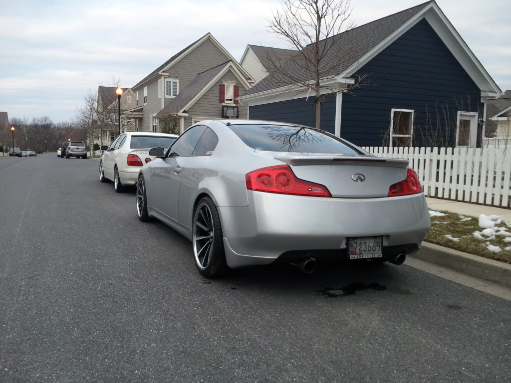

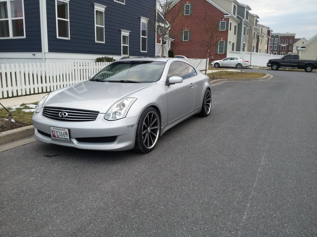

Originally Posted by LoSt180
Thanks. I'm looking at some used rims that were on a G37, so the offsets aren't as aggressive.
The wheel specs for the wheels I'm considering are:
20x9+32
20x10.5+42
I currently have 20mm/25mm (F/R) spacers on my Rays and like how they sit, I'm not looking for any poke or that hella-flush style.
Looks like I would need to run 10mm spacers to match my current setup. 15mm would push out 6mm more than my current setup and would probably look nice also.
Originally Posted by Drew113
I'd say you could get away with running up to a 20mm spacer out back and a 15mm up front with that new setup and still run full size tires also
Thanks, moved the 20mm to the rear and picked up some 15mm for the front. So the effective offsets are now 20x9+17 Front & 20x10.5+22 Rear
Had to get the rear fenders rolled as I had some rubbing on hard corners.
Tires are 245/35 Front, 285/30 Rear

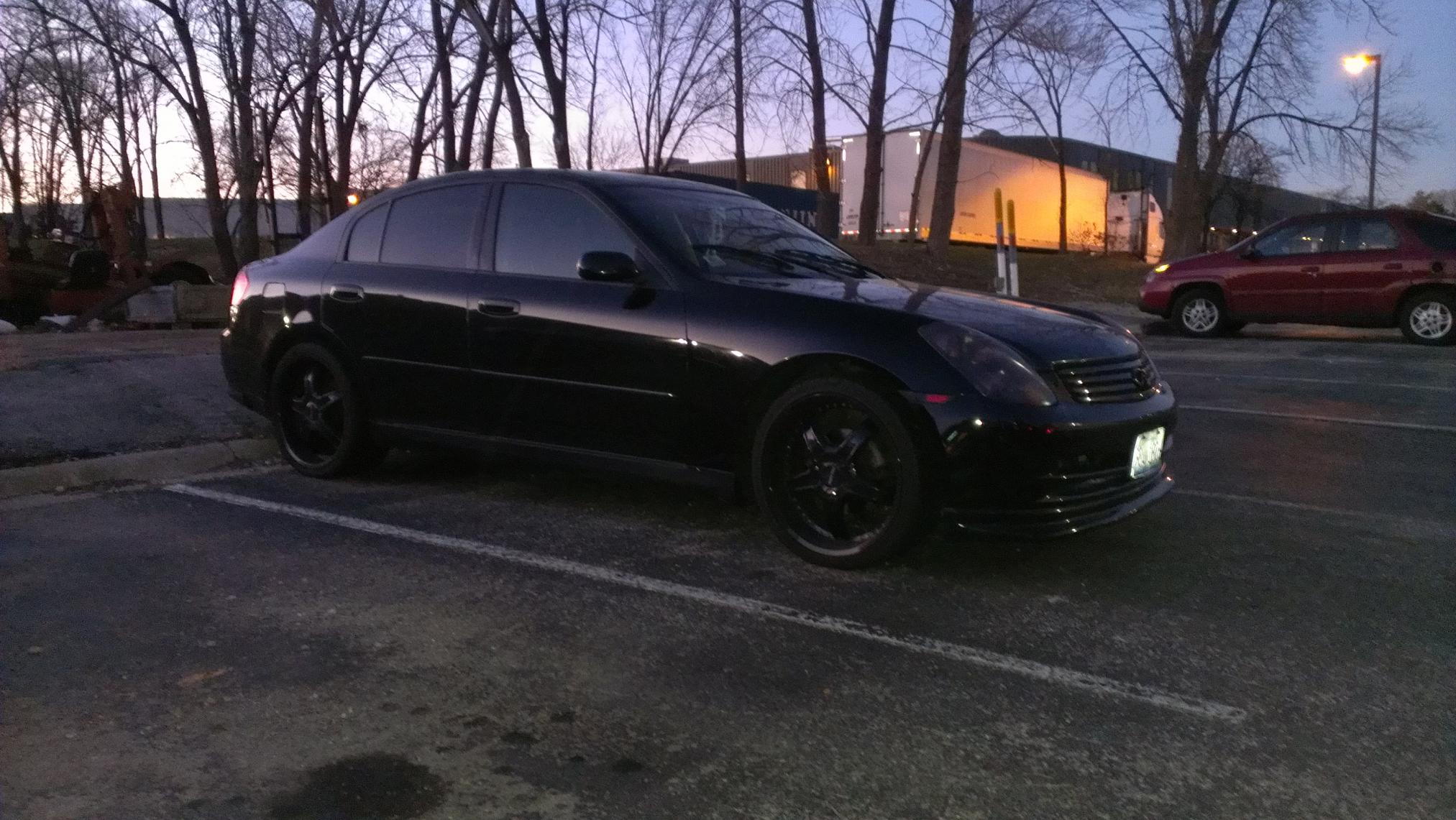

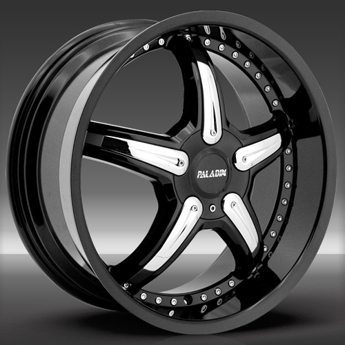

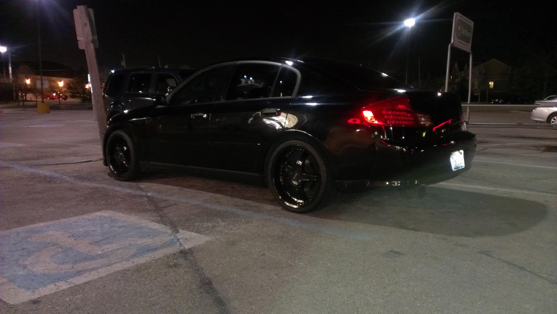

What do you guys think.about these 20's for my sedan? I got them dirt cheap buy think I'm going to sell them
Attached Thumbnails Have a Question/s About Wheels/Tires/Offsets/Camber/Etc? Ask here::-black_knight_171_black_-_chrome_inserts_large.jpg   Have a Question/s About Wheels/Tires/Offsets/Camber/Etc? Ask here::-imag0505.jpg   Have a Question/s About Wheels/Tires/Offsets/Camber/Etc? Ask here::-imag0635.jpg
Old Jan 7, 2013 | 08:56 PM
  #4960
TORETTO's Avatar
iTrader: (18)
Joined: Sep 2007
Posts: 10,359
Likes: 1,941
From: Auckland, New Zealand
dey ugly dawg
