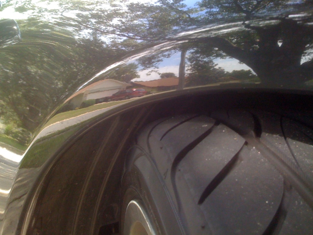

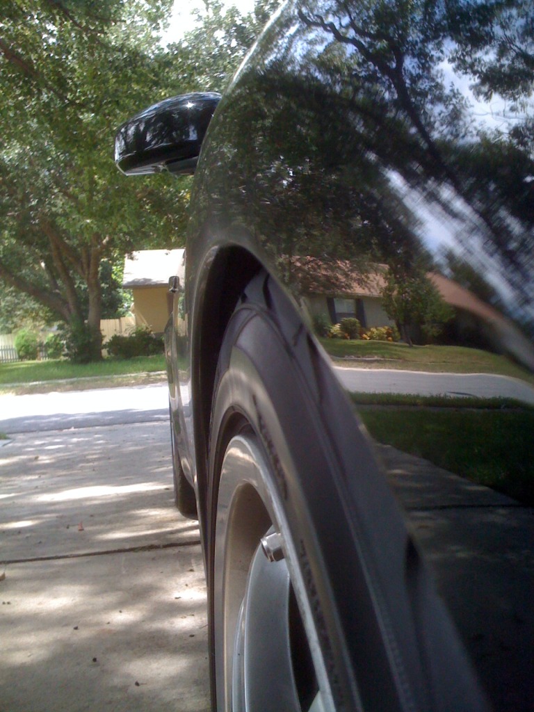

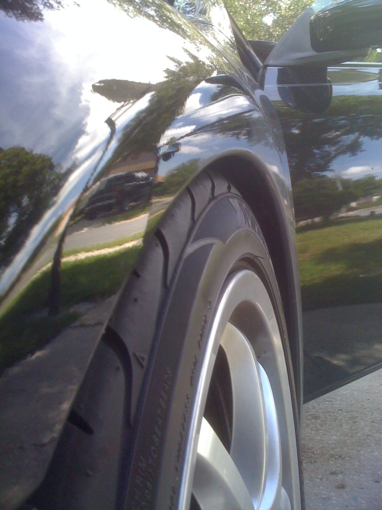

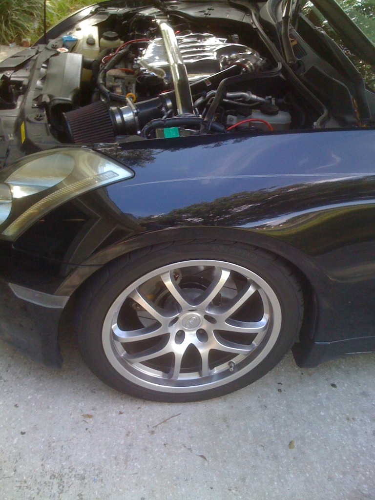

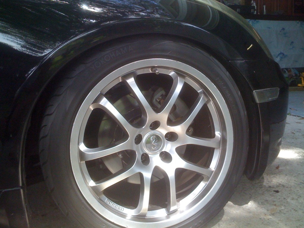

so i went ahead and test fitted the 245/40s up front witht he 20mm spaceres and wow... its close but they fit (about .5" clearance)
sorry for iphone pics

it will fit, but the issue would be VDC issues. your 40 wall might be to tall for your rear wall. 30/35 series wall.
Old Sep 18, 2009 | 09:27 AM
idrive_MD's Avatar
Joined: Feb 2008
Posts: 1,922
Likes: 12
From: Belcamp, MD
Yeah you are definitely going to want a 285/35 tire on the rear if you are going with a 245/40 up front. I think a rule of them is to keep the sidewall heights the same or at a delta of 5. I have 35 up front and 30 in the rears and its not causing me any issue...both tire sizes are supposed to be 26" OD on mine, but I have a slight stretch in the front so its realistically probably a little shorter than specs.
