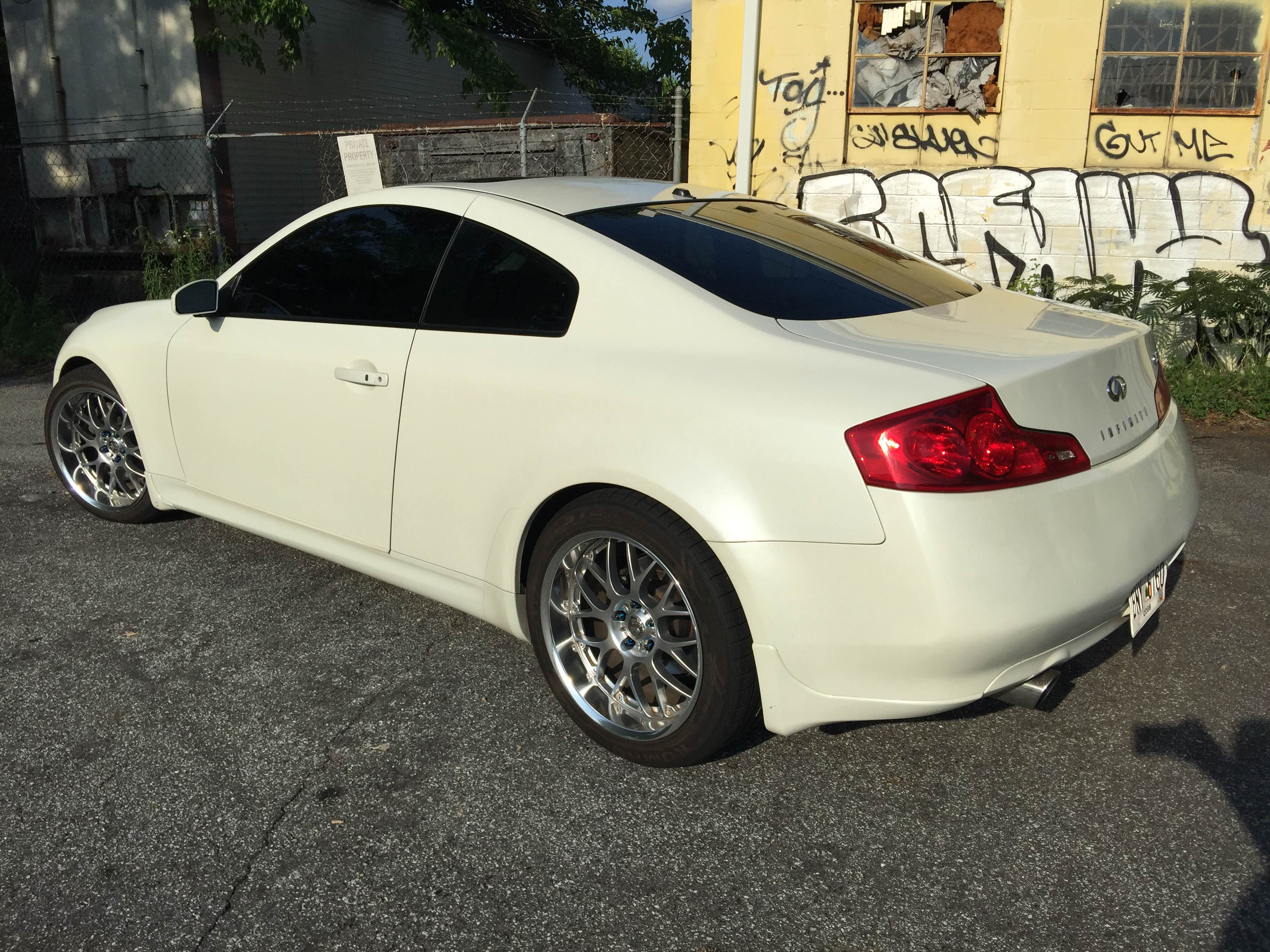

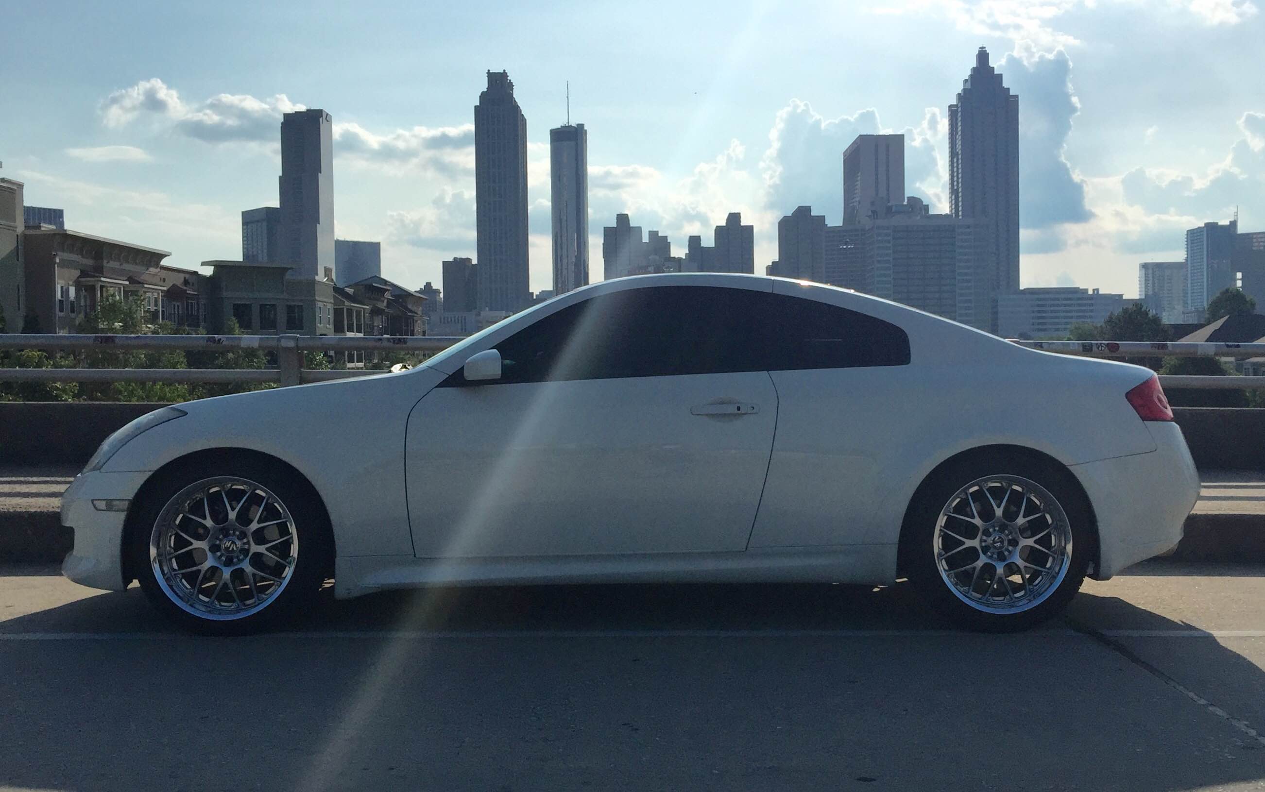

Well I finally got some new (to me) SF Winnings, thanks to Vu in San Jose who shipped them out to me! Here you go:
-07 Coupe
-Fenders rolled
-No spacers
-Fronts 19 x 9.5 +19 offset w/ 245/40s
-Rears 19 x 10.5 +17 offset w/ 275/40s
-Stock suspension
The tires came with the wheels and the rears were rubbing which is why I had the fenders rolled, I'll probably replace them with 35s once they need to be replaced. Now every time I look at my car I fall in love all over again! Oh and also I got the SR48 Burned Blue lugs with matching locks. They look amazing in the reflection of the sun!

Dude, you need a drop and a 35 profile tire in the rear...looks way too beefy

Great choice on the wheeels. Love the skyline shot. Is that atlanta?
I cant wait to see that thing dropped. Drop Drop - Drop it like its Hot(lanta)

Thanks SoCal! It is indeed Atlanta, nice guess! You can probably feel the humidity coming through your screen haha, I'll definitely drop it once I've saved a few more shekels, those wheels cost a pretty penny! But oh so worth it

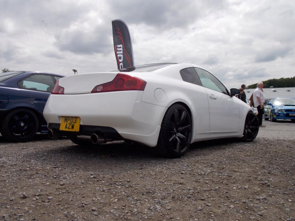

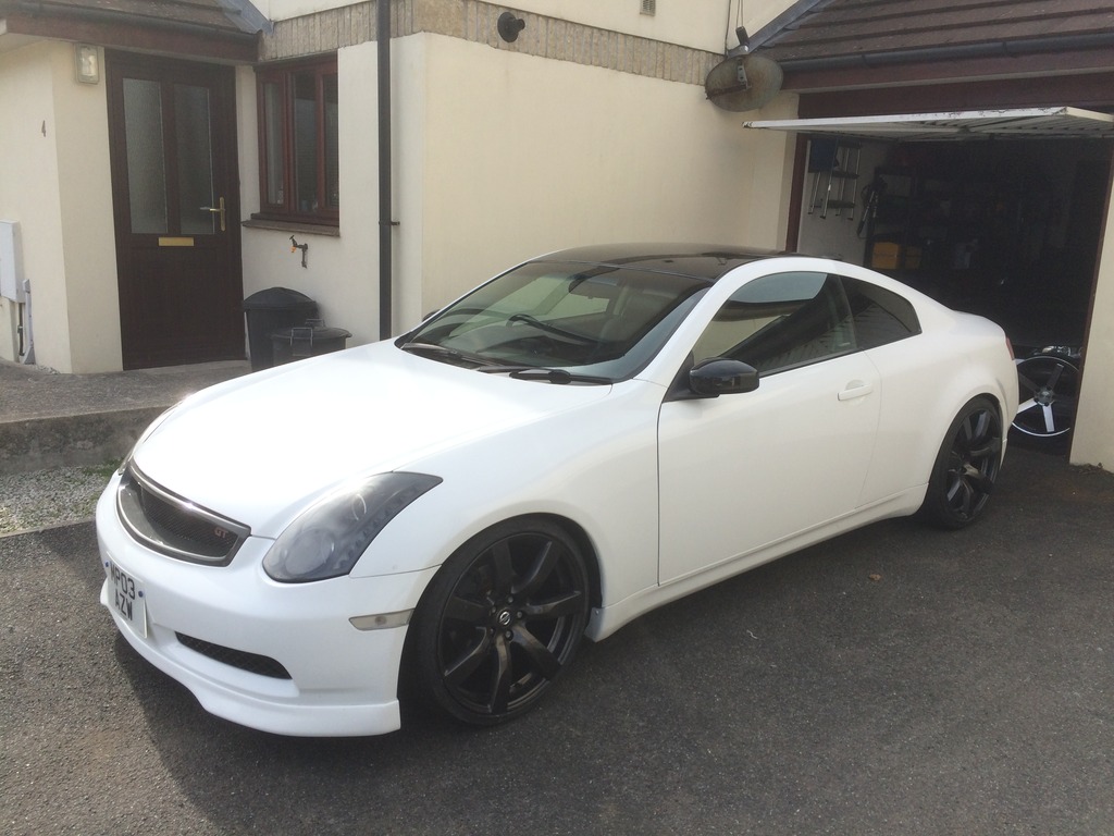

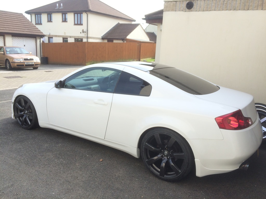

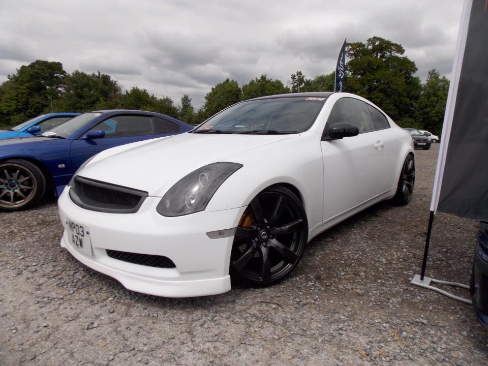

Coupe or sedan - Coupe
Fender work/modification - Arches rolled front and rear
Spacers - 20mm front only
Wheel Size - 20x9, 20x10.5 Nissan GTR factory wheels. Not sure of ET. Appx 40f, 20r.
Tire Size - 235/30/20 and 285/30/20
Suspension setup - BC Coilovers
Camber settings - Factory settings

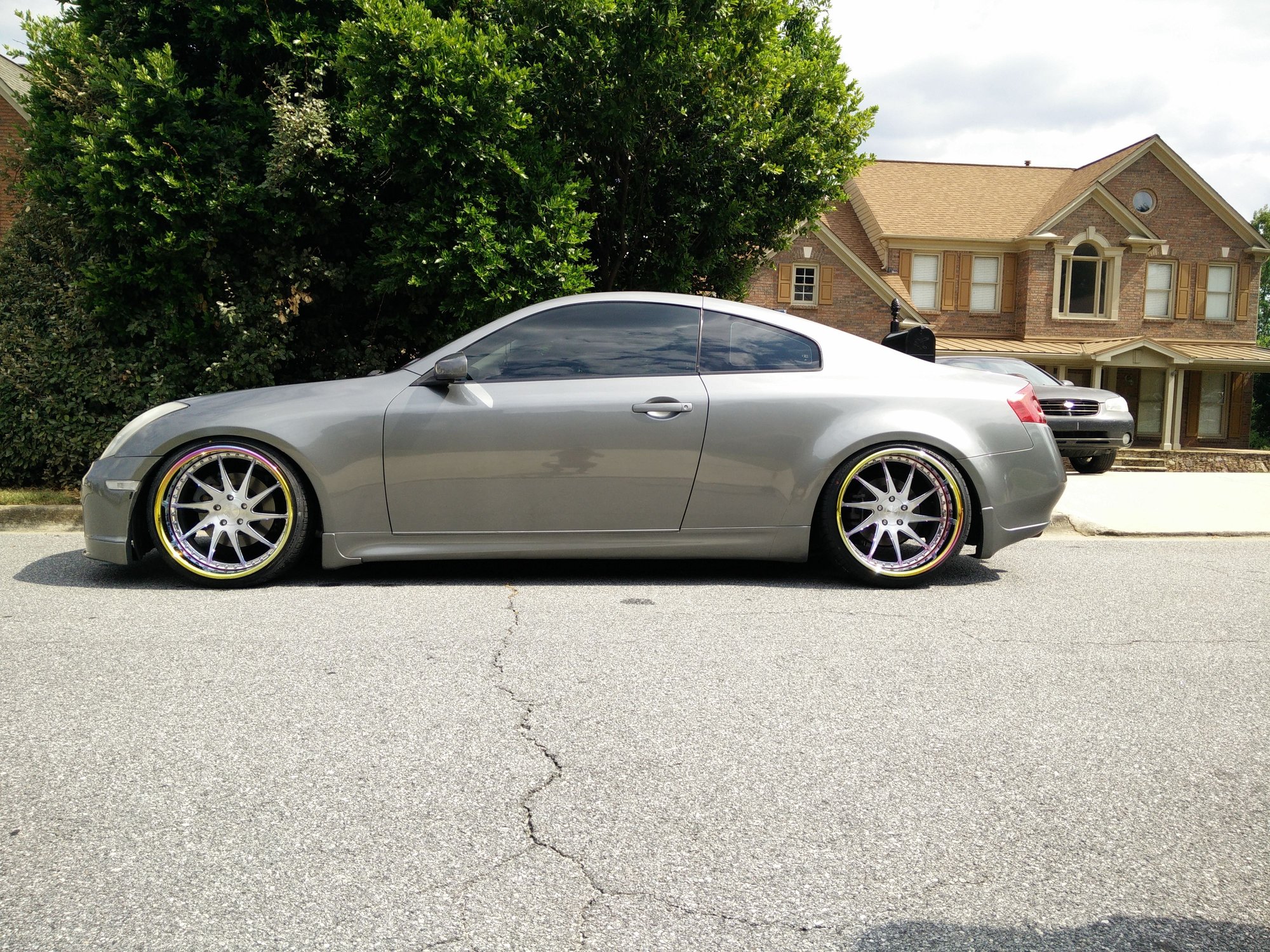

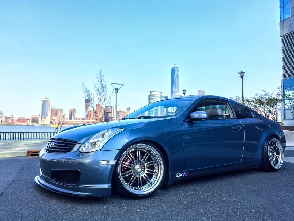

05 coupe
Powertrix Coils/SPC camber
SSR VF1
19x10-16
19x11-16
225/245 35
-3 camber all round
all four corners rolled
