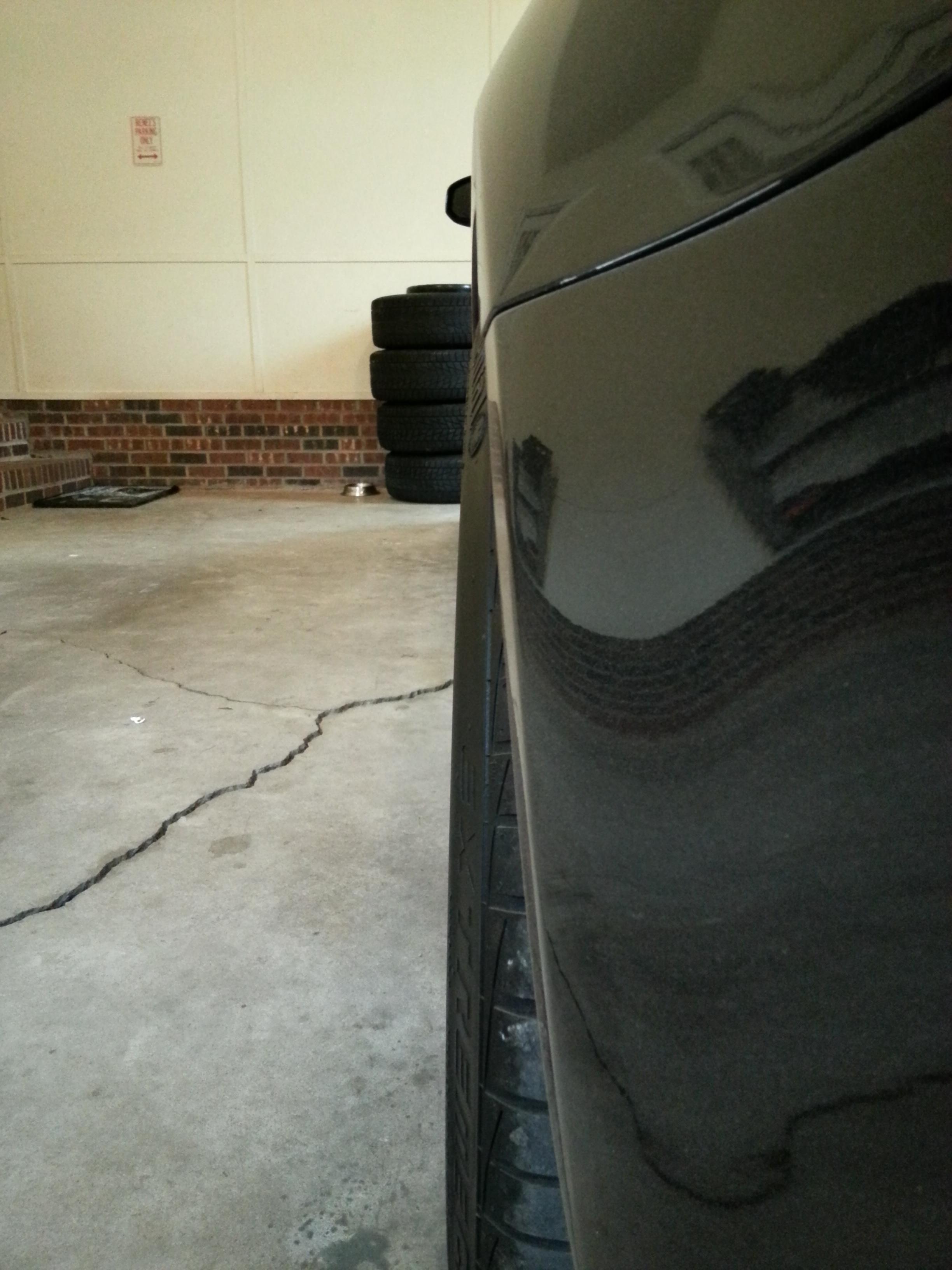

Originally Posted by RedHot6mt
Please post those pictures. Also, are you dropped and if so how much/on what?
I am way more aggressive on offsets than you:
20 x 9.5 (+09)
20 x 10.5 (+11)
I'd like to run 245/35/20 F and 275/35/20 but the problem is my Eibach Prokit drop of 1.1 and 1.0 has turned into 2.25 and 2.1 inch drop due to sagging springs and/or blown Tokico D-Specs. So I can't pull this off until I get some coilovers and raise it back up 1/2" to 3/4". I'm not a fan of stretched tires either but that's all that works for now.

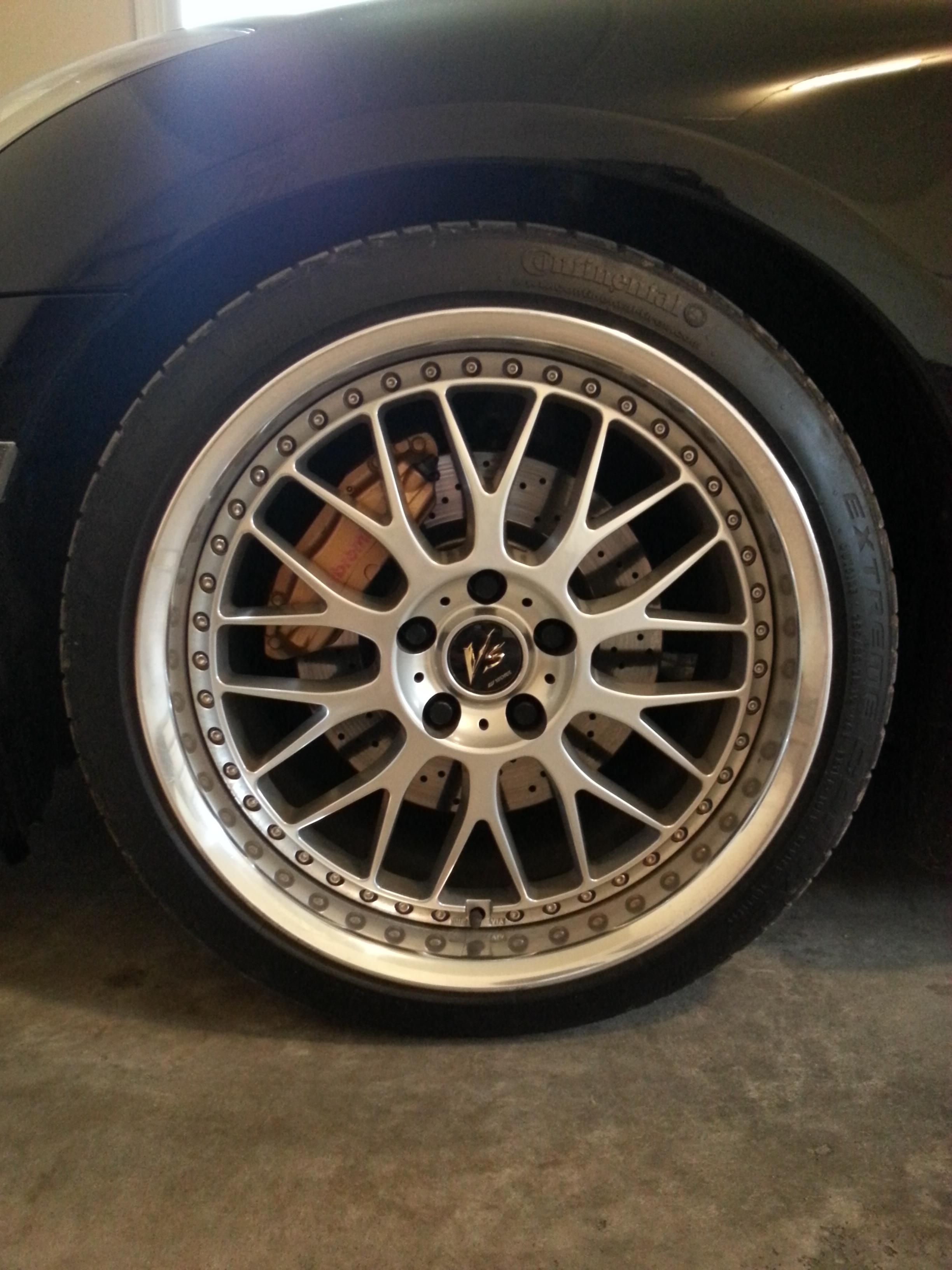

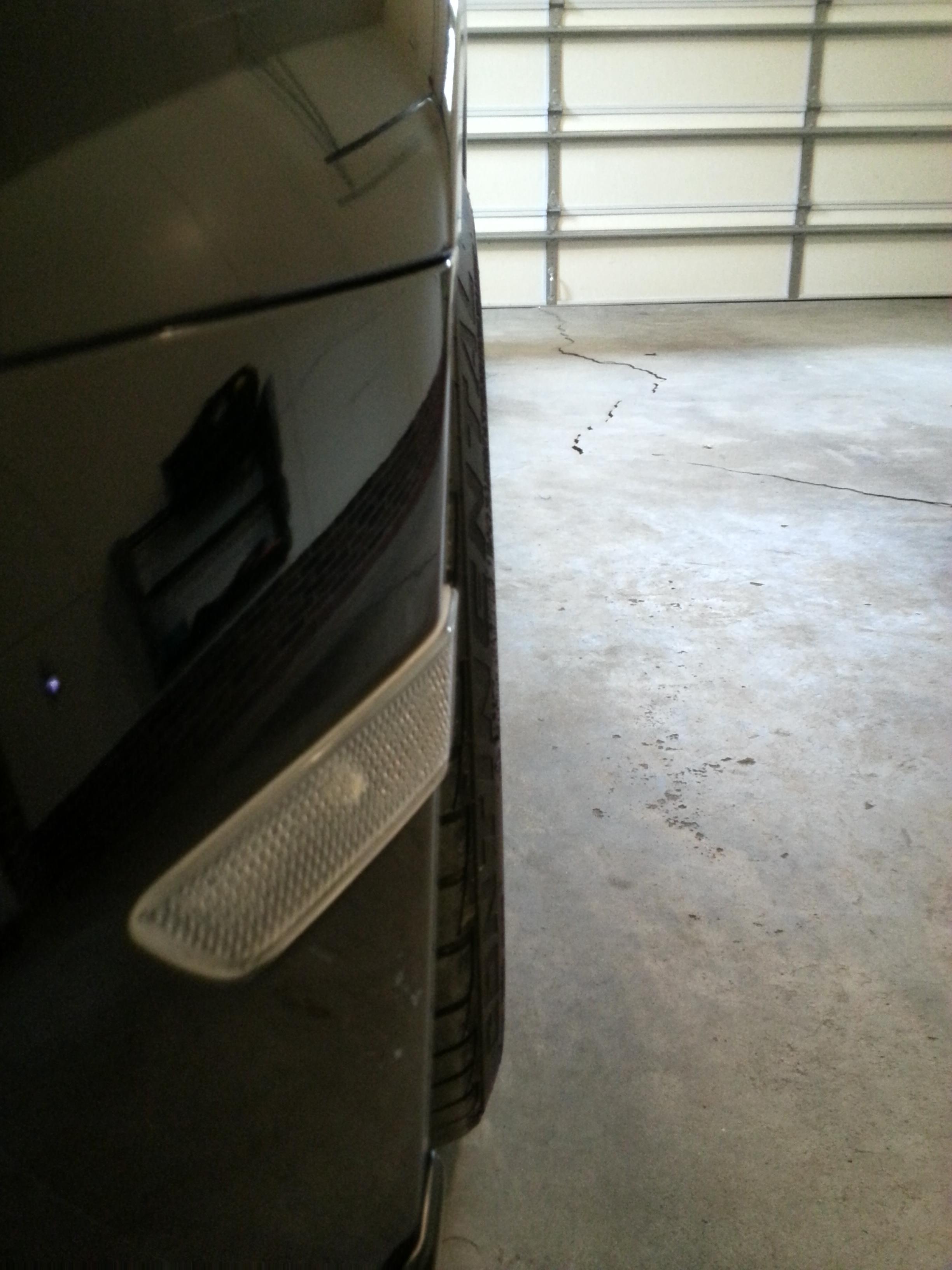

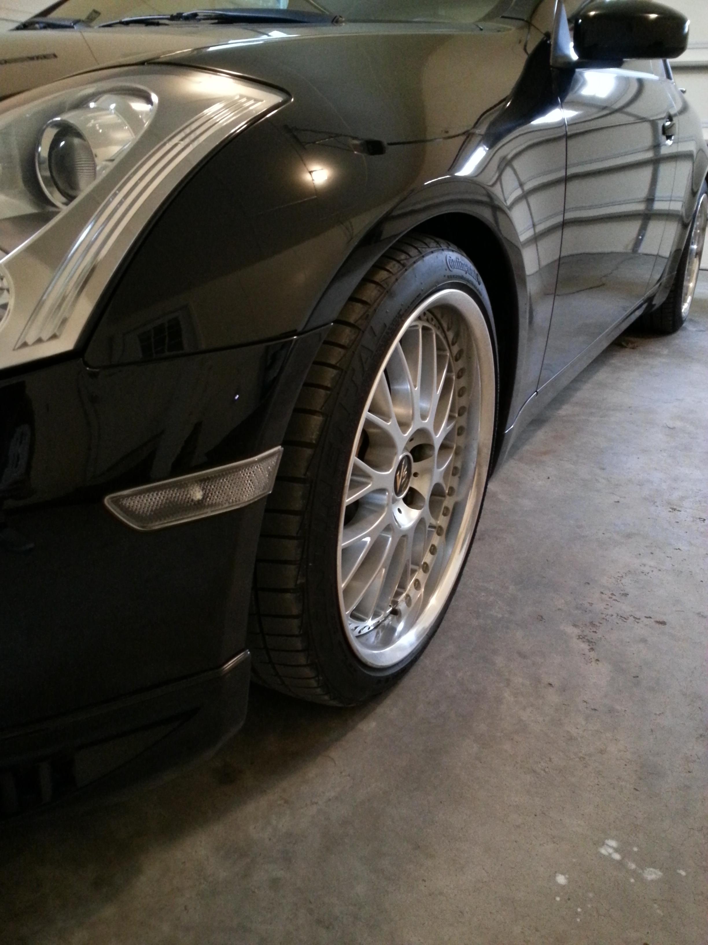

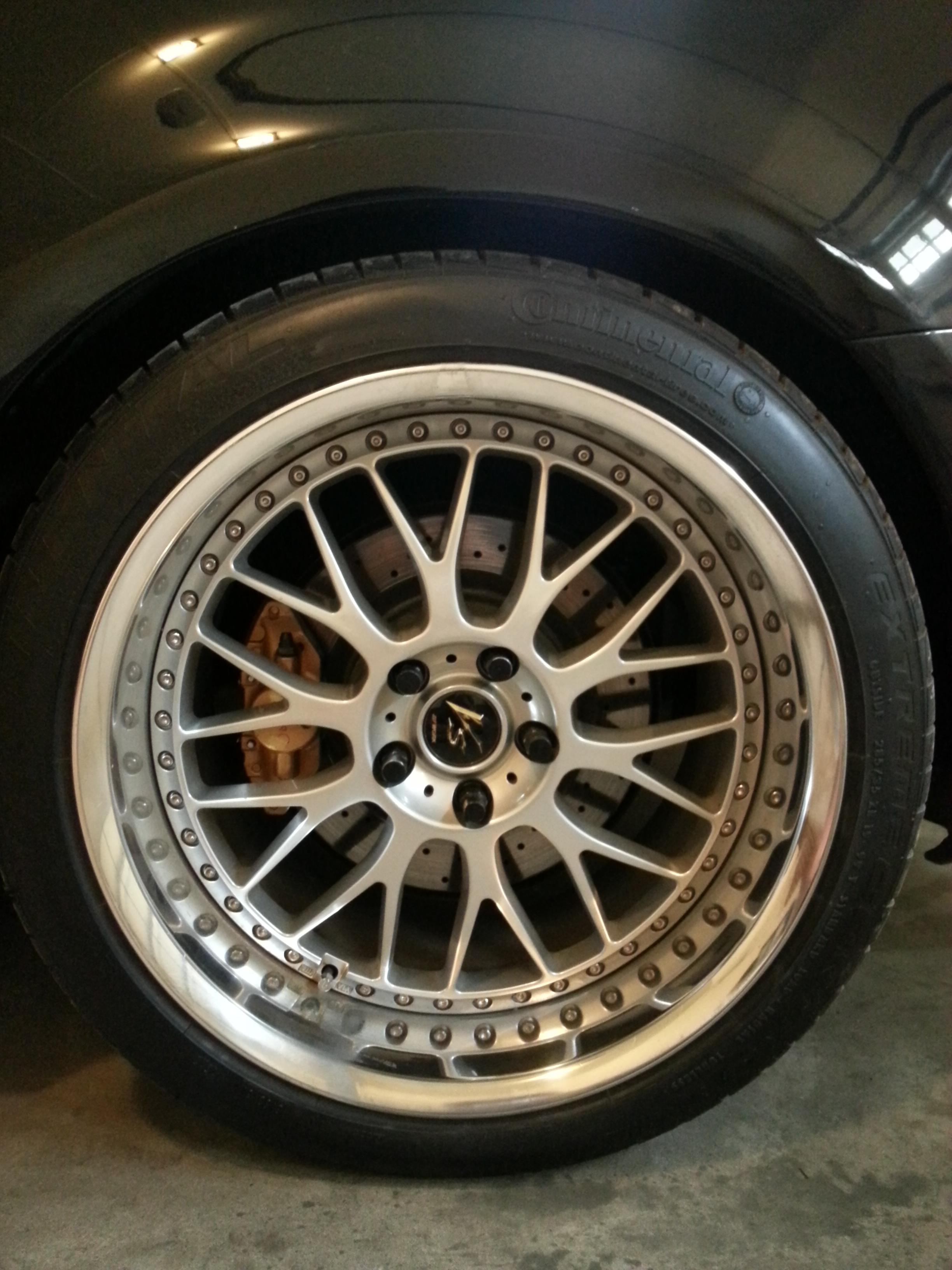

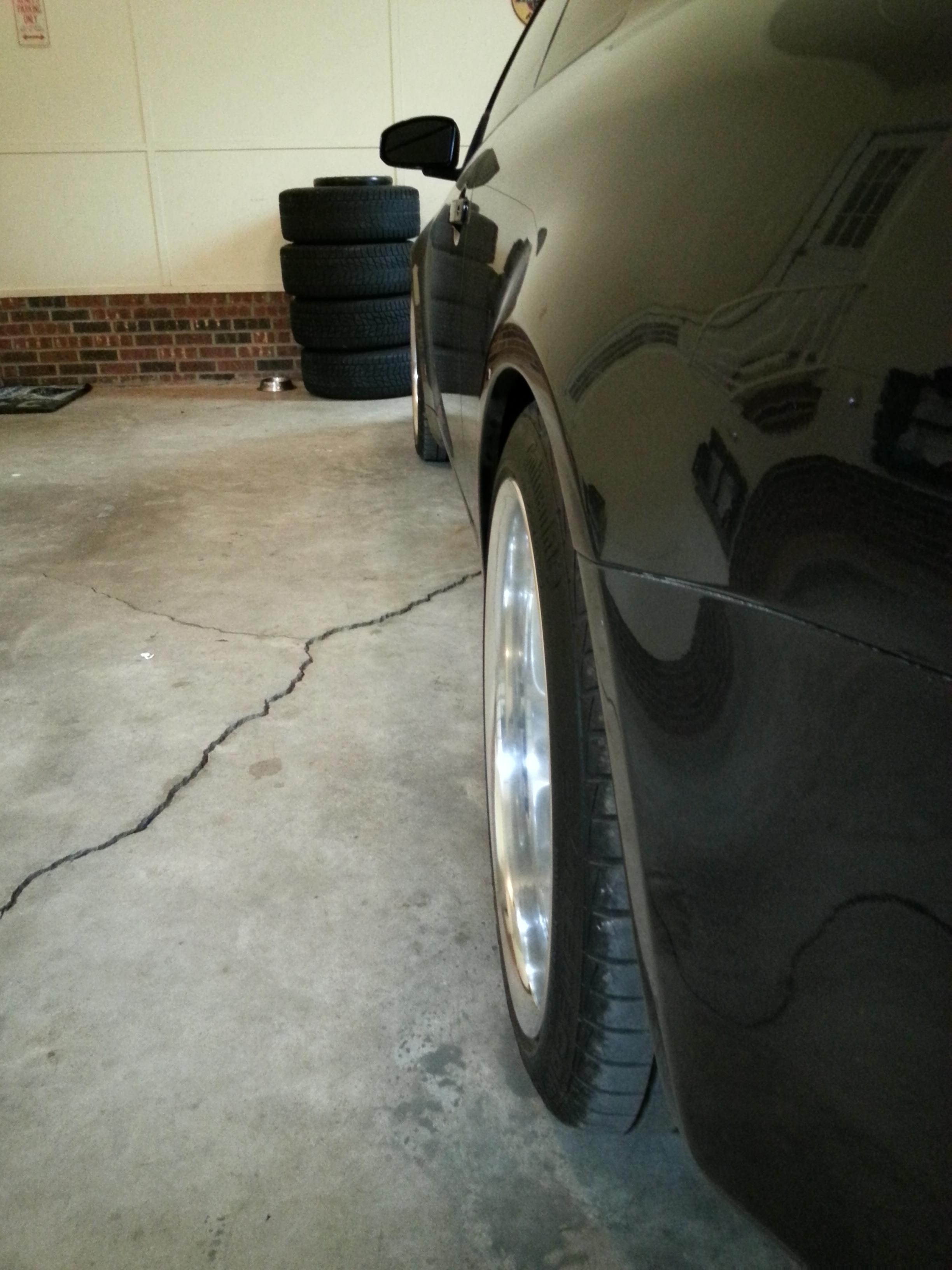

I'm on HKS HiperMax III's and idk how much of a drop it is. Here are the pics. Also, my sizes are 19x9.5 +28 in front on 255/35 and 19x10.5 +29 in the rear on 285/35.
FRONT
REAR
SIDES
