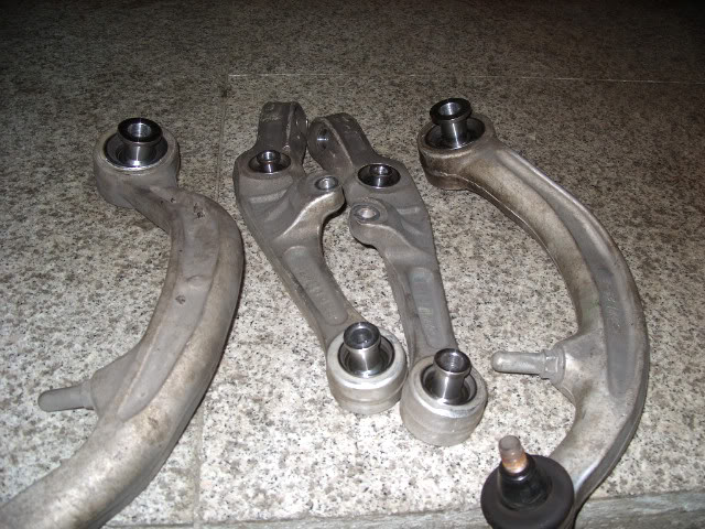

What is the difference between the "Lower Control Arm" and the "Compression Rod". I looked up both on google and they have photos of the same piece of equipment. Im just curious because I want to make sure I know what the difference is between the lower control arm bushing and the compression rod bushing. Im guessing in this image the compression rods are the ones in the middle and the control arms are the ones on the outsides?

The LCAs are the two in the middle and the comp rods are on the outsides. You would benefit from replacing the whole arm of the comp rods cuz you'll get new ball joints. But you'll still wanna go with poly bushings in the new rods. The LCAs you can just replace the bushings cuz there are no moving parts. Any time you mess with the height yer gonna want to align it. I wouldn't raise it til you get the new parts on.
