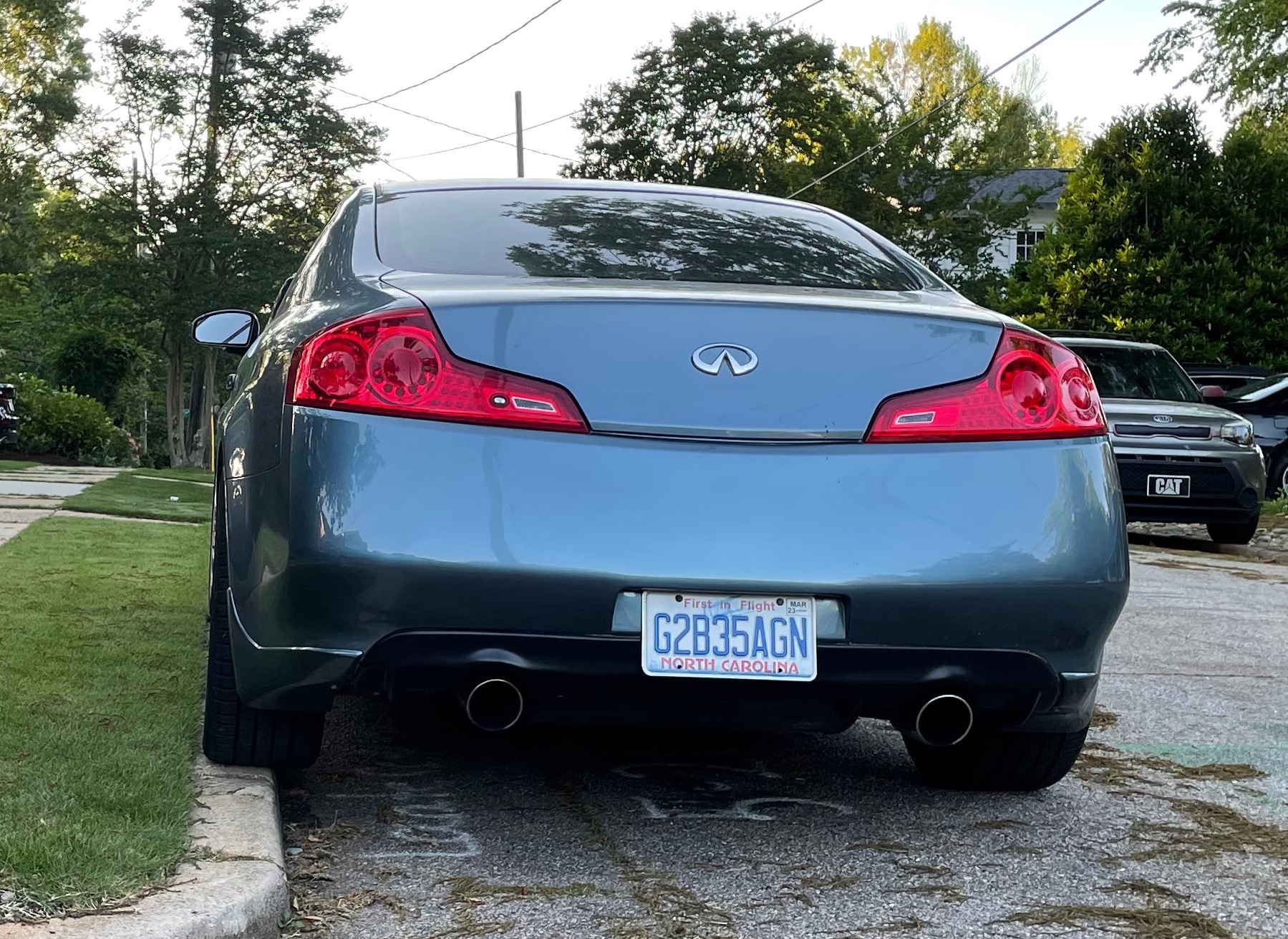

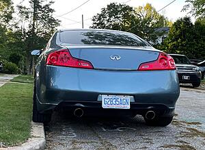

I have 20 front and 25 rear on my 06 coupe. Stock height, no issues with front fender. Also have the Brembo swap from 03-04 coupe. Very happy with the look. Car is filthy with spring droppings. Ashamed to take a pic, but I'll swallow pride and see if I can add one in a bit.

Here's the current setup.
Nice plate!

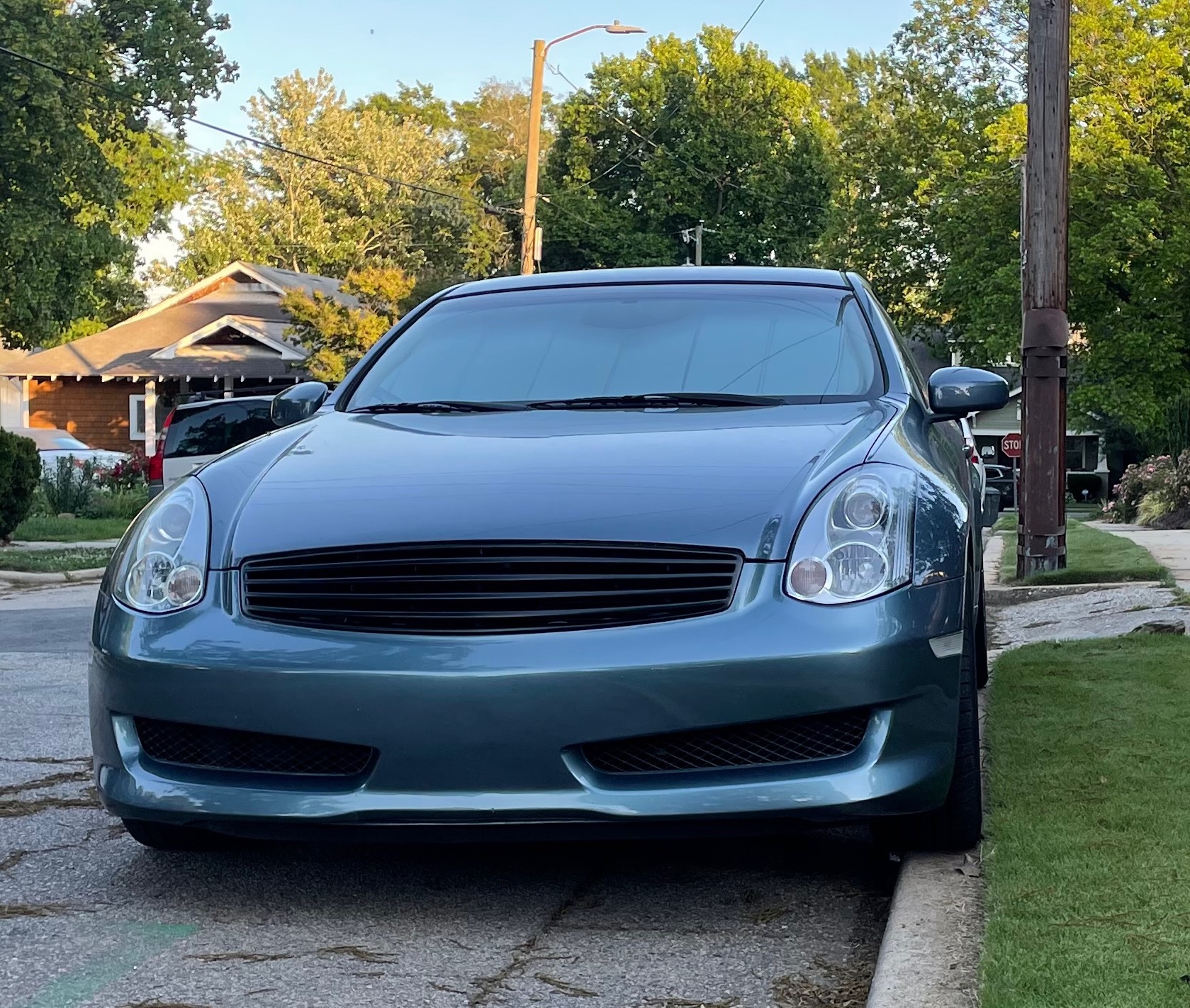

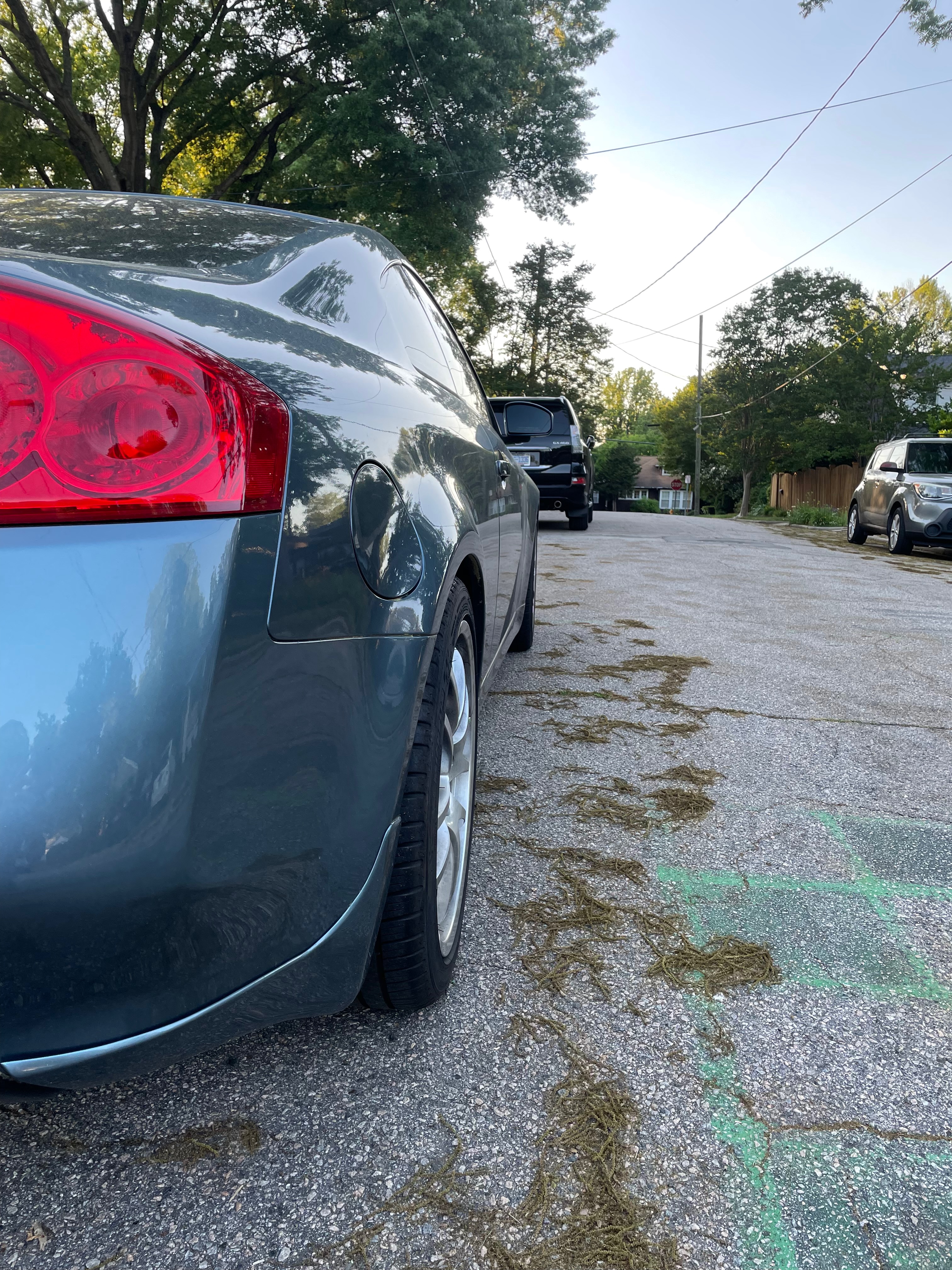

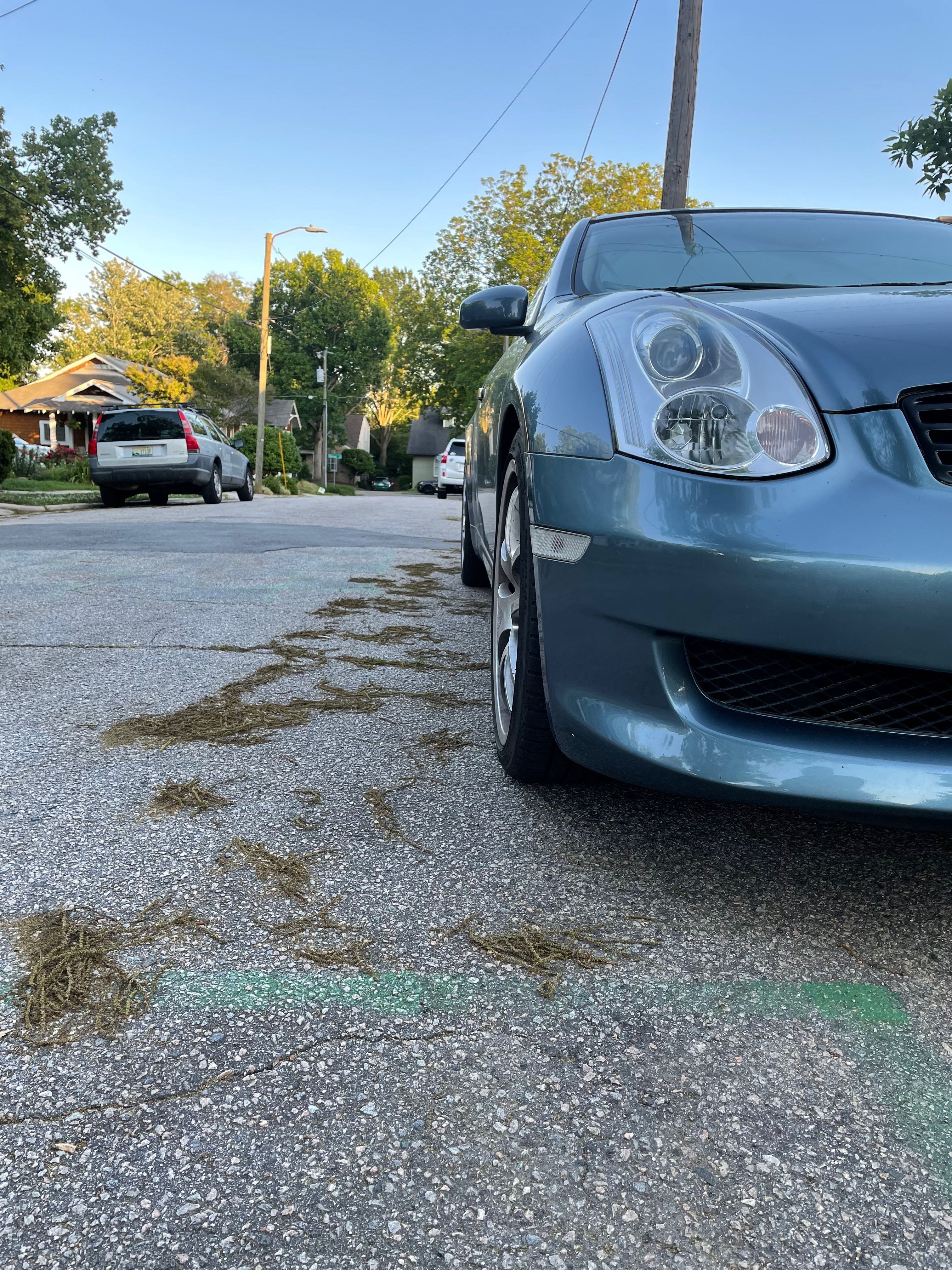

Here's some pics.
