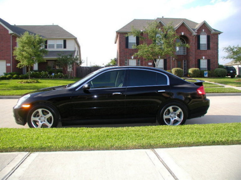

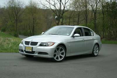

I would like to have a look similar to the BMW 330I sport in terms of the wheel size,tire size(width and aspect ratio), fender gap, and lateral positioning of the rear wheel--you cant do that with stock 17s with out major drop, and spacers and shoe-horning a wider tire in the rear and that is not safe to me.
Attached Thumbnails Should I go 18 or 19 inch wheels on 03 sedan?-f34_cw.jpg   Should I go 18 or 19 inch wheels on 03 sedan?-66.bmp   Should I go 18 or 19 inch wheels on 03 sedan?-78.bmp   Should I go 18 or 19 inch wheels on 03 sedan?-67.bmp   Should I go 18 or 19 inch wheels on 03 sedan?-g-side.jpg
