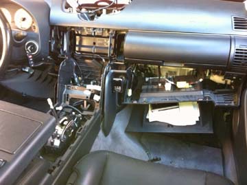

I own a 2003 G35 Coupe and I also had problems with my air conditioner and radio as others have described. I took my car to John Huang at XW Electric Co. in El Monte California. He charged me $200 and completed the repair in approximately 45 minutes. He can be reached at (626) 757-0465, 3608 Arden Dr. Suite J, El Monte, CA.
Attached Thumbnails a/c wont turn off and radio not working.-teardown.jpg
