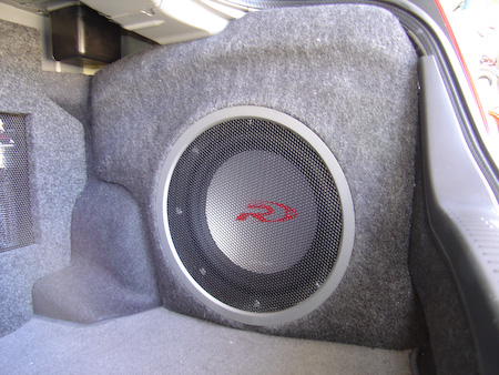

I've had this EXACT setup in my sedan with an Alpine type-r 12" woofer and it KICKED. I had about 600-900 watts going to it (DVC 4ohm setup = 2ohm total). The 4080 box is second to none.
I've done some fiberglass and this thing is TOP NOTCH all the way. Ingenius fit, perfect match, and quality.
Attached Thumbnails Does anyone have a 12" Alpine type R on a 4080 box?-sheltercove-1-2.jpg
