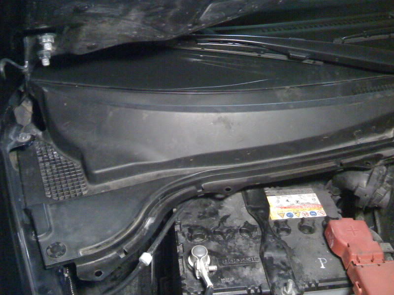

Take the battery cover off
Attachment 236058

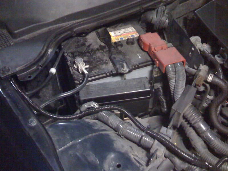

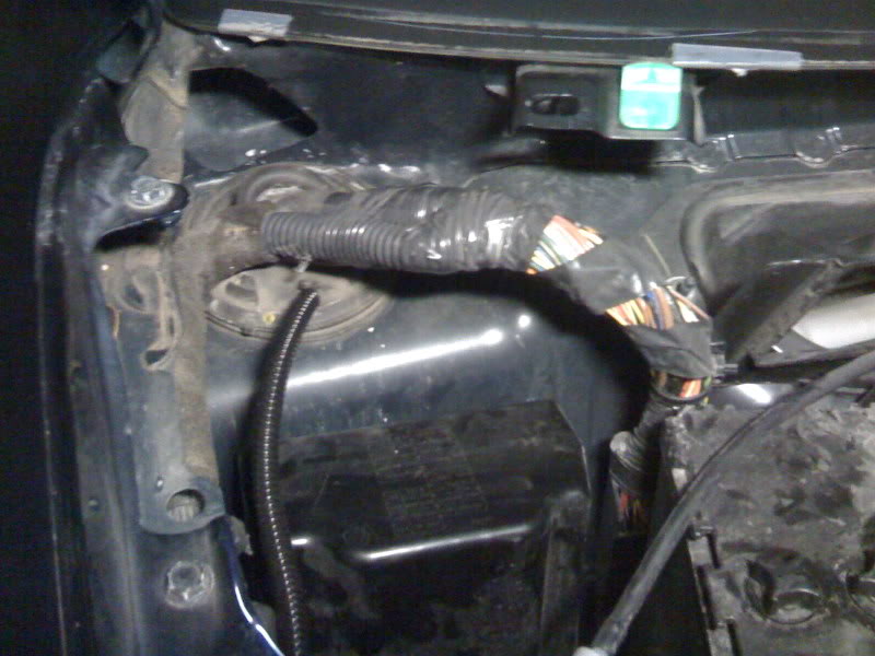

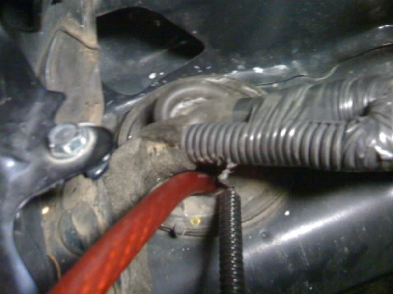

This gromet with the mass of wires going in it, that's where you are going to feed your power wire and any other wires you may need to run in the future. You can already see the hood pin/tach/siren wires coming out for my remote start/alarm.
Attachment 236062
Make an "X" in the rubber gromet with your knife, and feed the power wire in about 2ft.
Attachment 236063

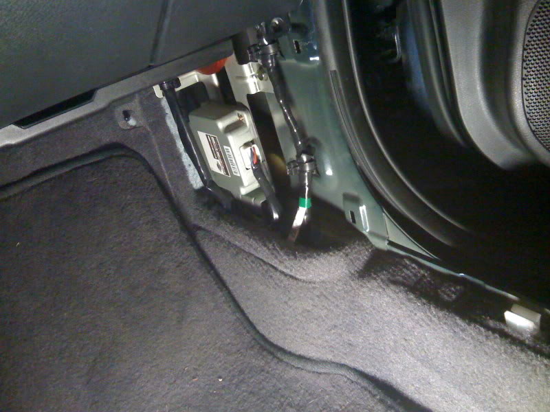

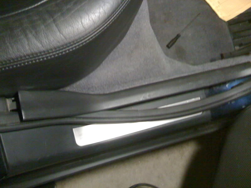

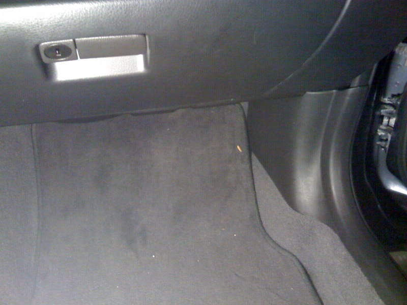

Open the front passenger door and remove the lower trim that runs along the door sill and then the kick panel
Attachment 236064
Attachment 236065
Attachment 236066
Stick your head in the foor well and look up towards the gromet. There is your power wire.
Attachment 236067

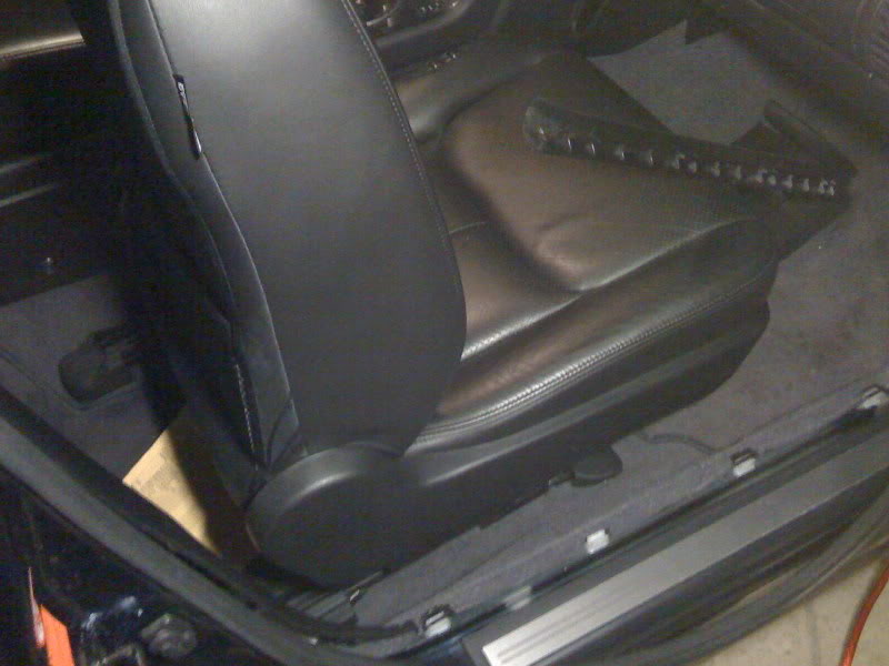

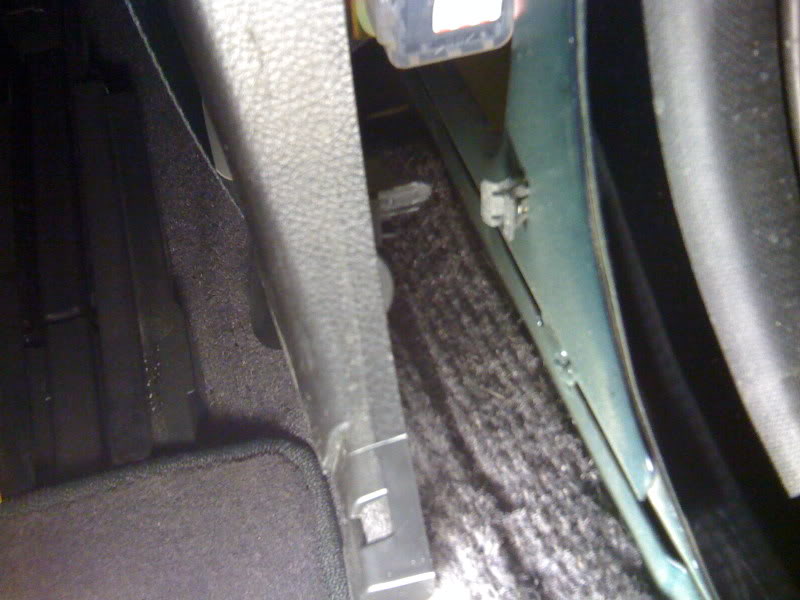

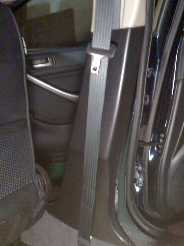

Once all your wire has been pulled, slide the passenger seat all the way forward and tilted.
Attachment 236068

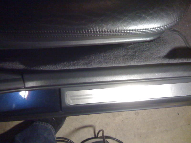

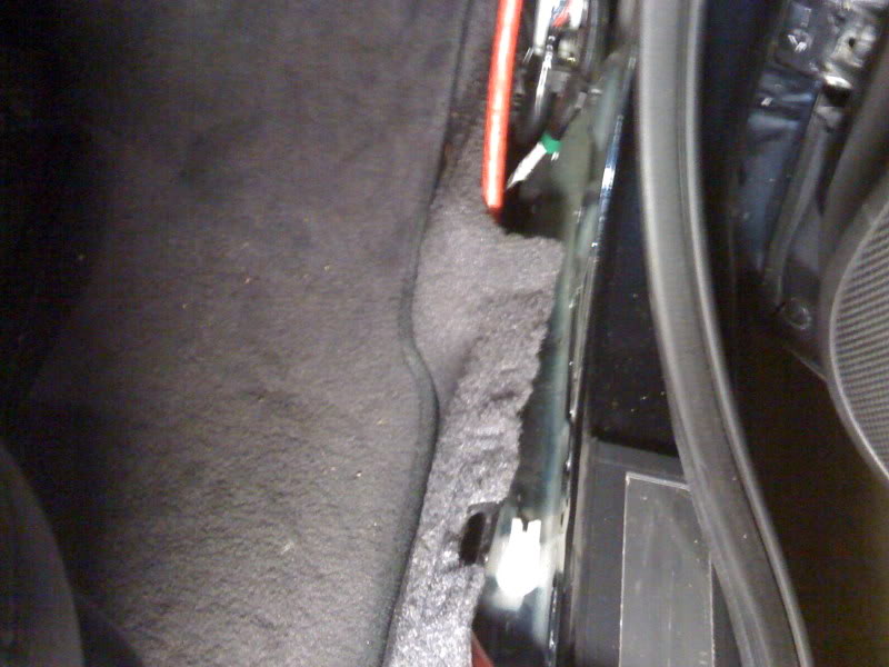

Open rear passenger door and pull up the lower trim along the door sill
Attachment 236069

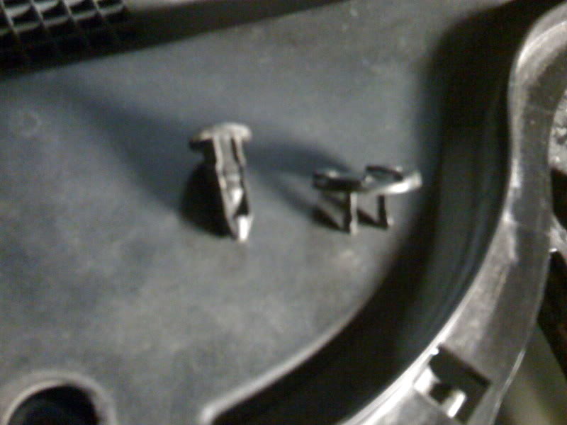

At the bottom of this panel are two clips, one per side. Pull each side straight back towards the other side of the car and the bottom should pop loose.
Attachment 236070
Attachment 236071
Go back up front and start tucking the wire all the way to the back seat. Carpet is attached to the door sill by plactic loops that go over white clips which is what holds the plastic trim to the car.
Attachment 236072

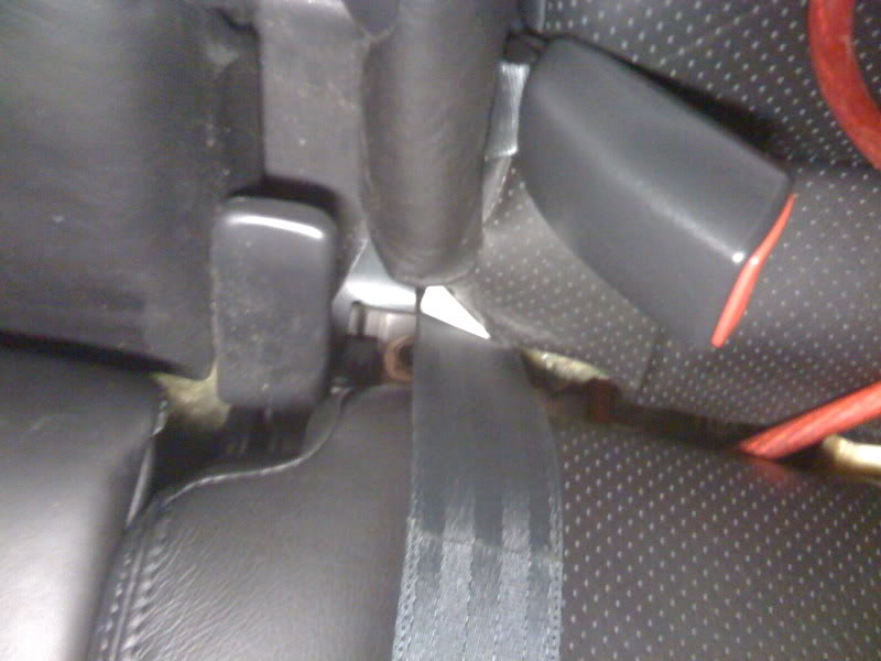

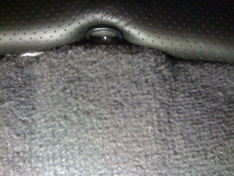

Once you get the wire to the back, take a look at where the bottom of the rear seat meets the carpet. You will see black plastic hoops. To get the rear seat up, pull the loop towards the front of the car and pull up on the seat. Don't try pulling the hoop up with the seat as it's attached to the car.
Attachment 236073
With both sides loose, pull the seat towards the front of the car to give you some space to feed the wire up with your hand. The seat doesn't have to come all the way off, you just need some space for your hand. The back of the back seat(the part that reclines, I had no idea my seats did that and was so amazed
) has insulation behind it. Make sure when you feed the wire, to pull the insulation up as you pull on the upper back part of the back seat as you feed the wire up towards the trunk. If not, the wire will be between the seat and insulation and you will not be be able to see the wire or pull it.

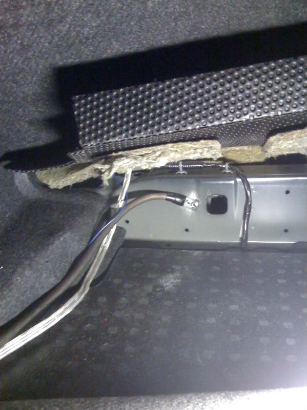

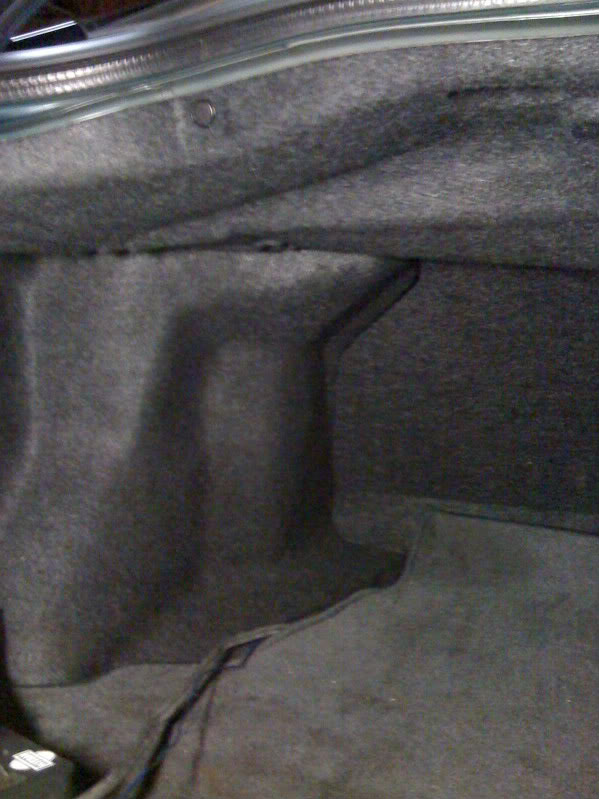

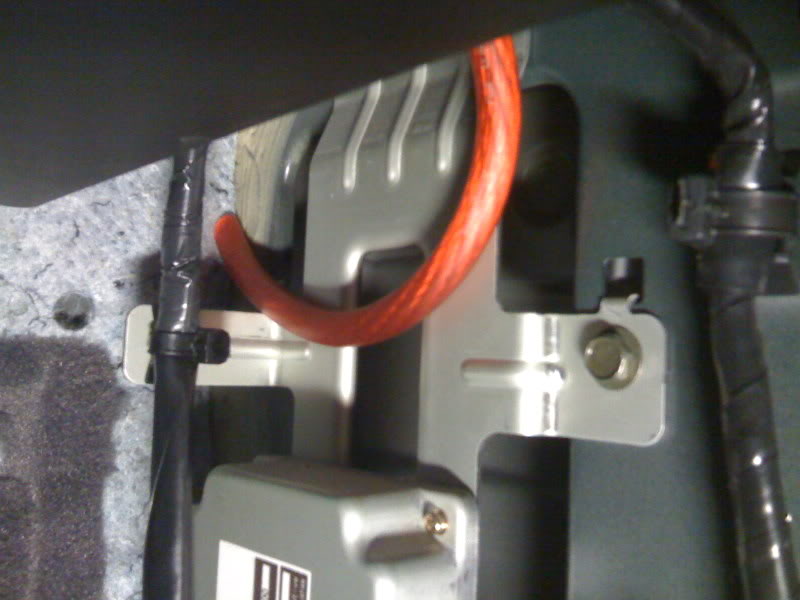

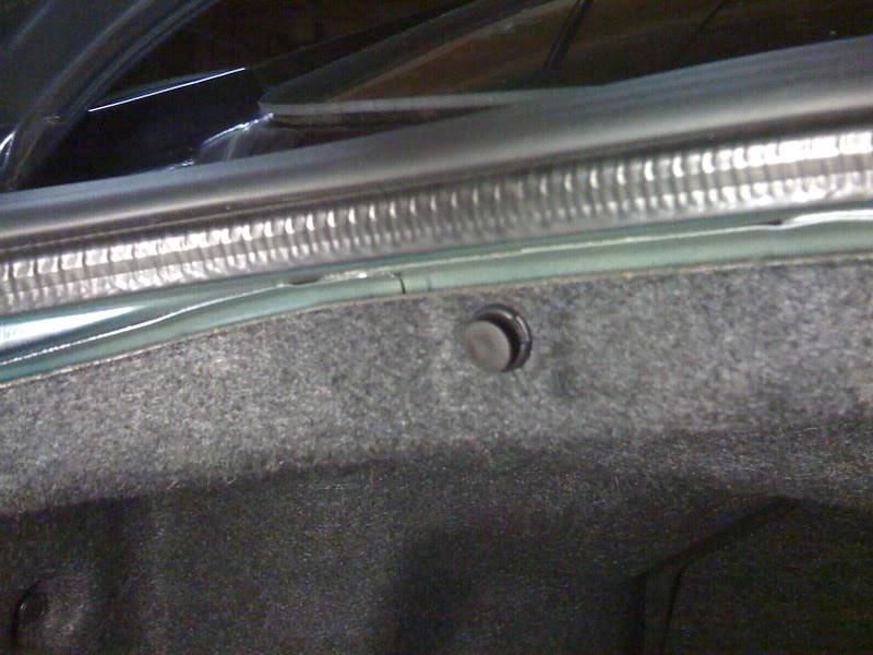

Now that the wire has been fed up towards the trunk, crawl in the trunk and pull back the bottom carpet, and then pull up on the back panel.
Attachment 236075
Once that's done, you should be able to see the wire
Attachment 236076
Now your power wire is in the trunk

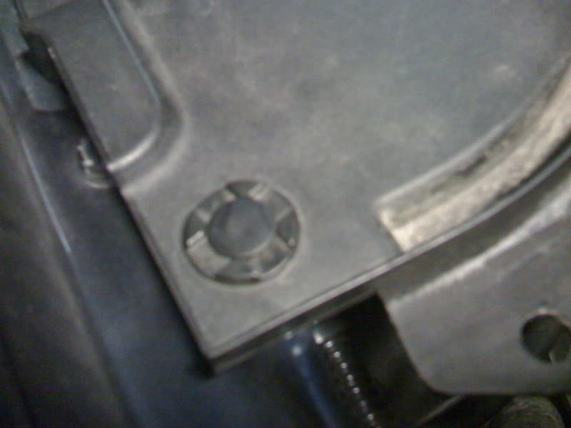

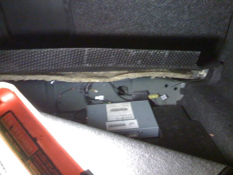

Now to install the line out converter (LOC). You have to pull down the top plastic trunk panel in order to expose the factory sub and amp. Pop out the little black buttons the same way you did the ones under the hood. There are about 6 total. Once they are all out, the panel should flop down like a door because it is attached at the back.
Attachment 236077

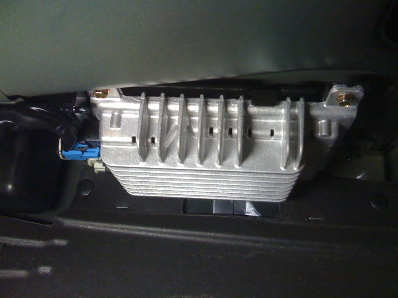

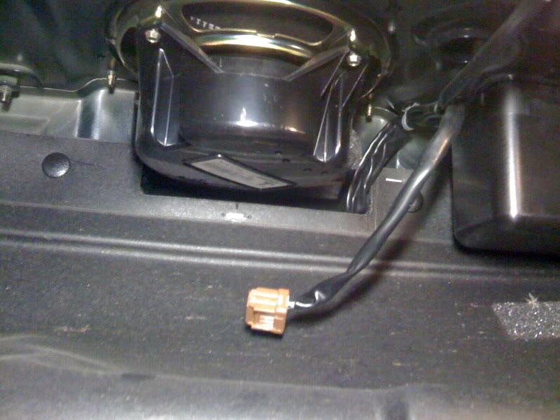

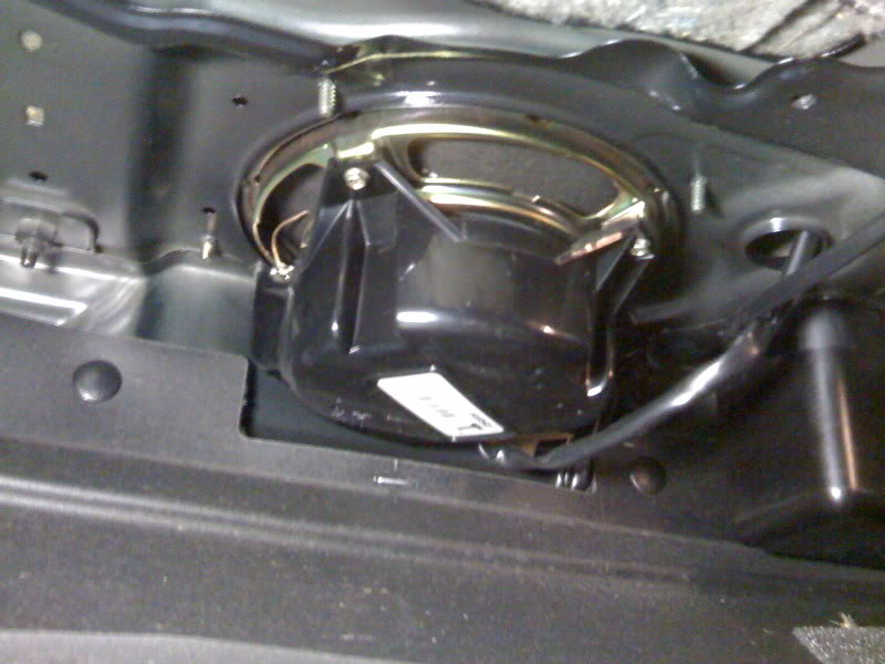

After you drop the panel, you will be able to see the sub
Attachment 236078
.....and the amp
Attachment 236079
Unplug the brown plug attached to the sub, pull the black sheath covering the wires, you should see a black wire and a white wire
Attachment 236080

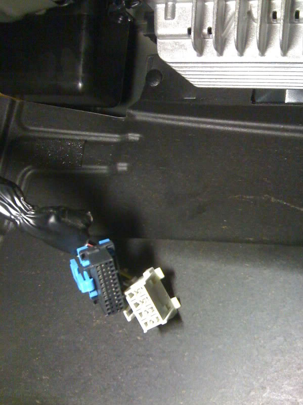

Move over to the amp now and unplug the two plugs on the left side of the amp. You will only need to get to the black plug but it's alot easier to work if both are unplugged
Attachment 236083
Pull the black sheath back and look for the green wire with the white stripe. That's the amp turn on wire. Take the blue wire that came with the amp kit and connect it to that wire. This is what is going to be turning your aftermarket amp on. Now plug everything back into the amp.
Attachment 236073
