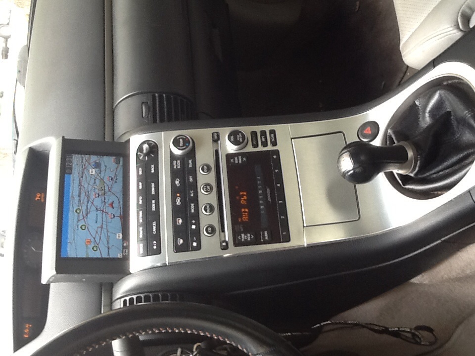

I have a 2007 coupe with navigation and bluetooth. However it doesn't have the SAT radio. I'm looking for something that will play/charge both iPhone and android. Will the GROM-USB2-NIS02 be the correct one to buy? Would I also have to buy the GROM USB Bluetooth Aux Adapter as well? i attached a picture of my radio if it helps.

If you're trying to do bluetooth, get the bluetooth adapter, otherwise, that'll do all you want.
