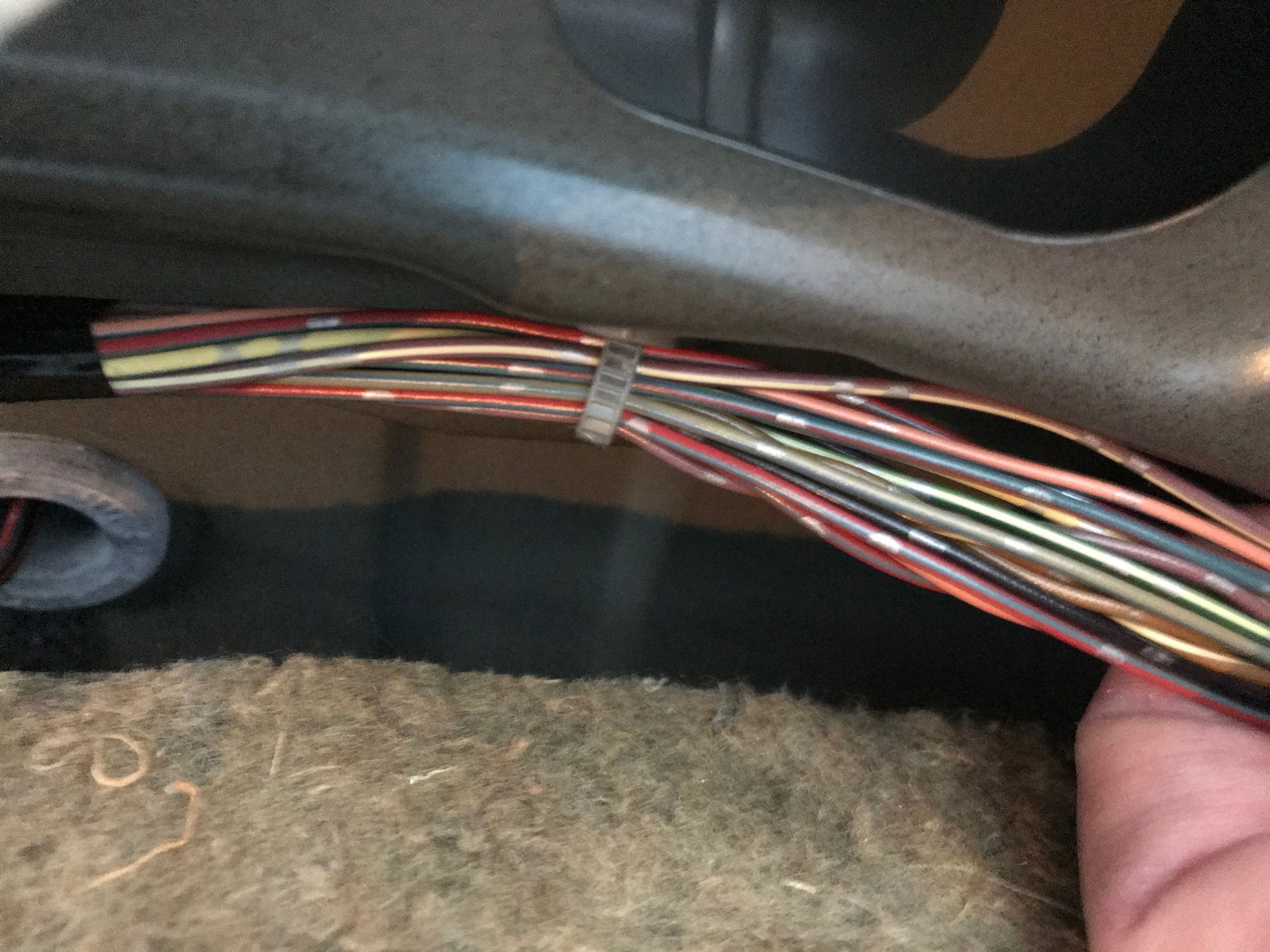

For anyone's reference and if still needed by OP, I think the orange wire in that loom is your backup light wire. Easy to confirm, just pop the panel off the trunk lid like changing the reverse tail light bulb and see what color the wire is there. This was the case for my 04 sedan.

Hey... for me it is the purple one. I took the meter to it and works like a charm. The purple throws about 10.7V when in reverse. I have a coupe. For the sedans it is orange from what I have read and as you said as well.
By the way, for everyone these wires run up along the back of the trunk. Use a tap connector and you are done in 3 seconds. I see people ripping apart the tops of trunks, etc. Craziness. Just tap in as this runs up against the back wall of the trunk between the tail lights. Another note, for me and I assume this is the way head units are going to be in the future... I tapped into the purple and believe I can pull up the cam anytime I want on the touch screen. I have the Pioneer 4500NEX. I will know for sure later this week as I am yet to tackle installing the head unit but I believe this is the way the head unit works. When going in reverse the cam comes up but any other time I want to view it, the option is on the touch screen.

Good to note for everyone's reference. My sedan was the orange wire for the reverse light and your coupe was purple.
My comment about tracing the wire back to the reverse light socket, it is easy to access like you are changing the bulb and it gives you a double check when you can visually verify you are tapping the same wire. It really took very little disassembly to install my Garmin GPS backup camera.
And T taps are a must! It takes a red one for 18-22 ga wire size for other's reference.
