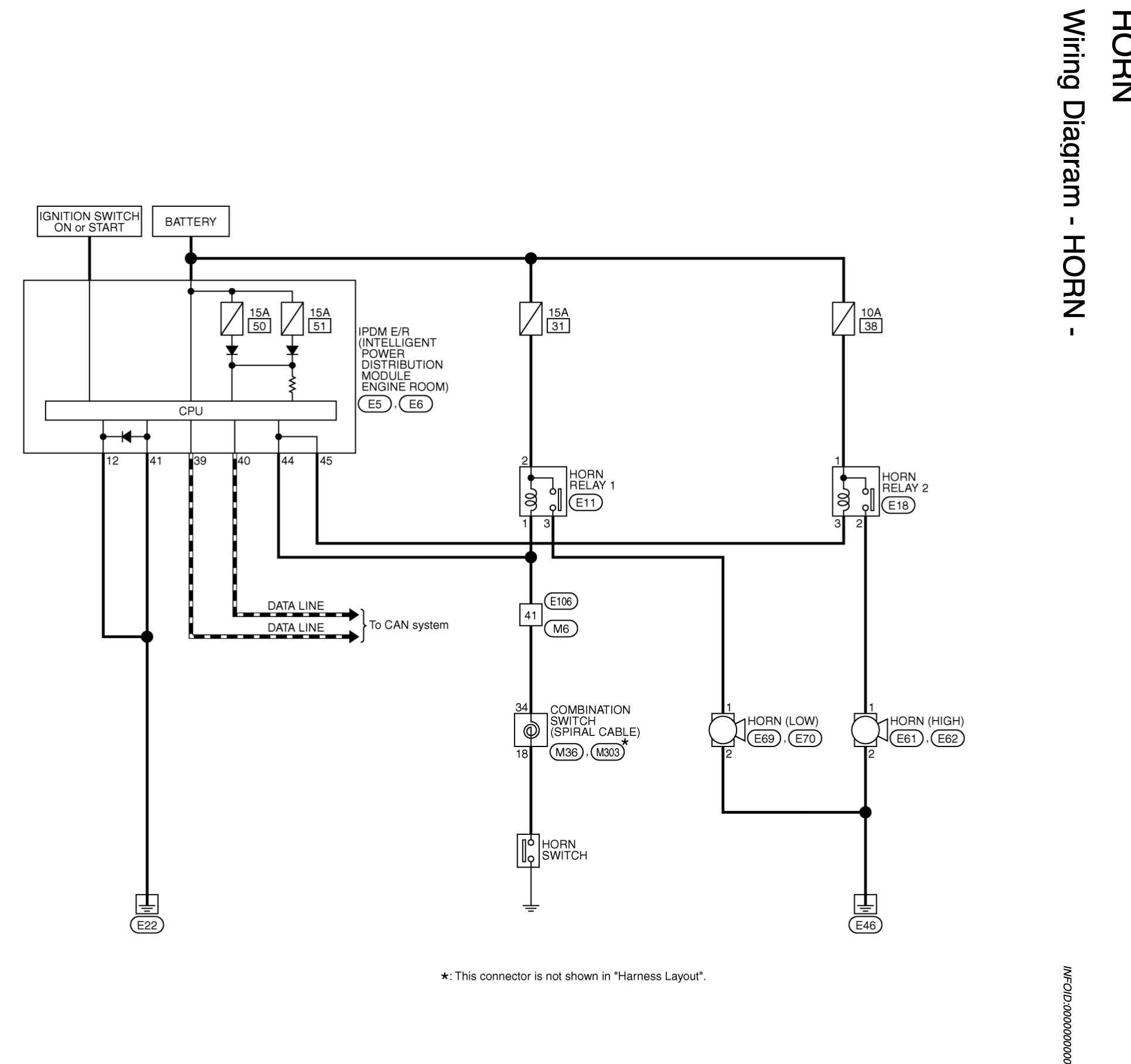

Hi, my 2007 g35 sedans horn won’t work and I’ve traced it down to either the clock spring or wiring from clock spring to the horn relay. I have no other electrical issues and all of my other steering wheel buttons work so I don’t think that it is the clockspring. Does anyone know what the wire color is from the clockspring to the horn relay and how do I find the break? I would really appreciate any help.

Interestingly, it seems you have two horn relays and two fuses #31 & #38. Check those first! Your horn FSM is here:
https://www.nicoclub.com/service-man...2007%2Fhrn.pdf
Below the window, "click here to download a copy".
It looks like that wire from the coil to relay 1 starts as green, then passes through a GIANT wire-to-wire connector (pin-41) and is light green beyond that.
Meanwhile, here's a pic of the diagram.

oh I see. Would you know the location of the second relay? I know one is in the battery bay in the relay box but where would the other one be?

The other book you might want is the "Power & Ground" FSM:
https://www.nicoclub.com/service-man...F2007%2Fpg.pdf
same thing to download a copy.
In there we find that those relays plug into connectors E11 and E18 which are here:
hope that helps
