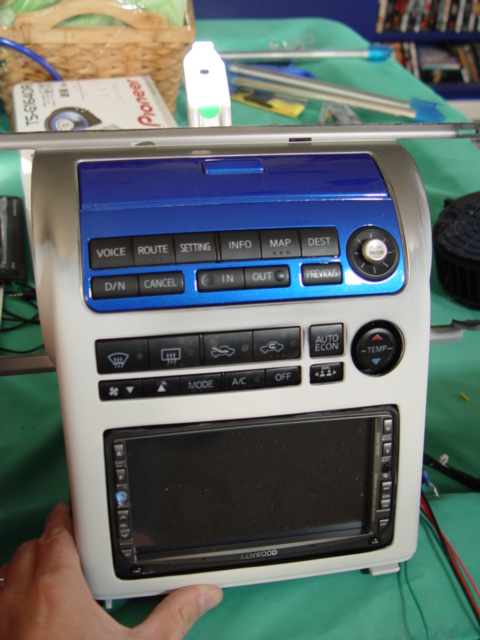

Shave? what do you have to shave? Mine fit fine, I didnt shave anything. As for the how to heres a good link.
http://www.my350z.com/forum/showthread.php?t=18919

Pic, sorry its not paint yet. It will be done today

Nice, I was thinking of getting that same exact radio. So the install is the same as non-nav units? No extra cutting/modifying or equipment needed? Does anyone have any more info about the nav voice not working with aftermarket radio?

That is the DDX7017, no? Is that basically the newer 7015, or is the 8017 the newer 7015? The 7015 is an excelon unit and the 7017 is not. I'm confused. I have a chance at a used 7015 and might just go that route. Can't see paying the extra for the 8017 for a few extra backgrounds/SSers and for 5.1 surround sound. Especailly when I'm just going to be running a set of components.
Are you getting the Kenwood Nav as well? Or integrating the factory?
