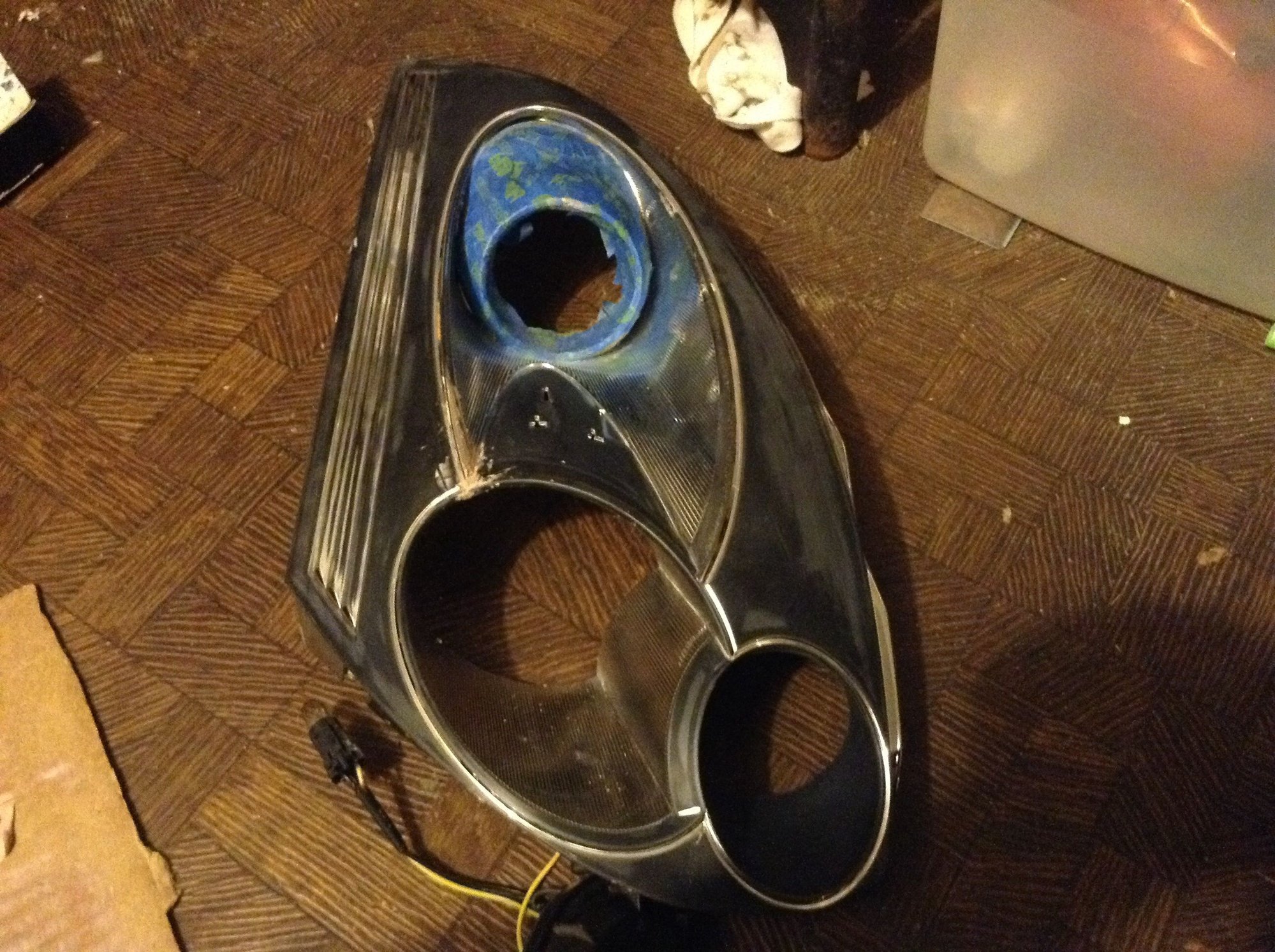

Shot, I've baked them, got'em broke down, swap one to a clear len, tape off what chrome pieces I want to stay chrome, sanded one chrome face part of the headlight

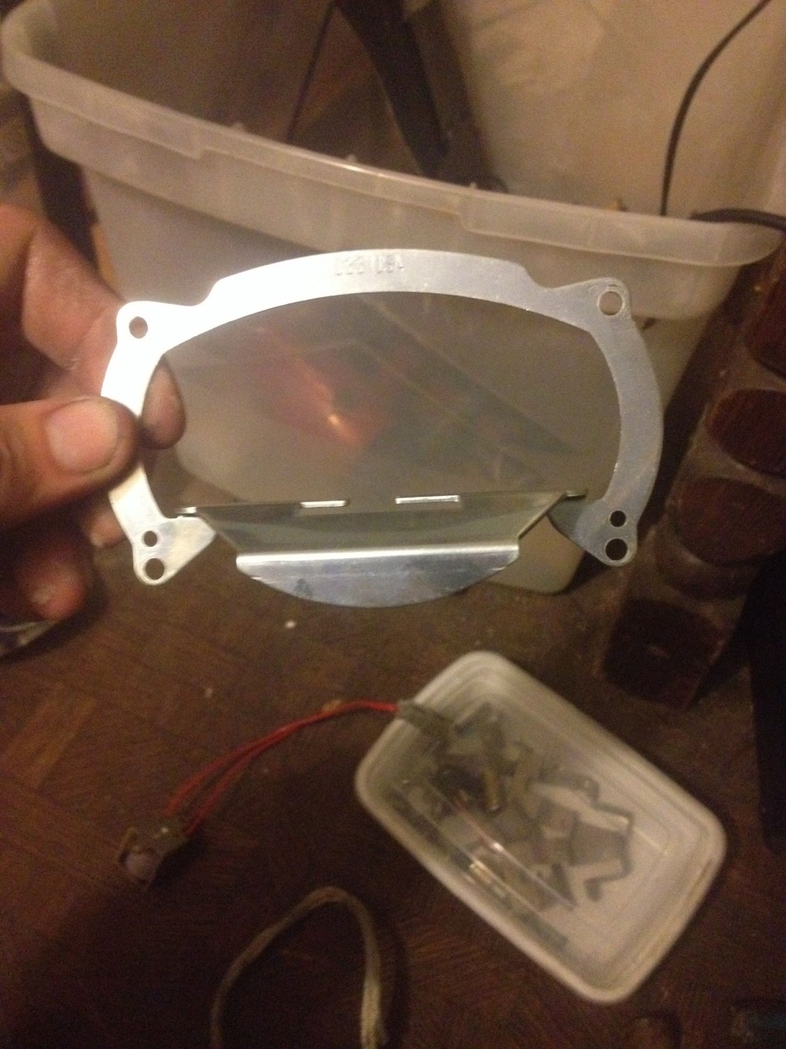

What are you confused about here? His choice of background is uber confusing (blinds warped in the lens).
He is showing what the modified mounting is like.
Okay so IvoryGt said there is no need to cut is

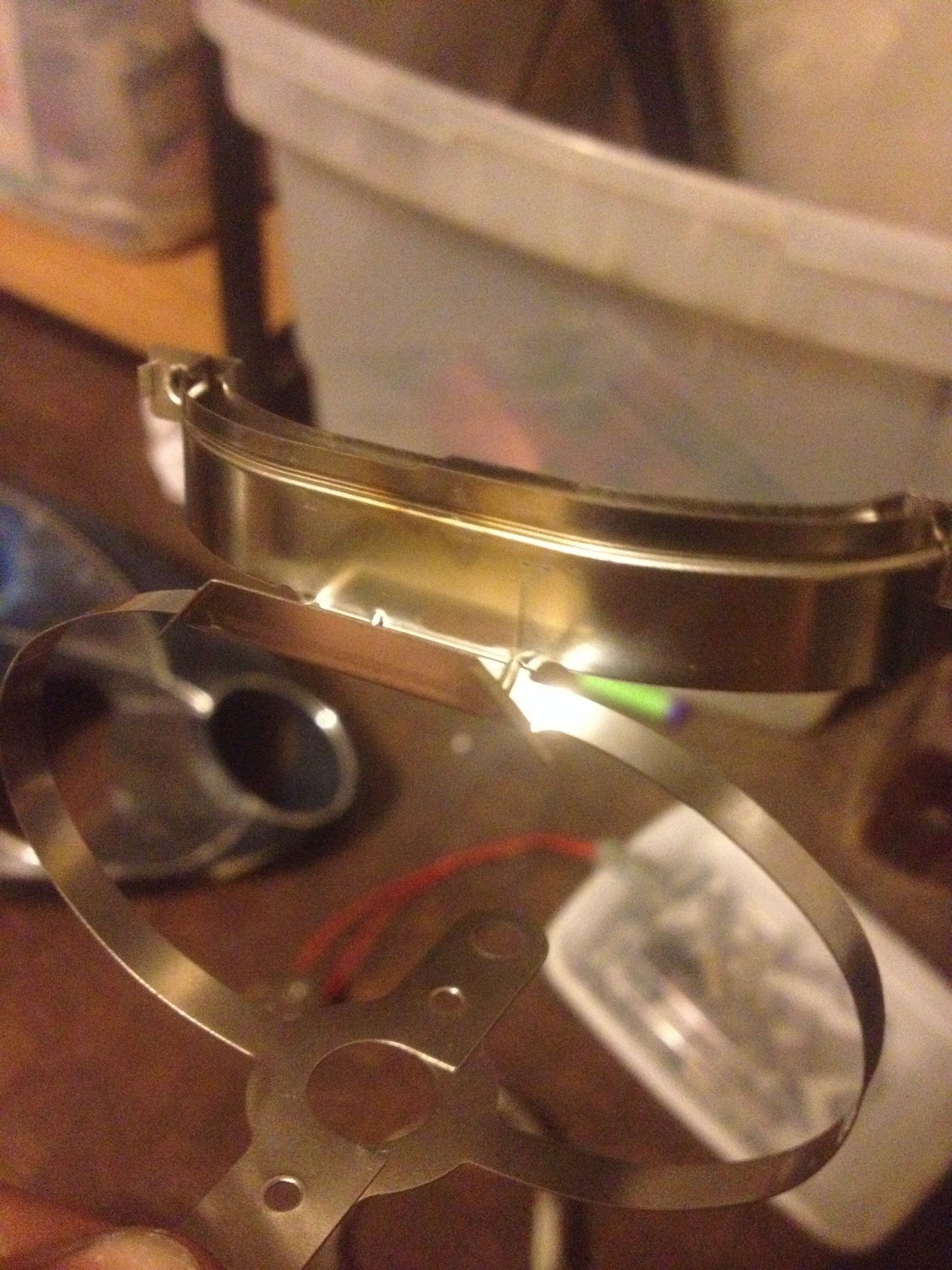

I got it lol
Is it this

sanded down

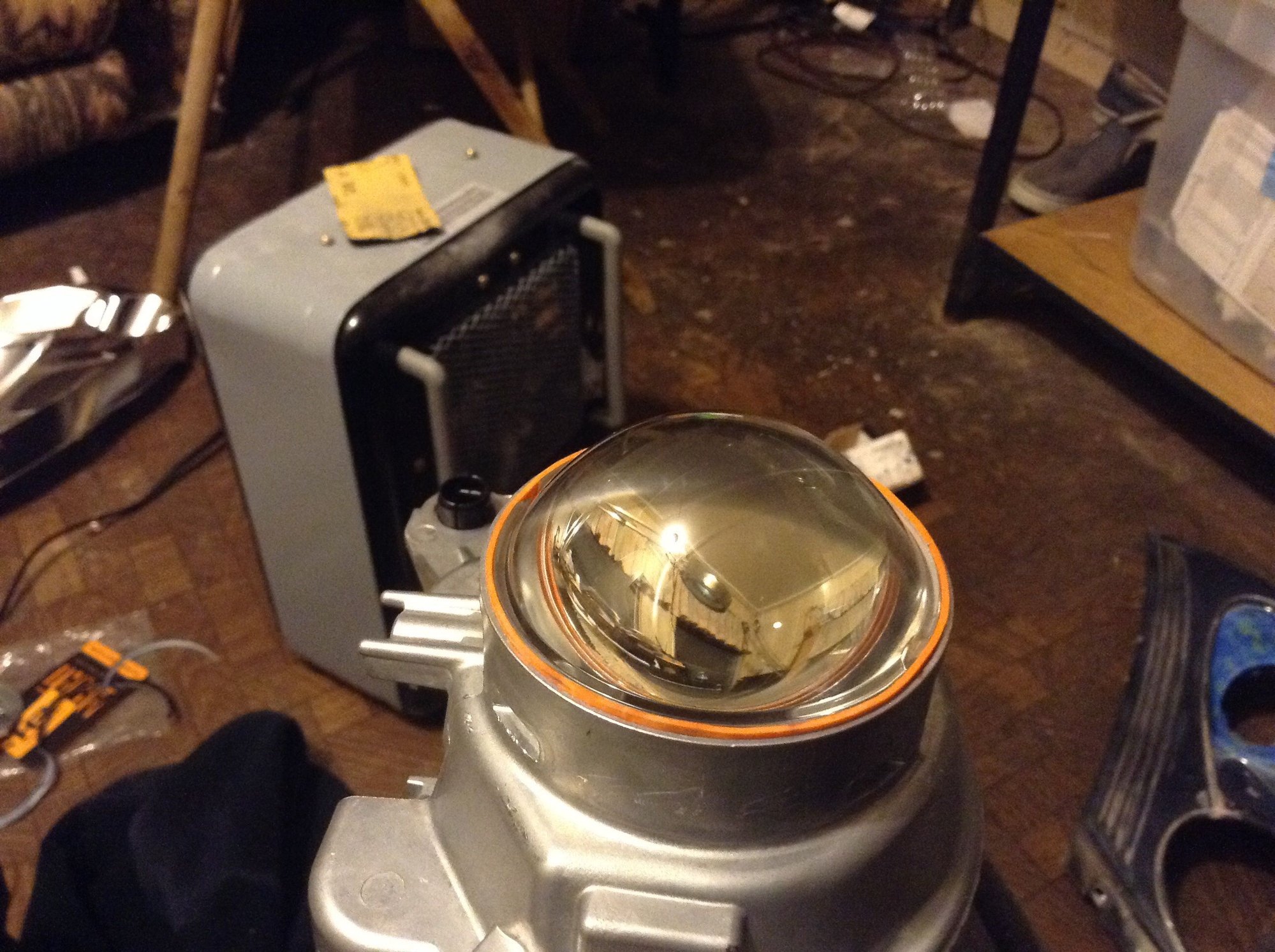

Very nice. Did you take pictures? It would be neat to see more updated pictures along with what temp setting and time for baking Hog. What clear lens did you go with?
Bake them at 200 degree for 10mins and I choose the tsx-r this being the first time.

please note that for some odd reason my TSX-r lense are about .01mm smaller then my stock lense. A rubber band work great to make up the different... And believe me it is NEEDED to keep the lense in place idgaf if punch all the lense keeper tabs in.

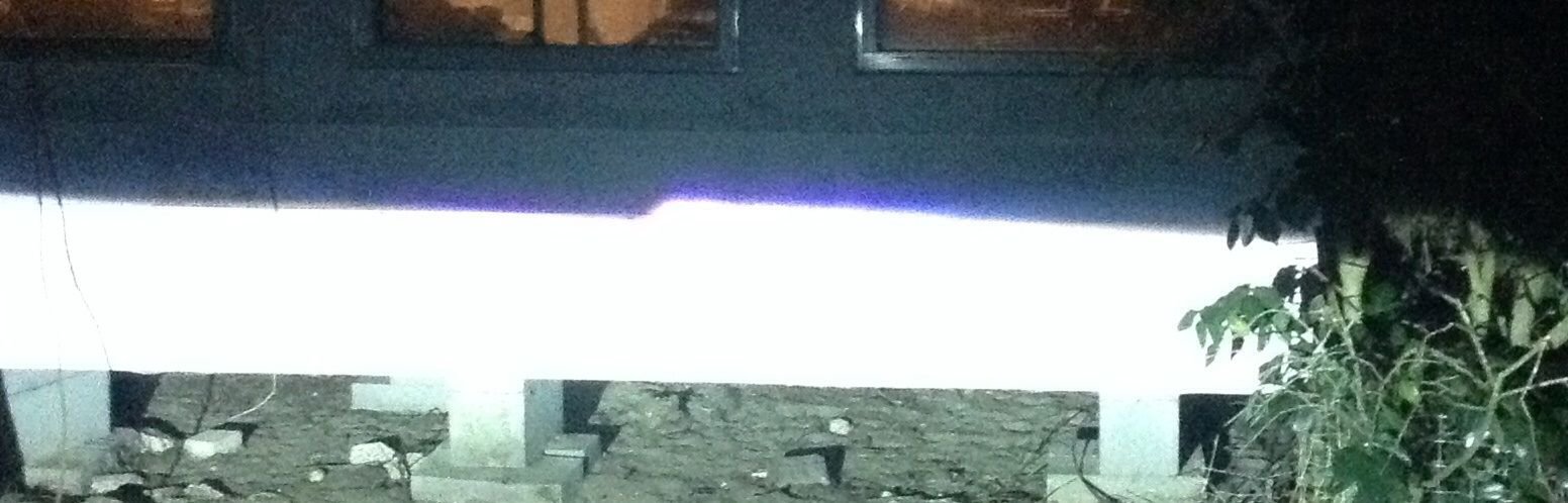

first one was a snap to get right. I had to use 3 spacers from TRS, in person you can see (top-button) purple, dark red, Orangeish, blue, and teal

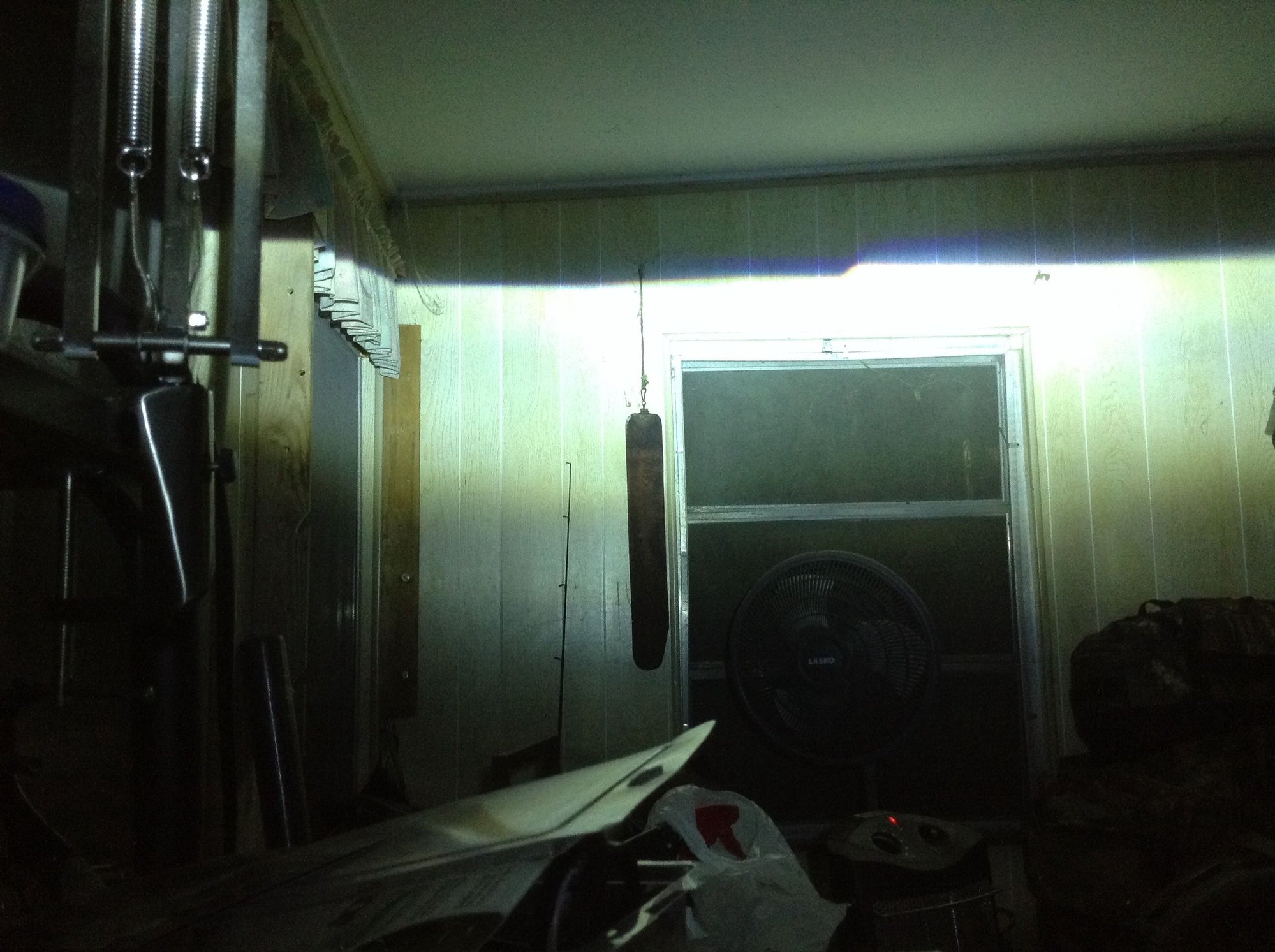

Inside shot
Second one needs more work. I took a picture of the second one from inside using 3 spacer as well but it was no where near the sharpness or the color of the first projection, so I cut my own spacer out bring it to 4 spacers total which cleaned it up nicely. But on the outside shot it was way,way off. It had no sharpness and way to much color compared to the first one.
