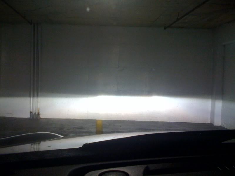

man...looks like i need to get some clear lenses... this is what my cutoff looks like...

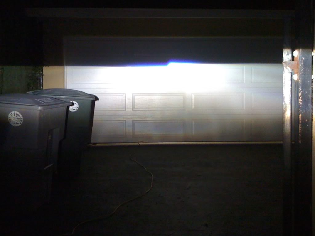

why do i have these flares in my cutoff?
i know they were replaced under warranty during that recall with the '06+ headlight recall.

yeah most likely thats is because of the oem lens, they have all those grooves in em that i would imagine are distorting that light. You can get them at retrofitsource.com theres where i got mine. They are $70

The reason why your cutoff "flairs" is because its actually rotationally off. This is the reason for the recall on the 06s. If you are going to change out the lens, make sure you adjust the rotation of the shield to line up with horizon.
